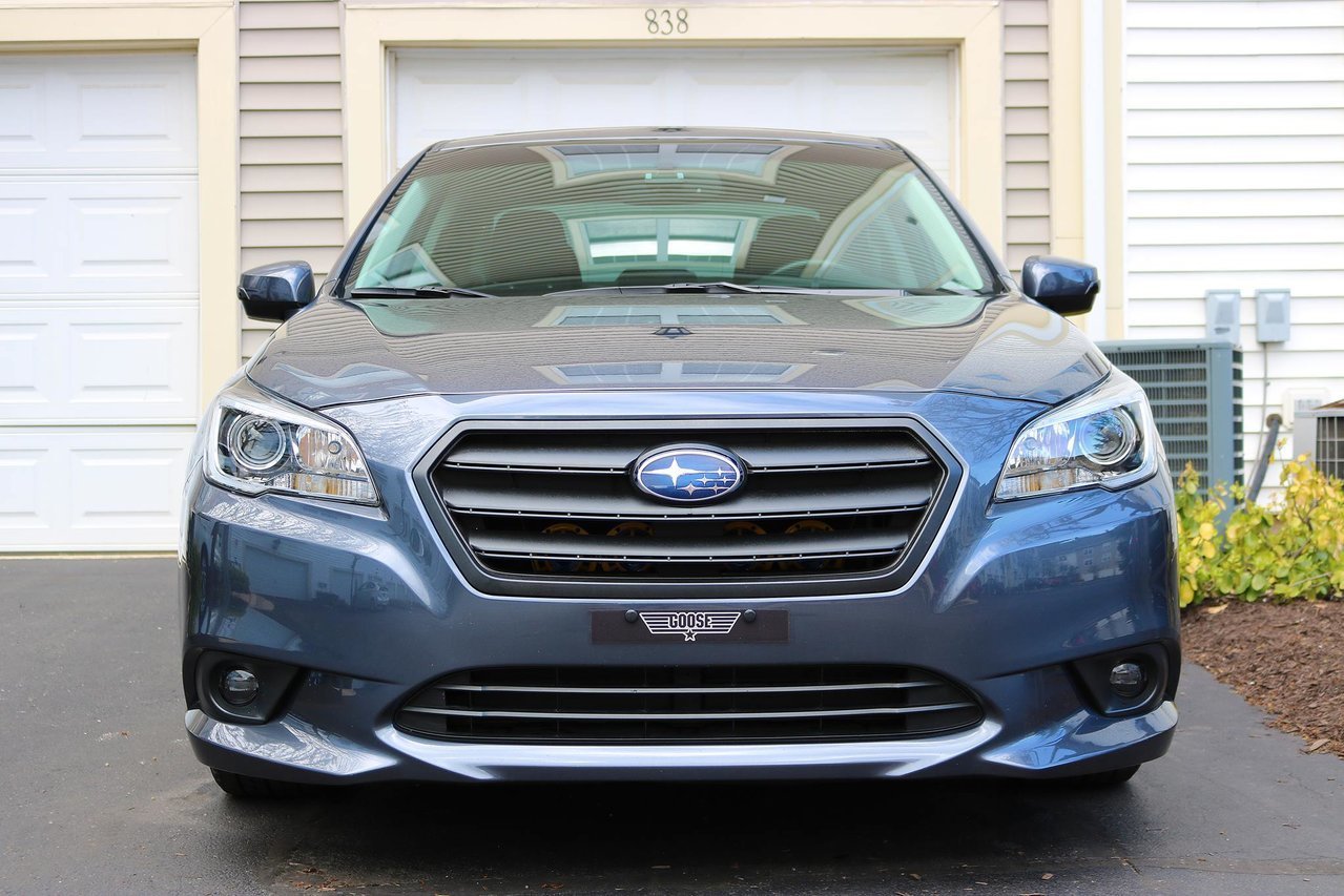

    It's so nice! I was stationed there for a couple years, and am keeping my car registered there for as long as I can. Even though I already have holes in my bumper, it's nice not having a plate.

    Correct! We’re moving to California soon so I’ll eventually have to come up with a solution for a front plate.
