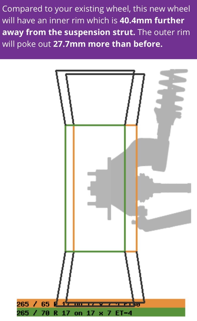

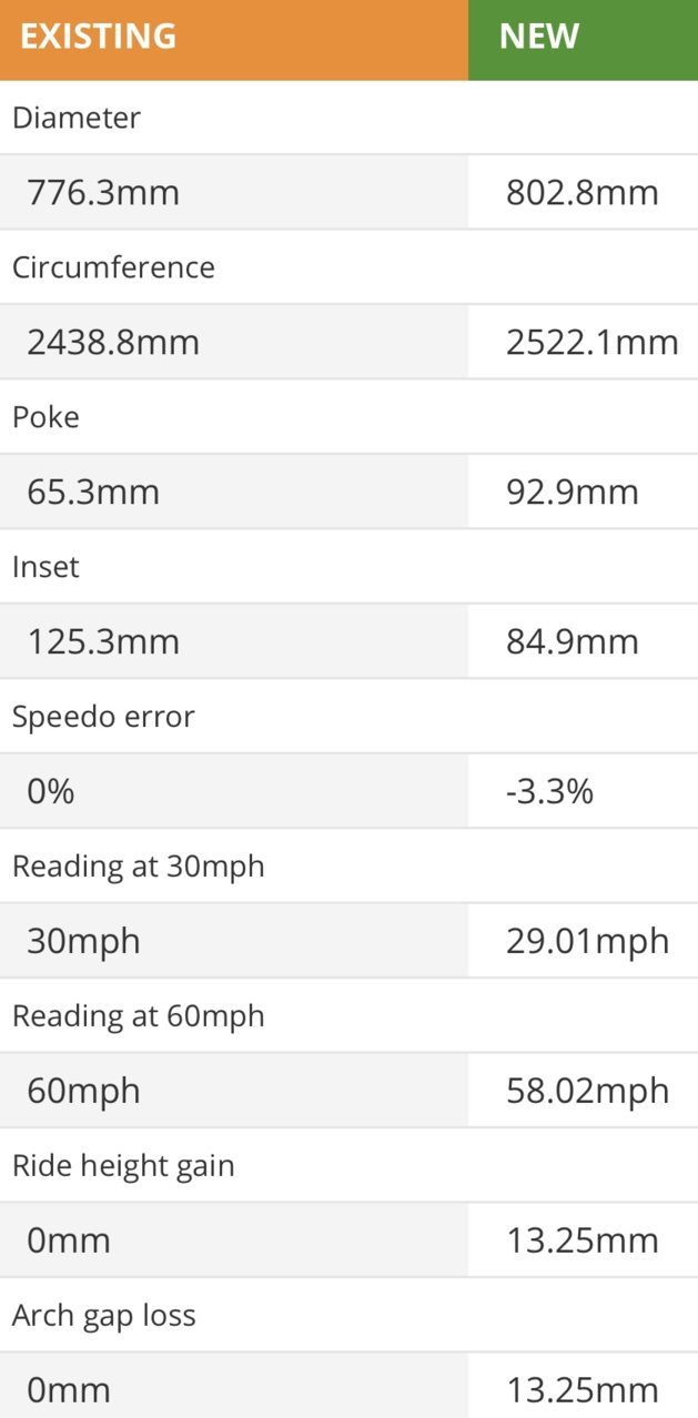

    Thanks for the info. I'm on the fence about replacing my Limited wheels and tires or just getting new tires for the 18" wheels. I don't need hardcore tires as 99% of my driving is on concrete commuting, so C-rated is the goal and the extra width isn't important to me. I was considering spacers if I keep the wheels, but still thinking about ideas. If you decide to sell the wheels, I'd like to be penciled in on the list of potential buyers. lol

    Nothing wrong with spacers but I personally prefer to get offset wheels so the spacers aren’t needed. I also like more rubber which is why I’m drawn to 16s or 17s but there’s nothing wrong with the Limited 18s, they are good looking wheels!

    would you consider going to a 275 so you get just a smidge more rubber if the new rim is pushing you outward?

    As of right now, I'm leaning towards 285 KO2s load range C. I've thought about going to 275s as well to avoid doing a CMC. I'm going to see how I feel once I get closer to doing the lift

    If you're getting the OME lift that you describe on the front page, then you'll be able to run 285s easy. I have a buddy who runs the full OME kit will stock OR wheels, and rubs slightly on the UCA in tight turns. I have the same setup, but use Spidertrax spacers on my OR wheels and I have zero rub while avoiding all other modifications to clear the plastic or having to do the CMC.
