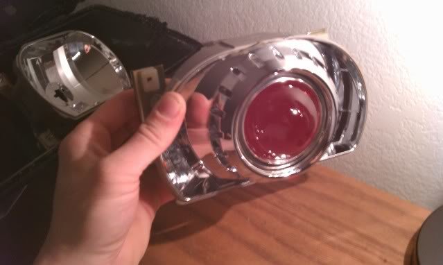

    I'm kind of confused as to what you're asking? I didn't change my headlights to just halos. I installed a retrofit into my stock housings. It shouldn't be hard to switch out the halos on your headlights for red halos. Just have to bake the headlights to separate the lenses and then remove the old halos. You'll just have to find out what size the original halos are.
    Keep in mind that red will be illegal to have on while driving. Also, that's not what the demon eyes mod is. The original demon eye mod is where you paint the cutoff shield behind the projector red like so.

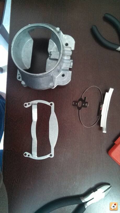

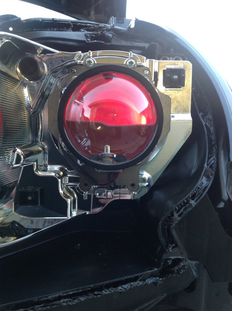

    The new take on the demon eye mod is where people insert a red LED behind the projector. Like so

    If you do paint for the demon eye, you paint those three pieces. But then again he has after market lights , so who knowsy9u9aruv_bf6f912a1f7cc4e397b1c739c43e0cdbef5484ec.jpg

    Yup, on mine you only paint two pieces. All equate to the same name pretty much, cutoff shield haha that's why I used that word.
