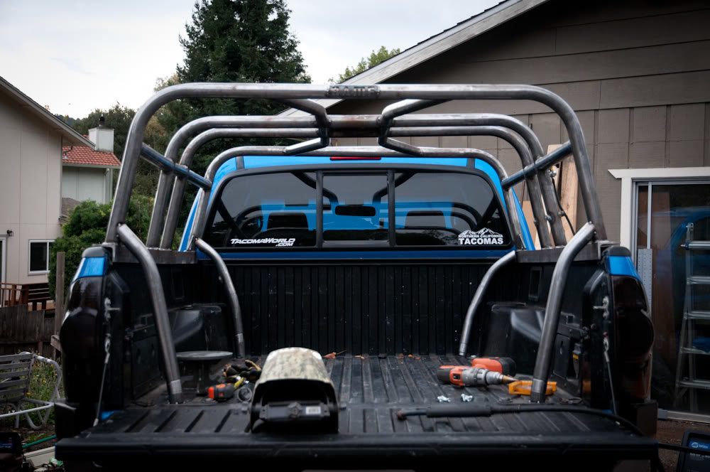

    If I ever have a bedrack (been strongly considering it lately,) I'd have it made so it attaches directly to the bed of the truck, not the rails. But instead of having permanent feet, I'd have it so the rack slid into feet that were bolted to the bed and then just locked in place with pins drilled through the feet. So I could still remove it if possible, but still have it removable.

    So like what Jerry did?
    Defeats the whole point of it :rolleyes:
    I'm not too worried about it bending. I've got the toolbox which will help with the support of the bed rails.
    It would be nice to have a support bar in the back. It would just get in the way too much though.

    Yeah! I knew I saw something like that before, just couldn't remember where or who did it. I'd want it similar to that for sure. Only downside is you do lose some space in the bed where the feet are.
    I really don't think the bed rails would spread apart if the racks legs were mostly vertical like this picture. Ones like Boxrocket makes would push the weight of the rack/RTT outwards on the bed rails rather than transferring it downward. No knock on his setup, just something I think may happen.
