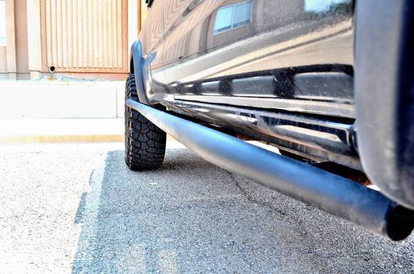

    Touched up my sliders and installed LEDs for the gauges, shifter, map lights, dome lights and license plate lights. I'll get a pic of the LEDs later tonight.
    Some slider shots
    Interior
    Exterior
    I have quite a bit of stuff in the toolbox haha
    The trail damage so far. I also have a few gouges in the driveshaft and a dent in the catalytic converter...
