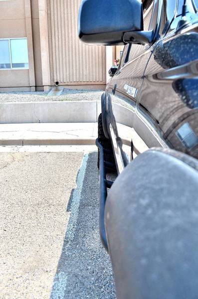

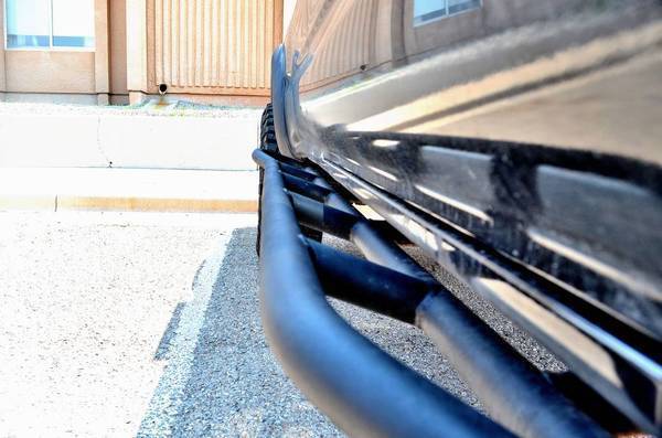

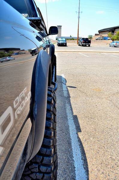

    Do you happen to have any pics of your sliders from the front or back showing how far the kick outs stick out?

    Here you go.
    You can cut the legs that mount the sliders to the frame as short as you want. This is as far as you can make them stick out unless you angle the horizontally instead of slightly angled.

    Thanks guys, i think i'll have my slider built slightly custom, adam (at 4x inno) said they could make my kick outs a inch bigger (more kicky outy ey) if i wanted.

    That's what I was thinking. Mine are mounted flat and I'm running 13.50s on 15x8 wheels with 3.75" BS instead of 12.50s and my kickouts still stick out nearly a tube width further than my tires. I guess maybe if he was planning to run wider than 13.50s or 15x12 wheels or something...but to each their own I guess.

    I agree with Ben. The kickouts are definitely wide enough and, in my opinion, wouldn't look as good or serve a better purpose by having a farther kickout.
    The angle also gives you more clearance as well as protects a little further up than if they were flat.
