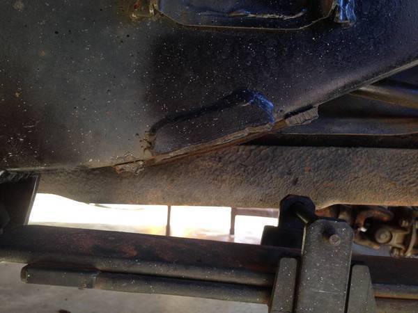

    You could always do like I did and cut the front spring hangers off all together :p
    Still need to do some grinding...
