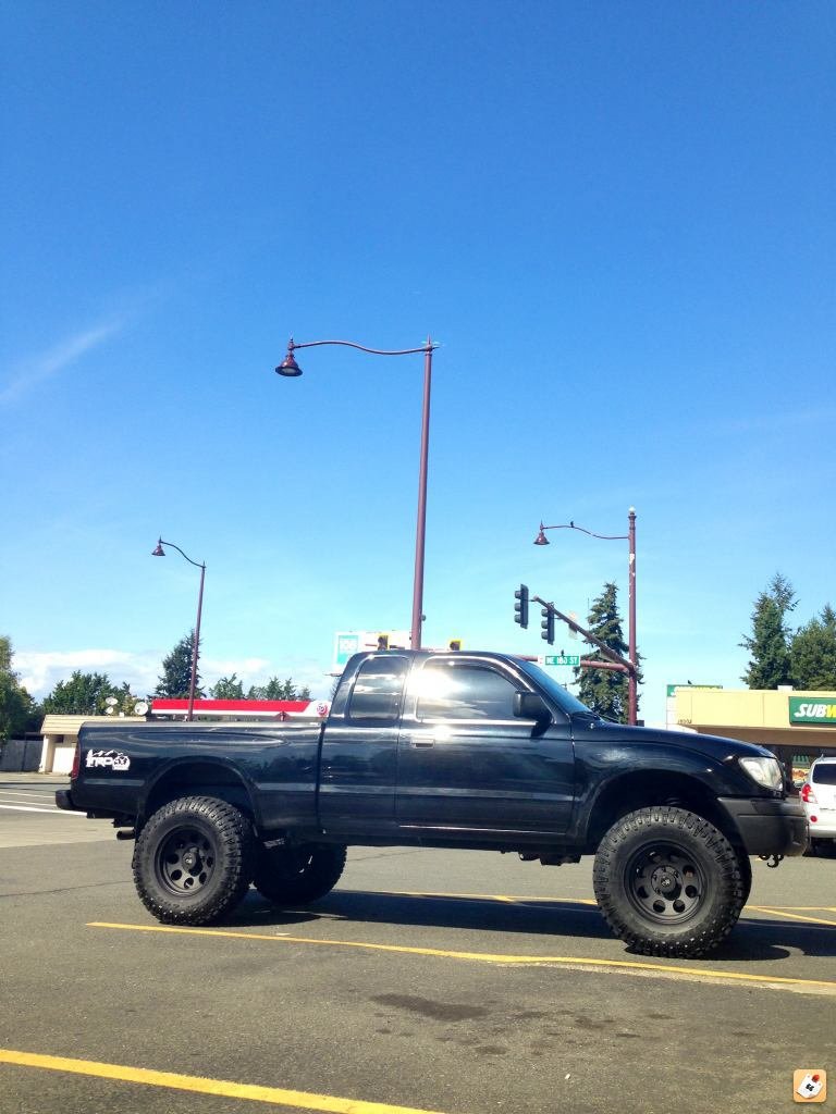

    and don't plan on any sagging with the expos... I loaded up 900lbs worth of junk when I went to the dump and didn't notice any droopage

    I think it'll look fine sitting about 3/4" higher than this :D
