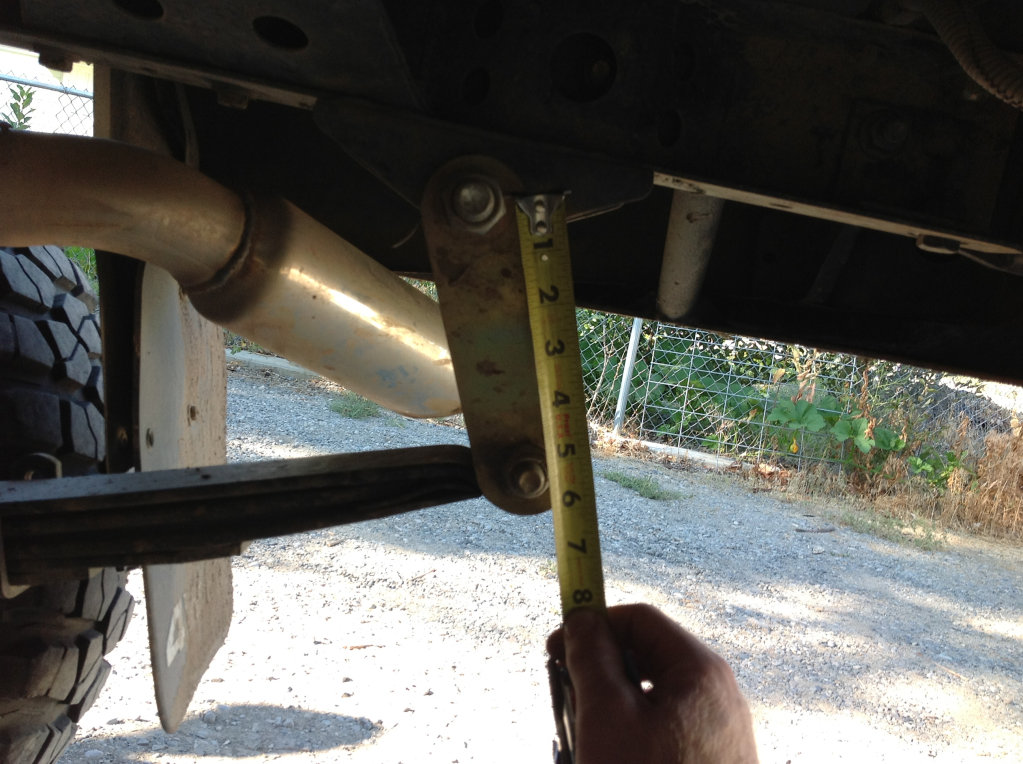

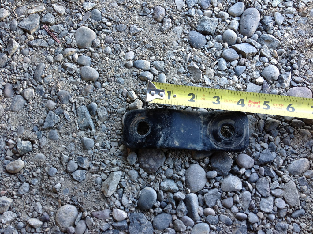

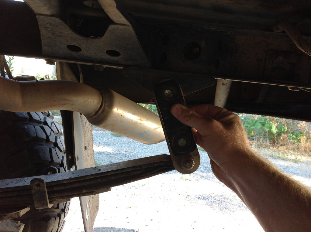

    Picked up my leaf springs, shackles, and brake line today.
    Carrying leaf springs up 3 stories is not fun! Haha
    Not sure what order the shackle setup goes, I just threw it together to see if it made sense haha

    Mickey Thompson Classic iii, Green LED interior floor lights, After market Kenwood touch screen radio, 20% window tint, Blacked out bumpers and grill, blacked out tail lights, Pioneer door speakers, bed lined toolbox, LED tailgate light bar w/ reverse lights, Bilstein 5100 all 4 corners and top setting up front, Trd Coils, New 1.5" lift leaf pack and shackles, White gages with blue needles. 32x11.5 Cooper STTs, 1.25" Spidertrax spacers
    that shackle looks really small :eek:

    2018 Tacoma TRD Off Road 4x4
    Nice haha
    Trust me they're not! They're 1.5" longer than the stock shackles. Haha
    Got the combination of the shackles figured out thanks to Cody (Konaborne) and Monte (Blackdawg).

    they are 3/4'' longer? should be longer then that..stock is 3.5'' eye to eye about and if those are 1.5'' lift shackles..should be 3'' longer...or are the just 1.5'' longer thus 3/4'' lift? You can see how mine are 2'' longer eye to eye thus..1'' lift shackles.
