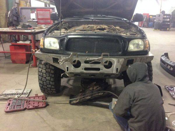

    Getting my bumper welded. Word of advice, if you can afford it and wait, don't buy a DIY bumper kit haha

    I just became a certified welder and on my way to get my welding engineering degree and i make a lot of offroad parts so it is only reasonable for me to make armor for my own truck. I need to make two one for my truck and one for my third gen 4 runner and i have a couple people that want them so i thought why not make them up.

    Money isn't the problem. I'll still save some in the end. It's the stress of worrying about it not fitting haha

    make sure you leave gap between the grill and bumper!

    Currently welding all of it completely. After that we just have to work on the tubes. I plan on cleaning the welds tomorrow. Don't know when I'll get to paint it.

    Looks good! What issues are you having?

    Stitch weld it. That metal get hot and your heat effective zone gets big quick.

    can only stitch weld parts of it. You need solid seams for the main outer part for it to look like one piece of metal.

    All finished up...
    One of the guys walking by was saying how it didn't need to be welded completely on the inside. That only the outside needed to be welded completely. Made sure they welded everything anyways.
