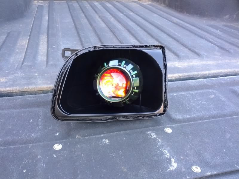

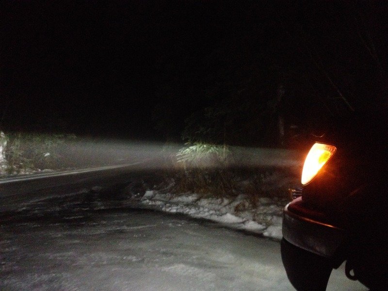

    Just some retrofit porn while you wait. It was really foggy here today :D

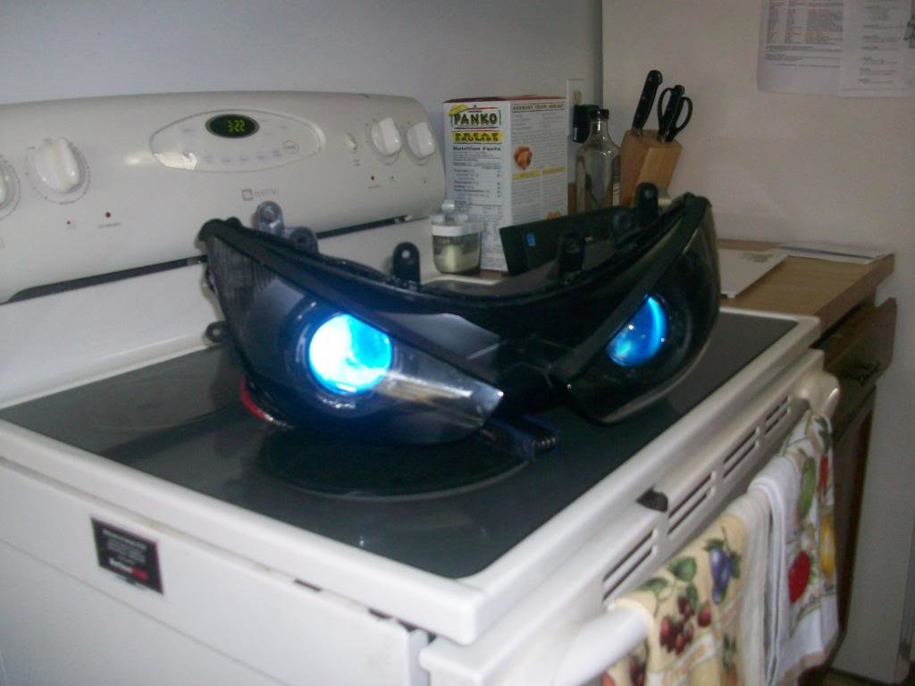

    I used the oven to open them and a heat gun to reseal them. A heat gun will work for both though. Much less work involved with that. All the little pieces on the housings are a pain in the ass to take off.

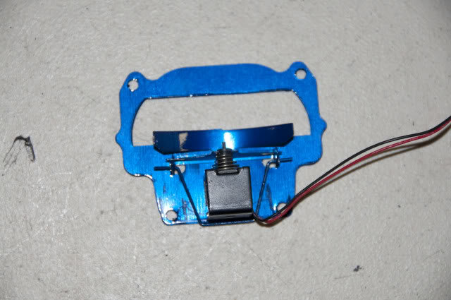

    Decided I'm going to paint my cutoff shield black as well. Gives the projector a smoked look to it as well as produces more of a black cutoff line than the rainbow looking one it normally gives off.

    It should work great. Just don't melt the housing haha. My heat gun goes to 1000* :eek:

    Yeah, as far as I know I just have to take out 4 screws. 2 that attach the shield to the lens and the 2 that attach the solenoid to the shield. Shouldn't be too hard. Don't care for the color, I like it to be a sharp cutoff haha

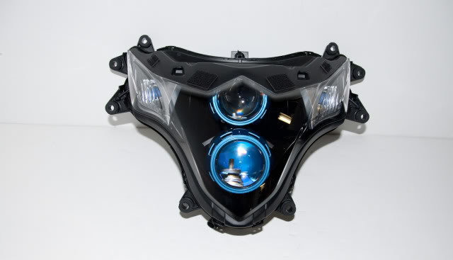

    This would look awesome on a speedway blue Tacoma!

    This shield that creates the cutoff for the beam.
