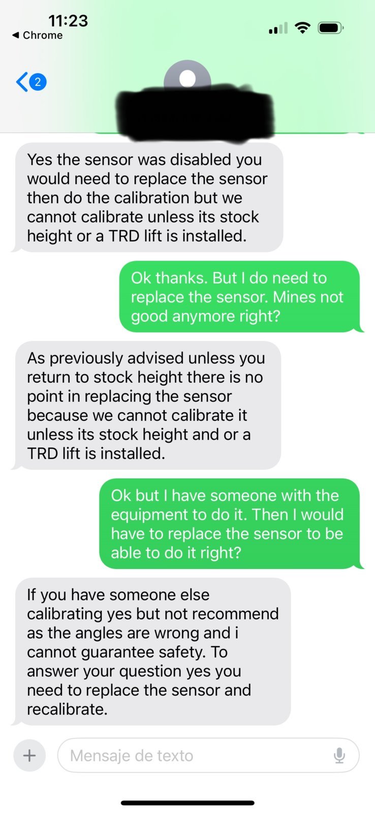

    Hi fellas. Hope you’re doing fine. I’m certainly not great. I bought a 2020 Tacoma TRD SPORT 4x4 with a Salvage Certificate that had an accident in the suspension. I fixed everything and everything looked good the only thing I had left to do was find the way to get the PCS(off) light of the Dashboard. After doing some research (every thread on Tacoma World and Reddit) and try some things out, I finally decided it was time to take it to the dealership. They said they couldn’t do it bc the truck had an aftermarket lift. If it would be stock, or a lift sold by them, then they can do it. But not on mine. They said the light was on because last owner had to get the windshield replaced and, as the radar camera is there, system was temporarily disabled but never enabled again. So I started calling every shop that lift trucks and no one could do it but one. He has every tool needed to calibrate ADAS. They tried to do it every way they could but they couldn’t get it done. They said they couldn’t even access the system. I would just let this go and see the light in the dashboard. But since I need to get the Salvage Inspection in order to get the title, I can’t just leave it like that. Any suggestion instead of going back to stock? Seems to be my only option at this point. Thank you very much and I appreciate any kind of help.
    UPDATE: Got new sensor and I haven’t got it calibrated yet but my scanner is now showing an error code. With the other one which was disabled it didn’t even showed an error code so I think I need to get it calibrated and should be ok. I’ll update again once I took it to the shop.
    UPDATE: PCS light is off. Been recalibrated with new sensor and it worked. Old sensor does not work any more. I got this done by an aftermarket shop with the ADAS calibration system and tools. Thanks for all the help

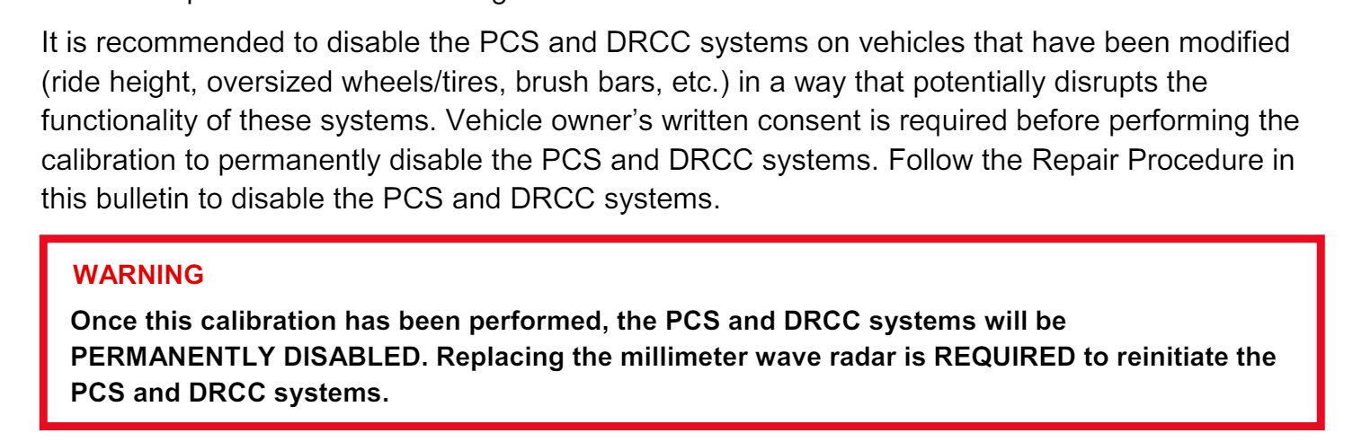

    Pretty sure once it's been disabled, you can't activate it again until you replace the radar.
    I don't know if there is a "temporary" disable option?
    See the TSB attached.

    As @TnShooter shared, once PCS is deactivated permanently, it is done until you replace the sensor on the grille. The PO probably had it disabled at some point. The dealer probably won’t do anything for you even with a new sensor until you get rid of the lift. Maybe try a different dealer, but either way pretty sure you will need a new front sensor.

    i went ahead and bought the sensor. Hope that and a re-calibration makes it. I appreciate your help

    I’m on an island so the windshield shops are only a few and none will do it. There’s also only one Toyota Dealership so I’m running out of options. But I bought the sensor and I’ll try to get it done that way. Thanks for your help

    Thanks! I’ll read the document.
