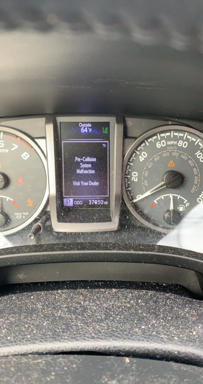

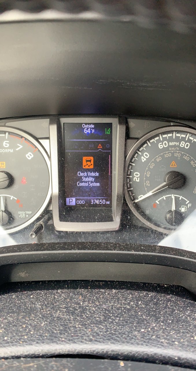

    23
    This is what my dash looks like 24/7 now
