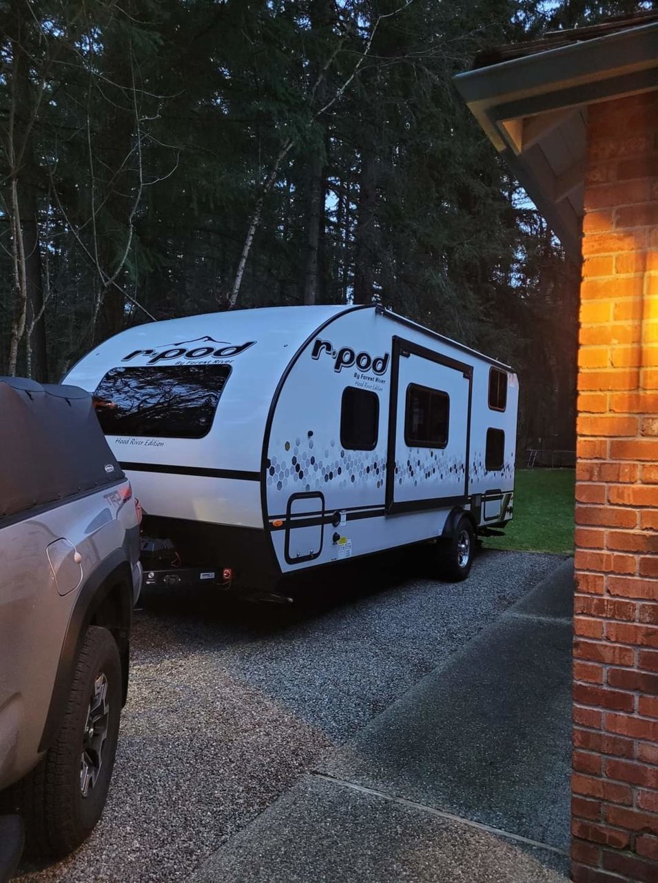

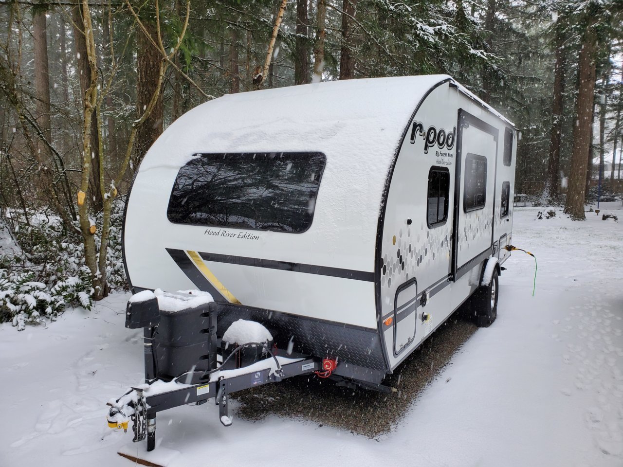

    Thanks! Just towed my new trailer home from the dealer. No codes on that short trip. Got it home just a couple of hours before the snow started.
