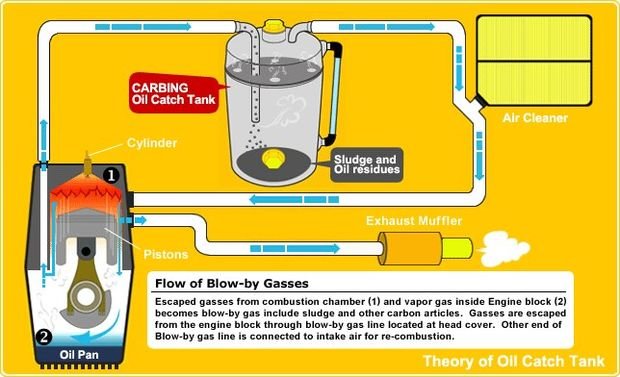

    Emissions. Oil vapor is bad. Cars today are designed to send it down your intake to combust it.
    This combined with Exhaust gas recirculation valves to further ensure complete conbustion are common.
    However oil vapor and exhaust residue collect readily in the intake and are the reason you need sea foam lime services to clean them out (Italian tune ups help too).
    A catch can mod is the first thing you do on most modern diesels due to this.

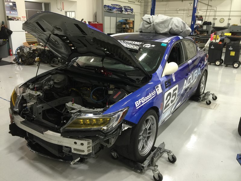

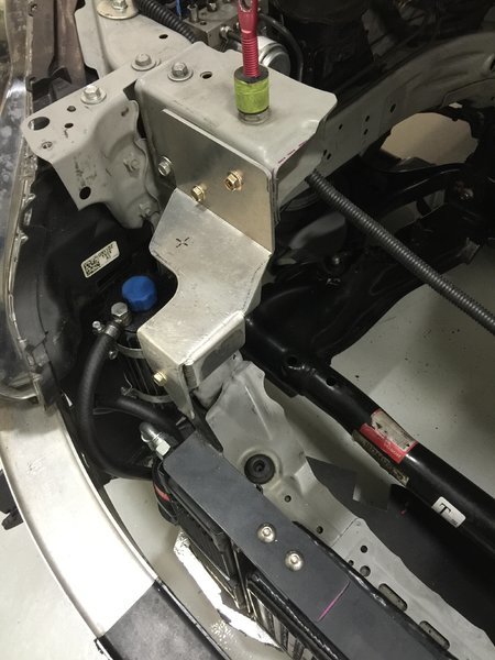

    LOL. Yeah, we can fill the catch can pretty quick in a 25 hour endurance race. The revs are always 5k and up. Grueling on all parts. Can't have any leaks or fluids on the ground either or get penalized.

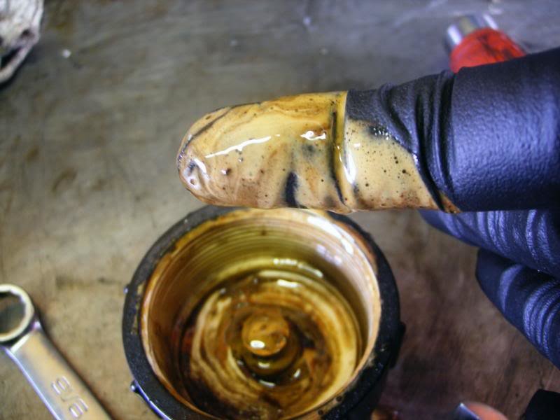

    Like I said, I've never run one, but would you want to run this stuff through your intake if a simple can can remove it o_O
