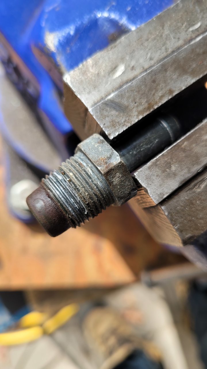

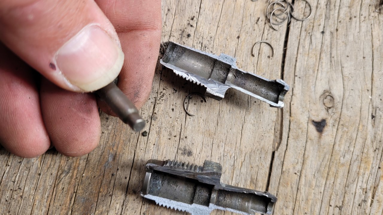

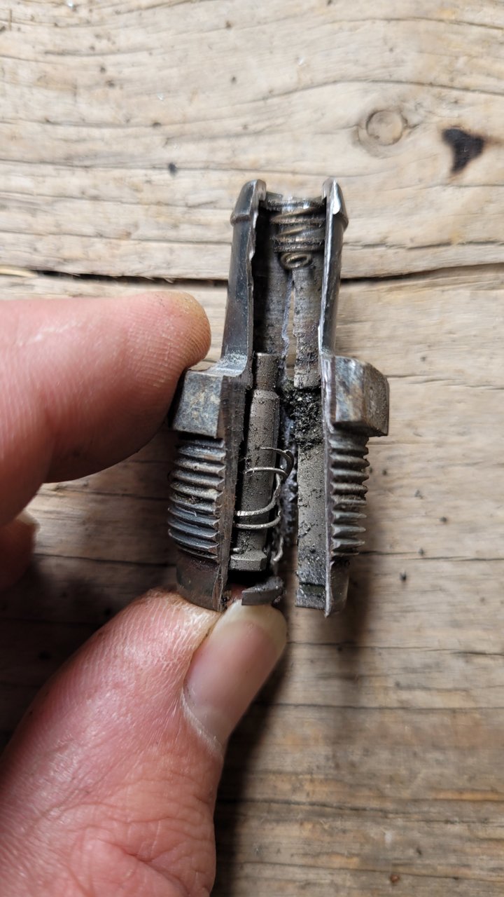

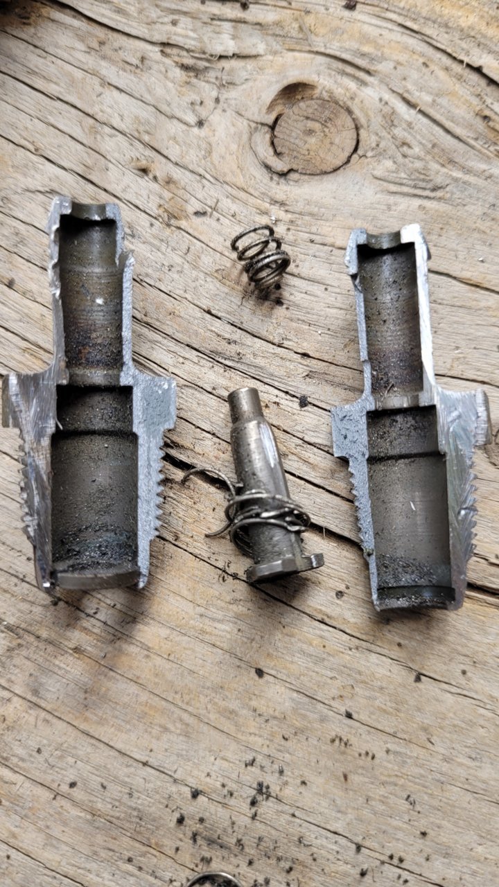

    Changed this for the 1st time since 2010 and about 230k km. Was really curious what was inside, so cut it apart. Got a little carried away with the cutting wheel and damaged spring and the piston a bit.
    Generally, pretty simple design and fairly clean inside. For the cost of this part, still worth changing it at required interval.

    It looks like something that is easily cleanable by soaking it or brake cleaner.

    Probably, but they are about CAD$10 new from Toyota, so not worth the hassle in my opinion. Cleaning it would get anything out (looked pretty clean inside honestly) but not sure how many cycles those springs are good. I cut the lower spring taking it apart, but I'd did look/feel brittle.

    Assuming you're not one of those recreational maintainers R&Ring it every other weekend, I agree that if you're going through the effort to take it off you may as well just replace with new.

    Thanks for posting this. Just changed the PCV valve on my 1GR-FE at 68K miles, first time. (I got the truck, used, at 60K miles.)
    5 or 6 years ago they were around $5 or $6. Now I can't find them for anything less than $12 each, online, w/ shipping. I had been thinking about opening one up to see whats inside.
    Looks like an eminently cleanable part. After a proper cleaning it'd be interesting to do a controlled side-by-side pressure / flow test to see how far a 68K-mile used PCV valve's pressure thresholds differ from a brand new one. If I get around to such a test (using sensitive HVAC testing manometers calibrated for inches of water-column, not PSI..) I'll post pics & results here. If a used, well-cleaned PCV valve responds to varying pressures the same as a new one, maybe just cleaning them out is good enough.

    It is, but buildup creates corrosion. This corrosion pits the check valve shuttle and its seat. This creates a vacuum leak. For $10-15 it’s best to just replace the valve.

    I agree with the previous poster: a little brake cleaner and all of that will buff right out: Re-assemble/re-install... Bada-bing bada-boom: Done! :D
