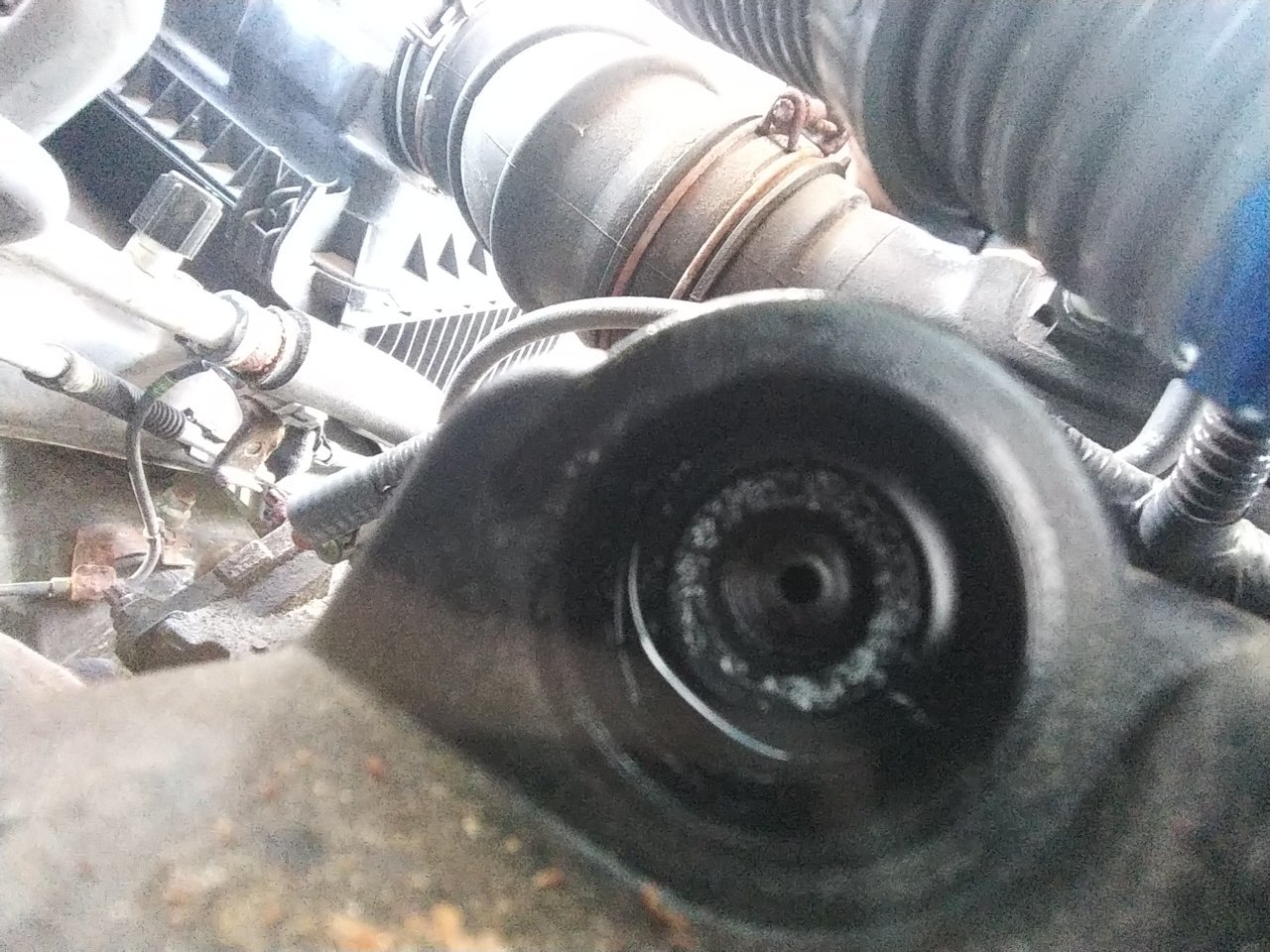

    Any suggestions on removing the threads on the pcv valve still in the engine? I have the 2.7l and the valve is in the back near the firewall, so there's not much room to work.
    The 2.7l pcv valve is a threaded piece instead of the rubber grommet with a tube

    I was able to figure it out. First picture is with the valve still in, the 2nd was with it out. I was lucky that the threads were still in tact, so with a little elbow grease I was able to slowly unthread it by hand.
    I probably should have tried before posting this, but with how hard it was to start unthreading the bolt with a wrench, I didn't think it was an option.
