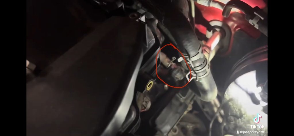

    I wish the video showed the actually disassembly. I need visuals, not explanation after everything has been taken apart.

    Just snug it up a little more than finger tight. The setting is an inch pounds my torque wrench won’t even go that low. In
    44 inch pounds.

    I just snugged it up a little more than finger tight. When I took it off, it was not tight at all.

    Here’s a video of when I did mine that I posted on YouTube.
    https://youtu.be/2-3_XxdzlMU?si=cLbQuCGeofXxjjcd
    But you may be able to get to the PCV valve without taking that dampening foam off. I was just copying the way someone else did it.

    on a 3rd gen, since its plastic, its very easy to snap it off inside the motor by over tightening it.

    Yeah I just might do that give it a slight turn after hand tighten

    I used a wheeler fat wrench to set the 44 in/lbs of torque, I wasn't worried about the exact torque specs but I have a tendency to over tighten things so it helps me know when to stop....
