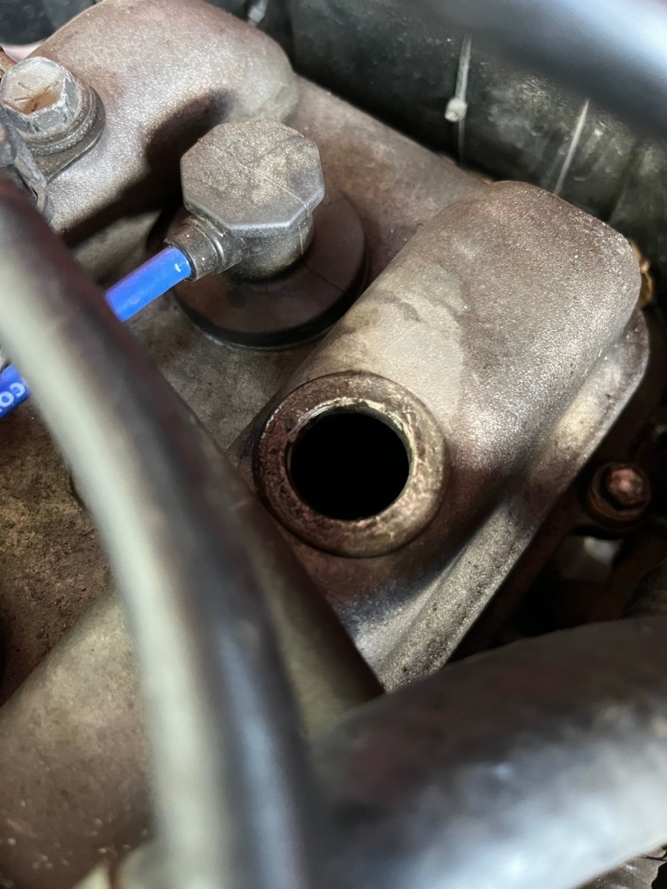

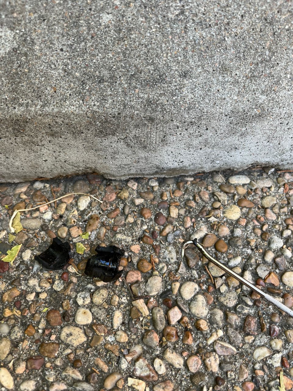

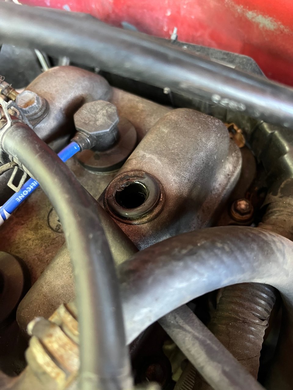

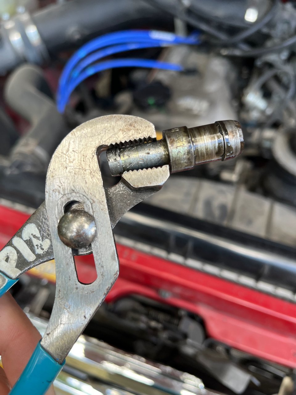

    I picked up a heat gun and some pick tools. With the help from the heat gun, I was able to remove the valve:
    Here's a shot of the grommet by itself:
    And here's a shot of the grommet missing somewhere in the depths. Why did I decide to do this before ordering some delicious curry takeout?
    I tried fishing around with a hook tool and haven't caught anything yet...
    TWJLee, TACOTU3, zero4 and 1 other person like this.

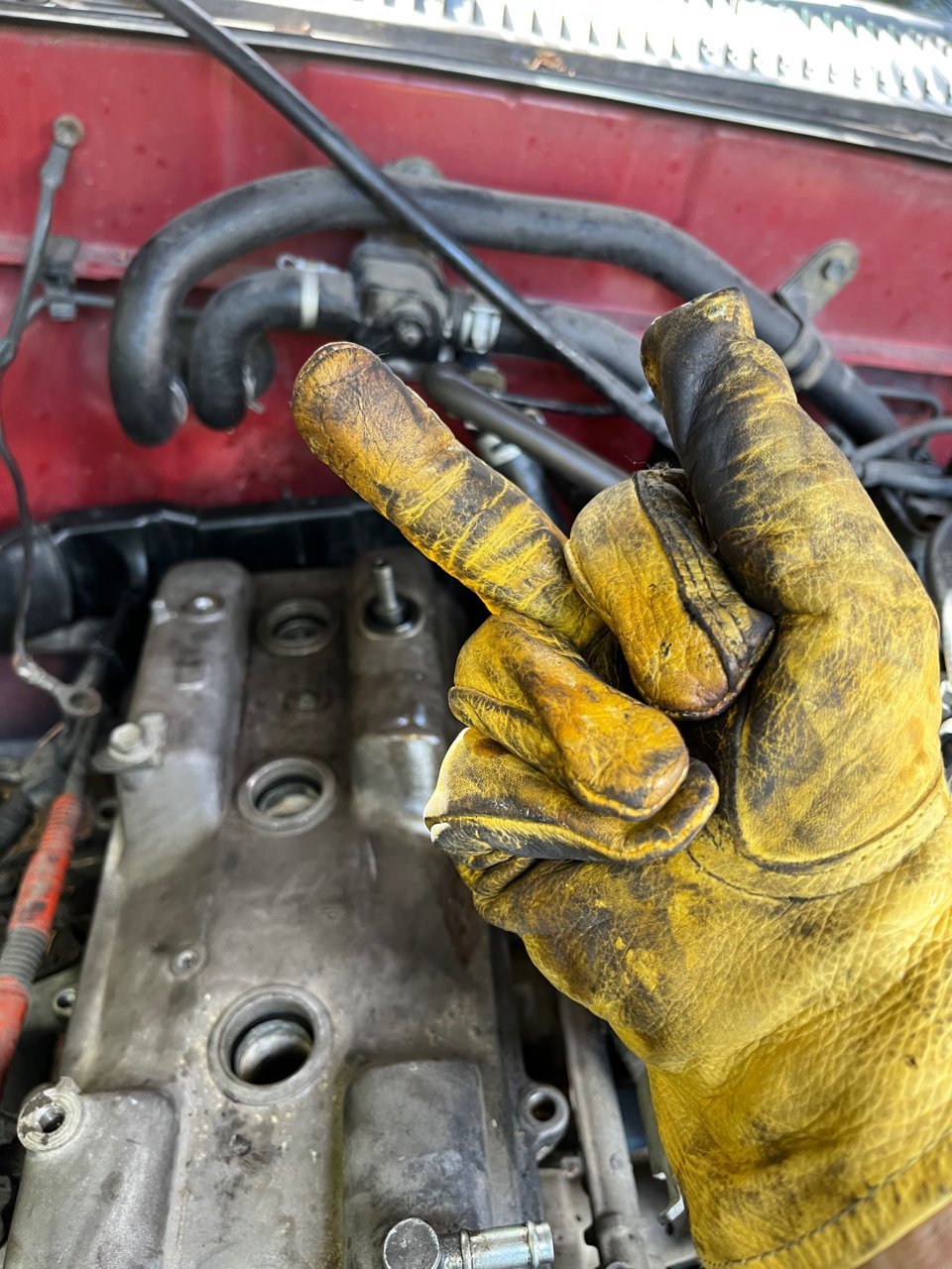

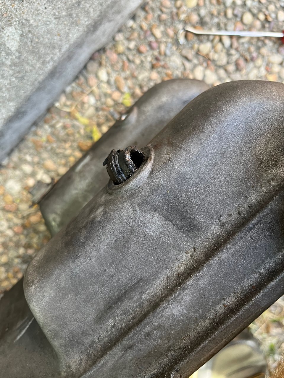

    Update -- I finally got the grommet removed and the new grommet/valve installed. It was a monster pain in the ass.
    Here's a view with the valve cover removed:

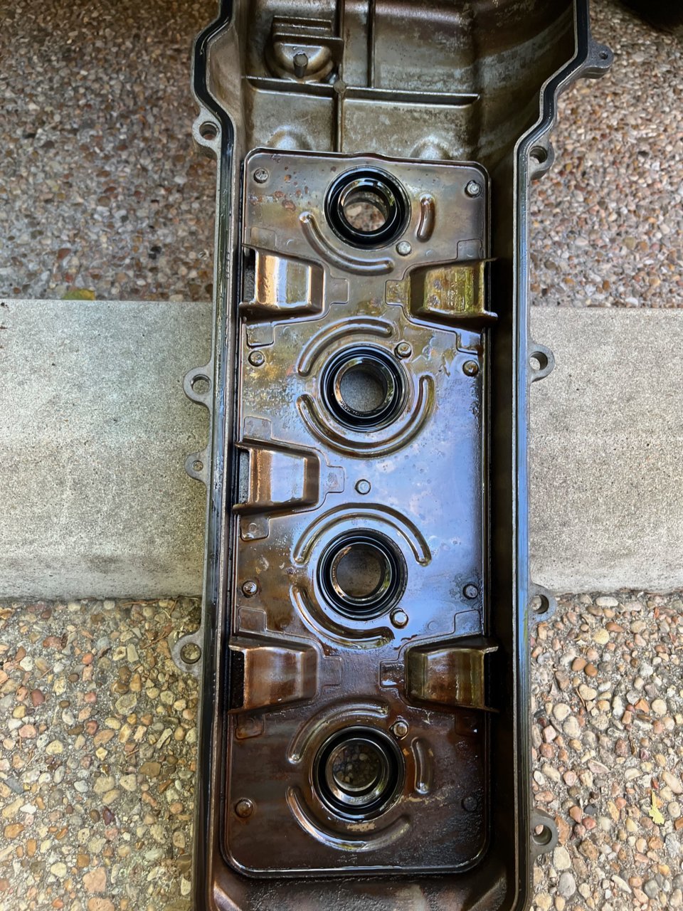

    This is the underside of the valve cover. Notice that there's no obvious hole where the PCV valve leads through. I guess it's compartmentalized. That would have been good to know before fishing around the top, bewildered at the missing grommet.
    If you've ever lost a guitar pick in the sound hole of an acoustic guitar, it's kinda like that.
    removed:
    and finally:
    Was it worth it? No, I don't think so. The old valve rattled. But of course, I couldn't have known this without removing the old one to check.

    Oh BTW, there's a baffle on the underside of the valve cover. :D
    Kiloyard likes this.
  14. Jul 24, 2022 at 6:25 PM
    yodiggity42
    yodiggity42 [OP] Active Member
    Dec 31, 2021
    #385939
    26
    well, the baffle earned its name
    Kiloyard and MalinoisDad like this.
