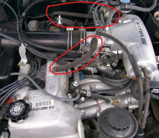

    looking for part number or alternatives on these 2 hoses if anyone can help, thanks in advance

    I tend to buy vacuum hoses by the 100' roll .
    Your local Auto parts should be able to find something.

    what size is it 3/8?

    No idea I have every size from 1/8" to 1/2"
    I just walk into the parts room and match things up.
    Just use common sense and extend the length and make bigger radius bends.

    Regular hose wont work on pcv......you need a fuel resistant hose...
    I used snowmobile fuel hose......bought 10' off amozon for like $8....
    3/8 or 5/16.....
    For the inlet hose......vac feed off carb.....I use braided silicone jacketed hose....
    I can buy by the foot at napa......
    Amazon.com: HPS 5/16" ID blue high temp reinforced silicone heater hose 10 feet roll, Max Working Pressure 85 psi, Max Temperature Rating: 350F, Bend Radius: 1-1/4" : Automotive

    Now days so many different flavors of hoses just how do you define regular hose??

    Yeah that's the reason why that one hose looks so funky and different from all the other hoses around it....
    and expensive......
    That one hose gets old and ends wallowed out.....and a rotting pcv grommet...
    ......bet this is the no.1 area for vac leaks in these old girls......
