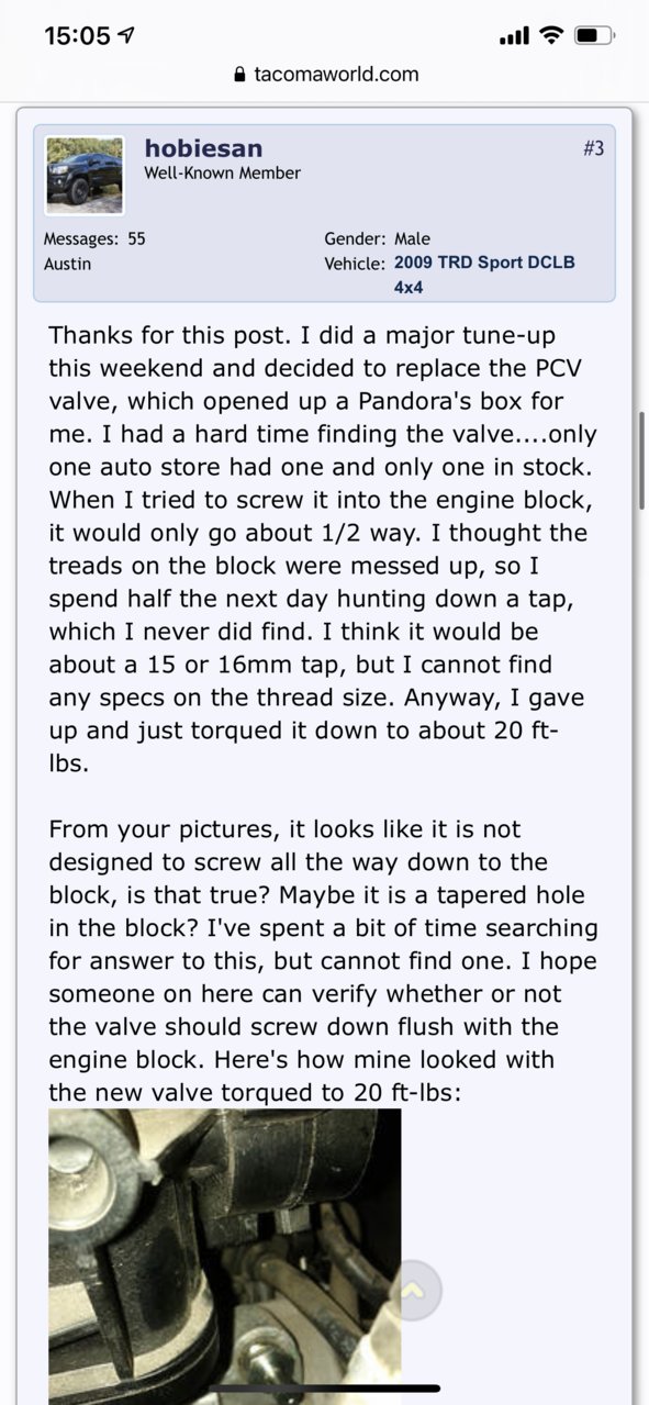

    I picked up an after market valve as well as a grommet for my 2012 2nd Gen.
    After removing the OEM valve and began hand-threading the new one, I found it would only thread about 50% of the way in.
    I immediately thought I had cross-threaded it.
    After substantial digging I found the post which I have attached an image of. As far as I can tell, the valve does not thread in 100%, likely tapered on the inside.
    Additionally, I was led to believe there was a grommet that was supposed to go in as well. This is not the case either, as shown in the two tutorial’s I linked- they did not forget to include. I am under the impression the 4.0 simply doesn’t have one.

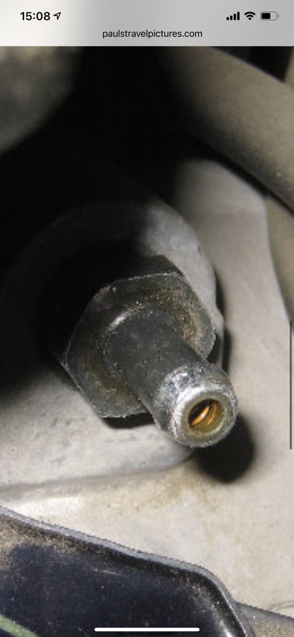

    i hope others more experienced than I can confirm this and this post can quickly confirm to others that were in a similar position to myself today. I have also uploaded the best picture I could find of a newly installed valve and what it should look like.

    Looks like you tightened yours in deeper than I did mine. I put a tiny bit of teflon paste on the threads, not really necessary. Looks like you’re ok.

    If you screwed it in by hand several turns, then it is not cross threaded.
    I think the PCV on the 1Gr-FE has a pipe thread. Remember, there is literally only a few inches of water pressure. No need to CRANK it in. Just nicely snug is plenty.
