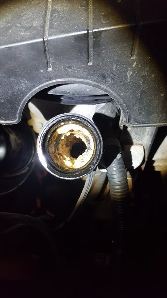

    thats what mine looked like a few weeks ago, nothing to be concerned about ive been told

    Yep, you guys probably make a lot of short drives? Wipe it out and take a longer drive and then check it.

    What does the oil in the crankcase look like?
    If it looks like that you do have a problem.

    Yeah a little under the cap is not a problem but that is concerning. As far as a write up for the pcv, it's about as easy as it gets to change. Unhook one hose and unscrew. Replace.

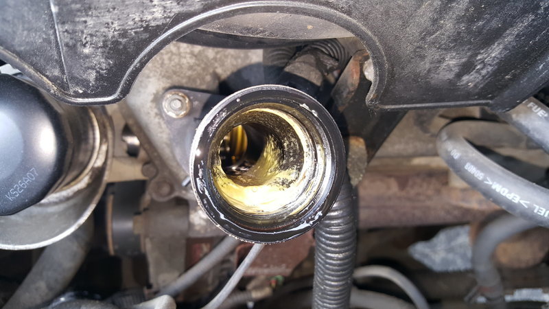

    I went out and took a picture just now, that other picture is from about one month ago. It isn't nearly as bad, but still water mixing with oil at the cap there. My drive to work is ~5 minutes, and about once or twice a week I drive for 15+ minutes. Did an oil analysis about 6 months ago and no water came up in oil, oil also looks good when it comes out. I don't think its something to be too concerned about.

    That'll do it. Longer drive I would say is 30+mins.
