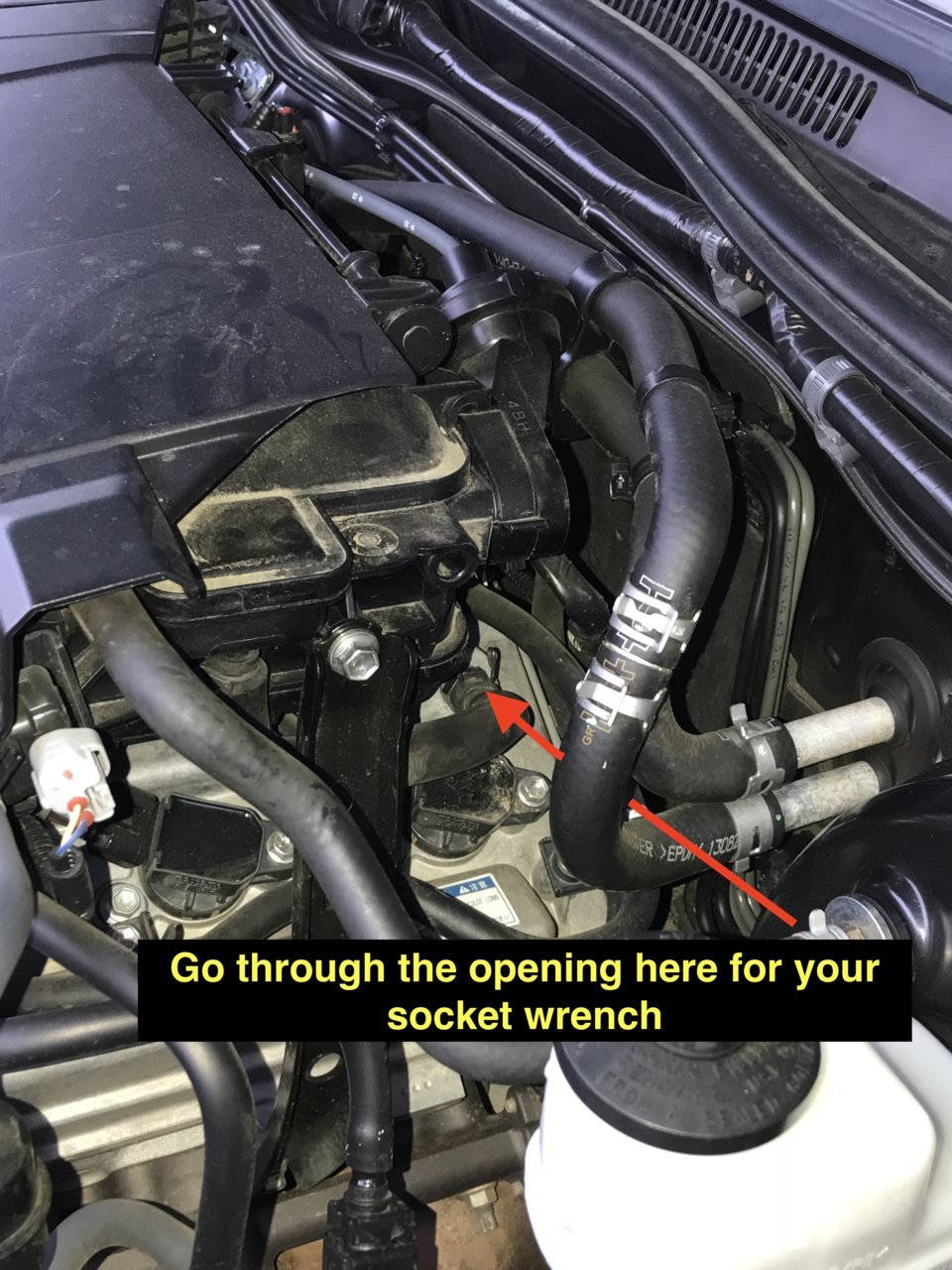

    Finally changed the PCV valve yesterday. Wasn't hard with the right tools. Didn't have to move anything really. Used a deep 3/4 socket, socket extension, and socket wrench. Thats it. Pulled the hose off using the clips. Removed the old PCV. It still rattled but figured i can clean it later and reuse it again on the next 100k change. Compared the old with the new one. Installed the new one. The new PCV threads seem to be tapered. I screwed it in tight, did not torque it. Reconnect the hose (which i should have inspected, but i can do that later), and that it! easy peasy! Heres is a pic....

    *Update!!* I bought a 1/2” drive 19mm socket and 5” extension with a 1/2” drive torque wrench and it threaded all the way in like butter. Torqued to 20ftlbs and done. So much relief. I would suggest to anyone to not use a 3/8” drive. It did not have enough power behind it, atleast in my case. Also, ordered OEM part on ebay for $9 and will be installing that in a few days just to be safe.
