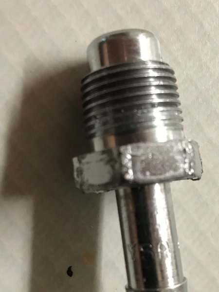

    OK... so I'll share my experience changing the PCV valve and grommet on my 2000. First of all I just want to thank the members on this forum for the warning about the disintegrating rubber grommet. Without the mental preparedness this may have really freaked me out. As it was, I went about it with forceps and a set of small hook/pics. Still very tedious and nerve wracking thinking I was gonna drop big pieces down in the valve cover. I can see why 2nd gens. went to screw in PCV valves.
    If you had a thin "exacto" blade like ones used for crafts and such you could maybe do this better by carefully cutting up thru the grommet from the inside and then lapping one side of the cut over the other with forceps to pull it out in one piece.
