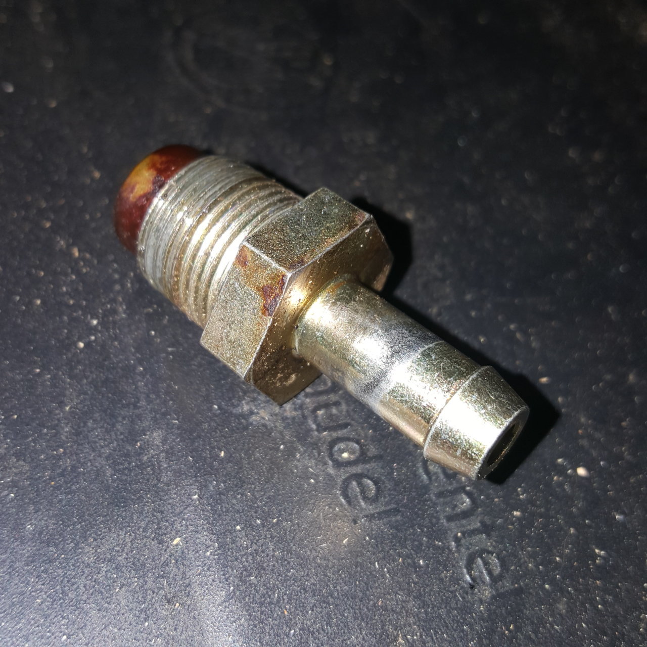

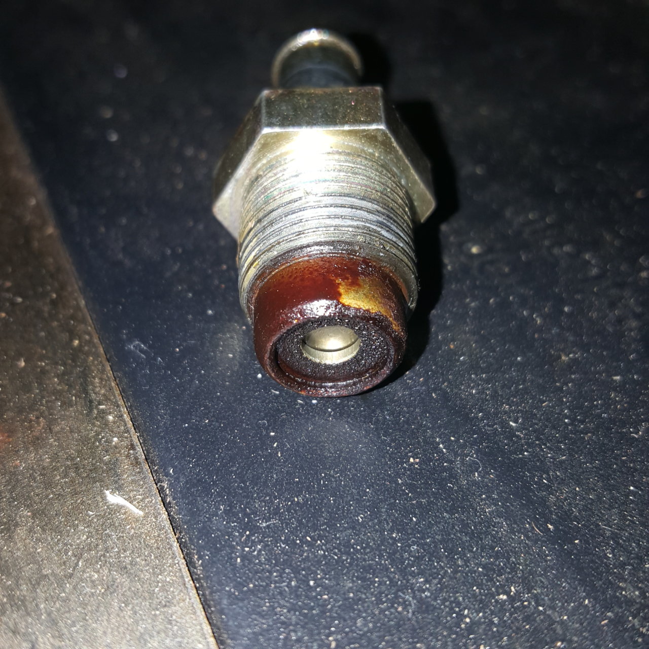

    Changed mine with plugs last week. Old one had a little rattle but nothing like the new one. Here's the old one:

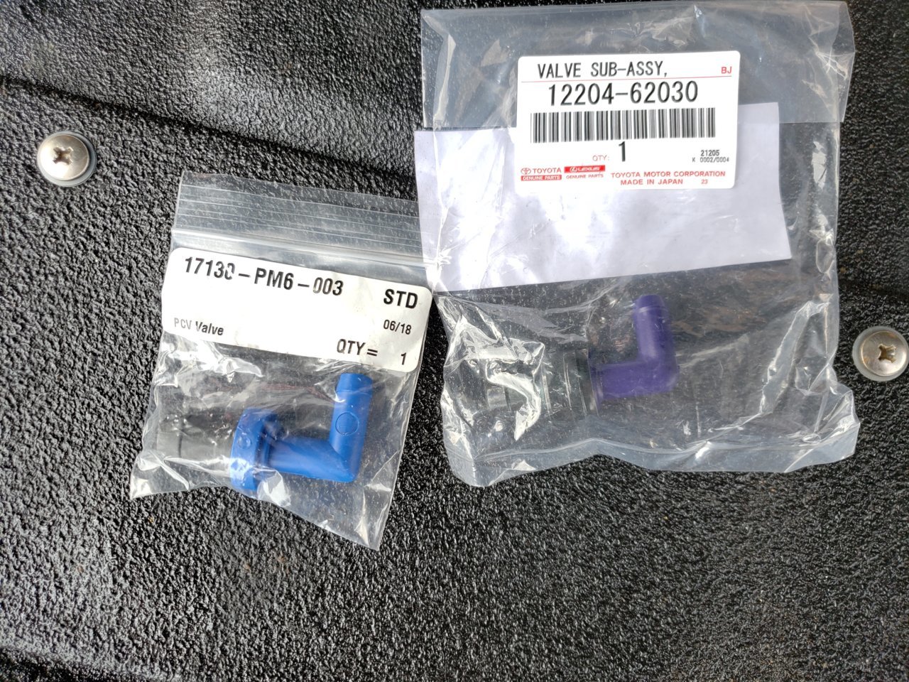

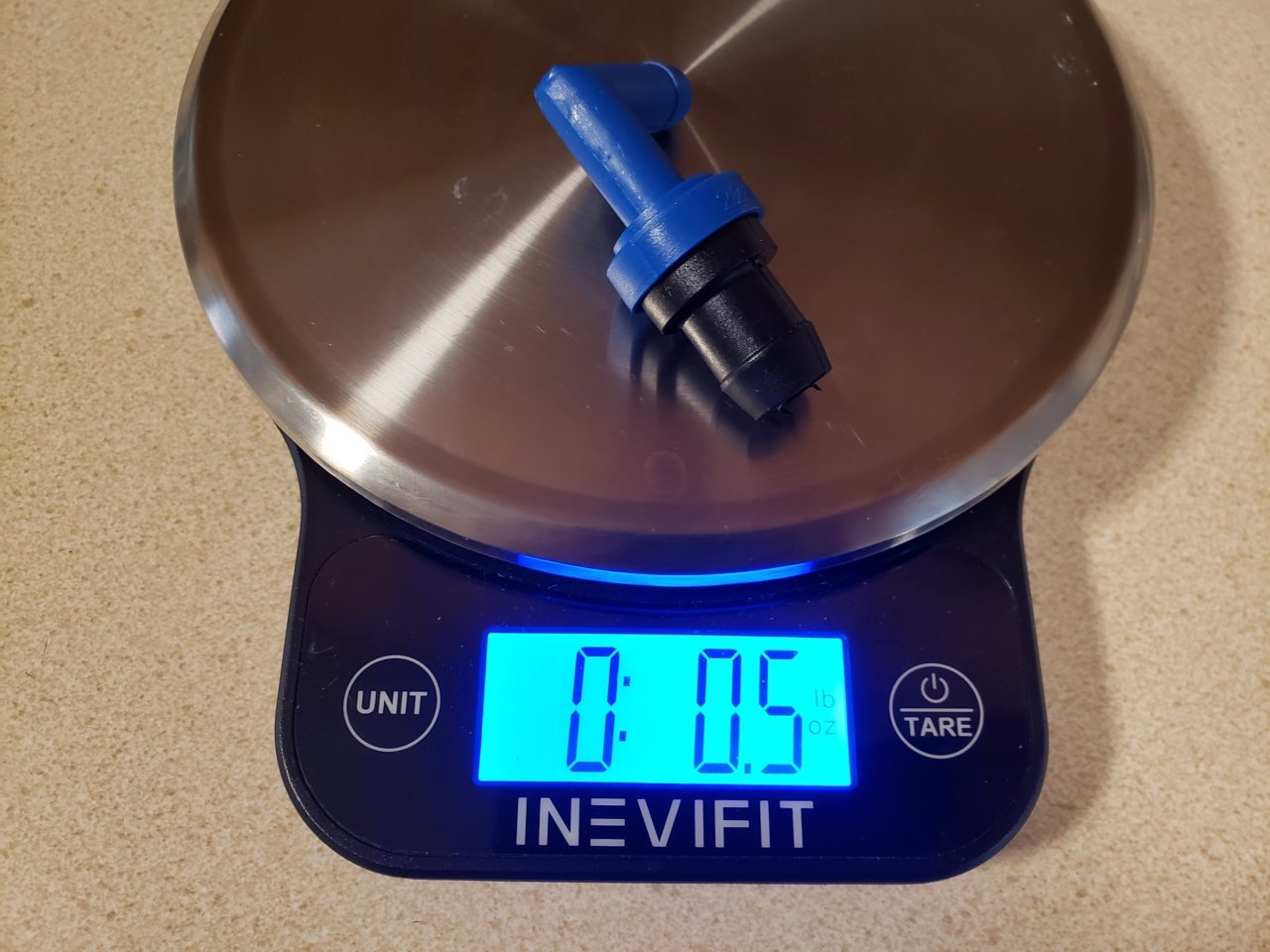

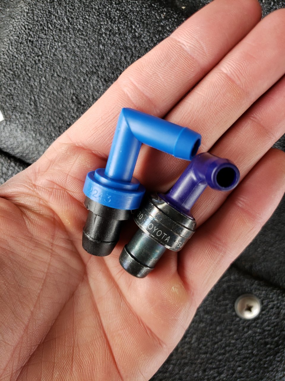

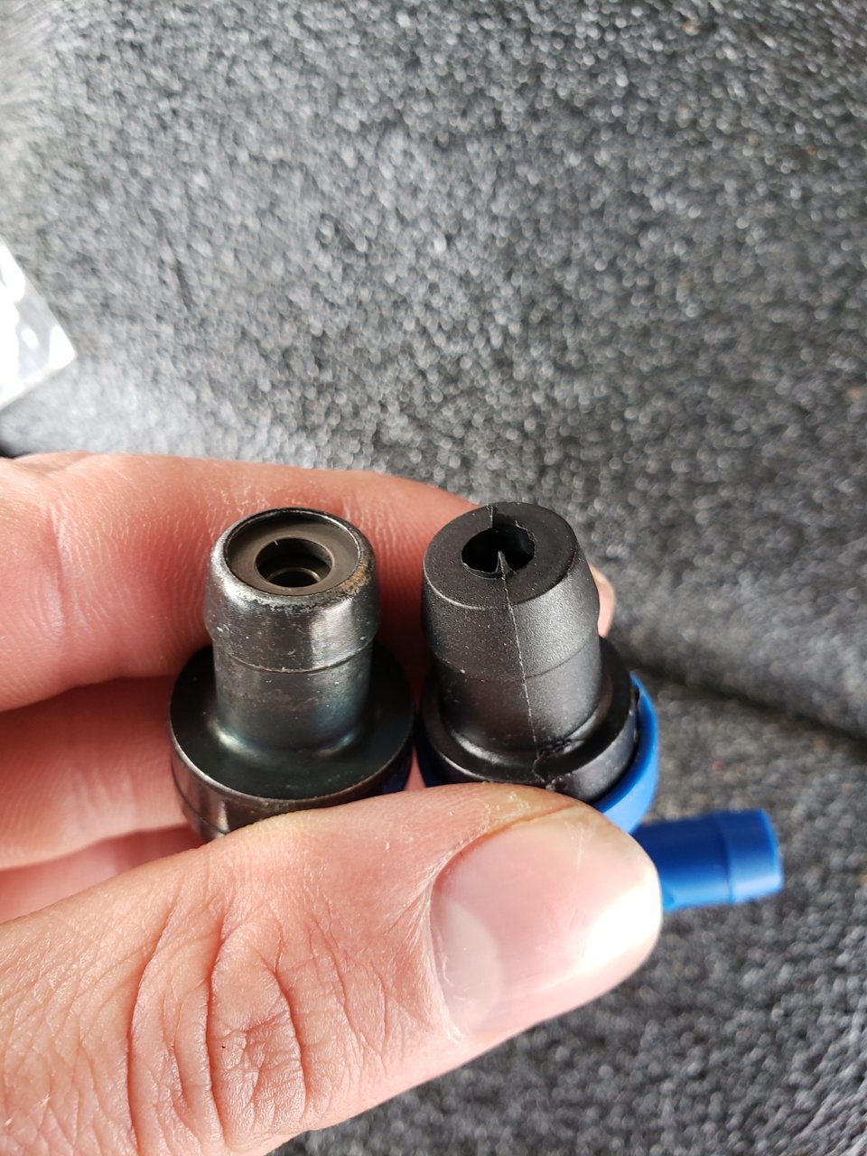

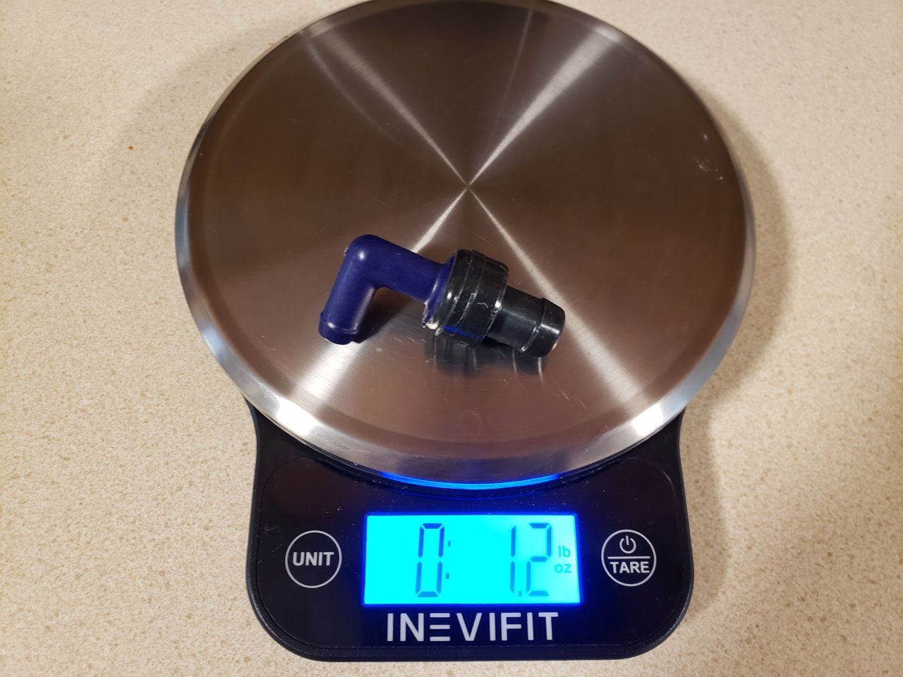

    While I agree it's not a critical part, DO NOT just grab any old PCV Valve. I highly recommend using the Genuine Toyota part for this as its made with metal/plastic parts and is high quality.
    I Just swapped out my PCV at 160k miles, looked like the original. It still rattled but just barely. I bought a PCV kit on ebay that included the grommet, Genuine Toyota PCV hose, and a generic PCV Valve. (it was cheaper to buy the kit than just the hose by itself haha). Luckily I also bought a genuine Toyota part PCV valve! Heres the kit I bought and Heres the genuine toyota PCV I bought.
    Comparing the two in the pics below, the Toyota one was significantly heavier, better plastic molding, and the base was made of metal. It also fit snug into the generic grommet. The generic PCV was cheap and I doubt it would last 30k miles, while my OG valve lasted 160k and was still ticking!
