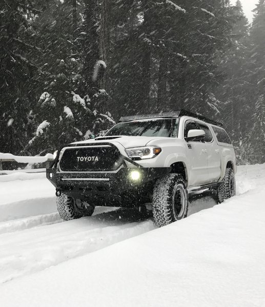

    My wants include: 2-3" coilover lift with 33" tires on 17 or 18" wheels. I want a nice lifted aggressive stance without affecting the driveline/steering components dramatically. Usually go up to the mountains for snowboarding and the occasional camping trip in the woods, nothing extreme.
    Pics for attention and recommendations. These are not mine, but love the stance/height and would love to replicate this.

    Love the pictures. It is nice to see the snow! I miss it.....sometimes ;)
    PNWTacoma[OP] likes this.
