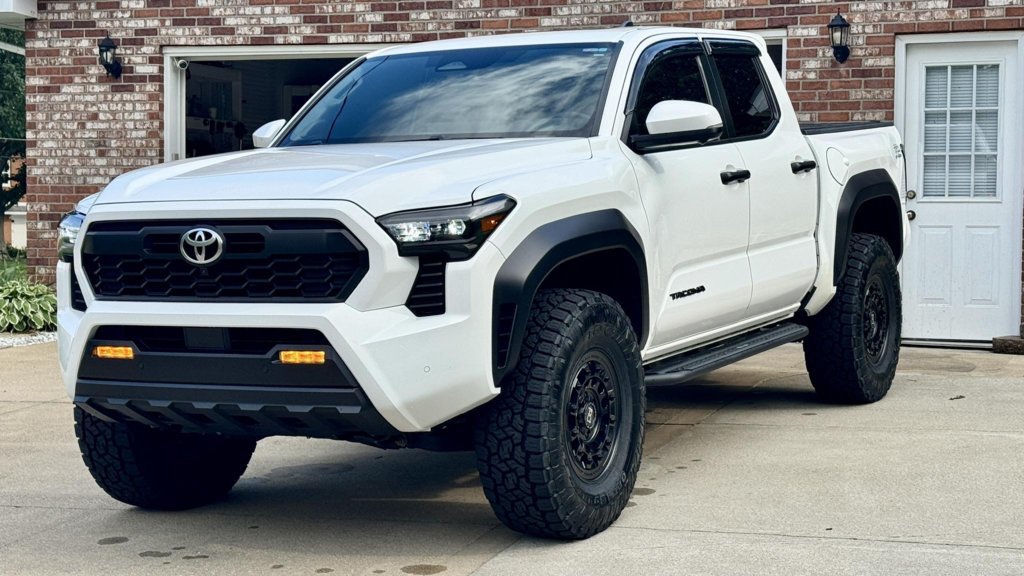

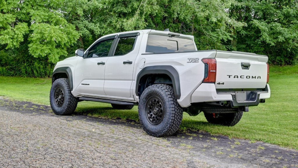

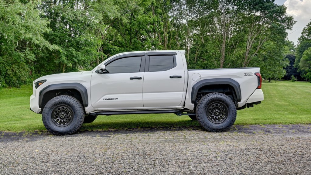

    I finally made the leap and had a 2.25" Peak Suspension 2-PIECE TRAIL KIT – 2.25″ LIFT w/ the 2" lift option in the rear (you can choose between 1" and 2" in the rear). I chose 2" to keep the factory rake. I don't want it sitting like a speed boat when 500-1,000 pounds of weight is in the bed, off the hitch, etc.
    I fitted my Black Rhino Fuji wheels with Toyo 35x12.5x17 Open Country AT3 tires.
    I always hear people saying that a lift ruined their ride, etc. I'd have to say it's either just as good as before, or slightly better. I did have to remove the factory OEM mud flaps (no big deal) as well as the little piece in the liner (removes with I think three bolts). No rubbing whatsoever...and honestly looks cleaner without the mud flaps.

    It looks spectacular. 34s and 35s with a couple inches of lift look perfect on these trucks.

    +38 Offset Black Rhino Fuji Wheels.

    Man that looks absolutely killer. Awesome choices on everything!

    Thank you. I watched a lot of YouTube videos to try to get as close to “the right look” as possible. A little bit of luck, probably too. Lol
    I was really impressed with the ride. I didn’t expect it to be that smooth. Bonus…
