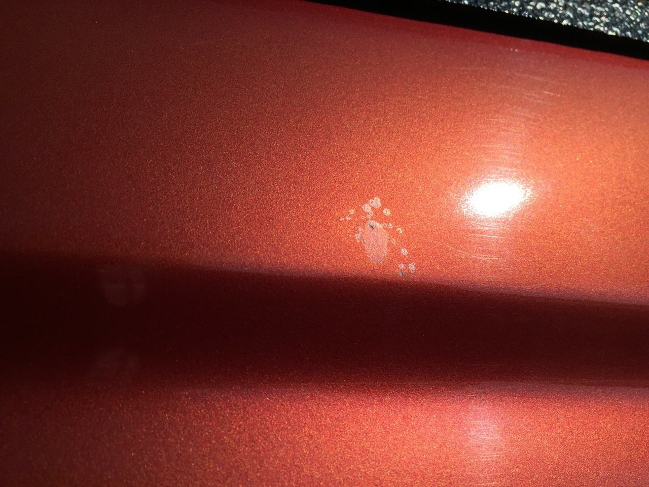

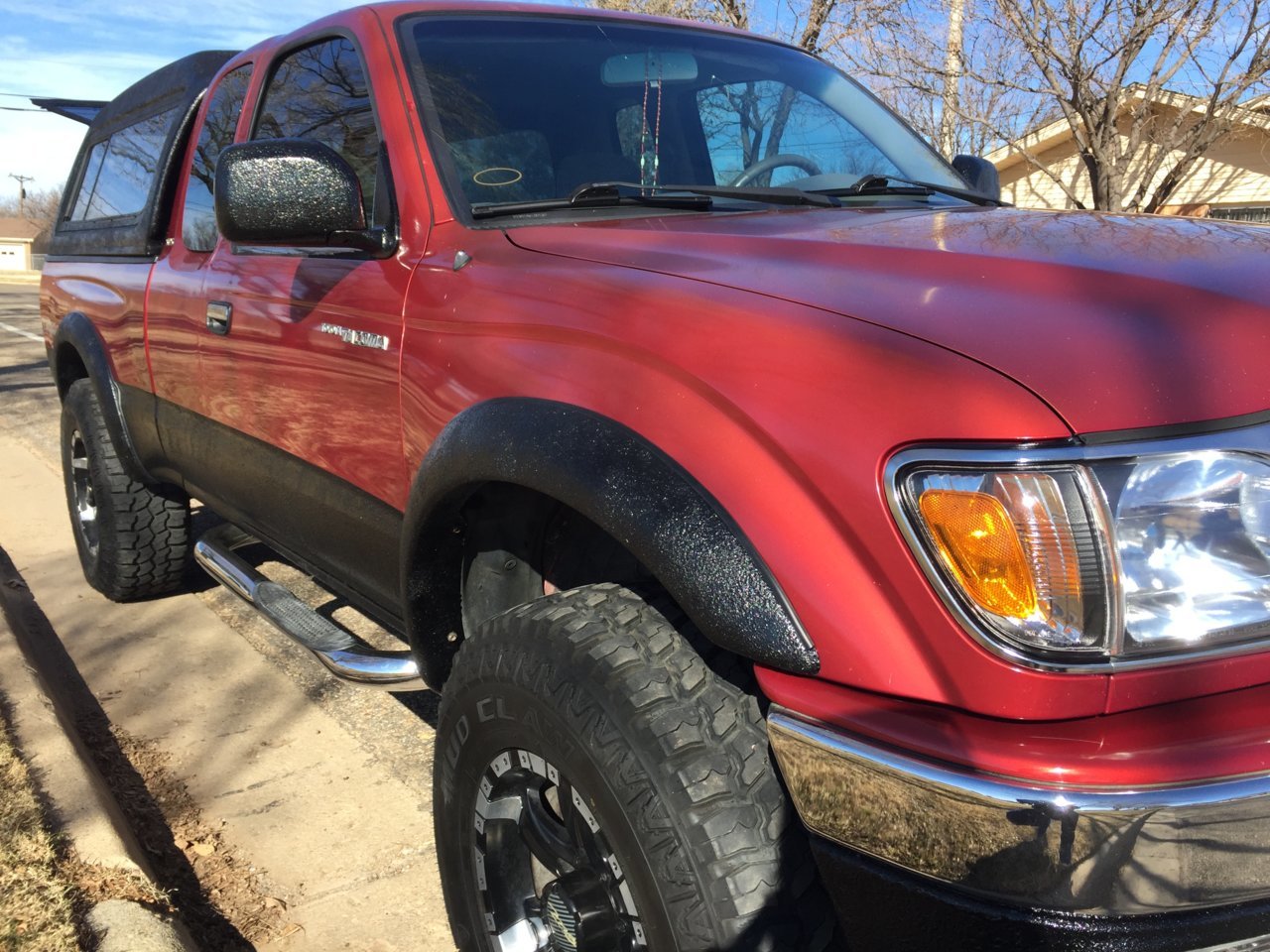

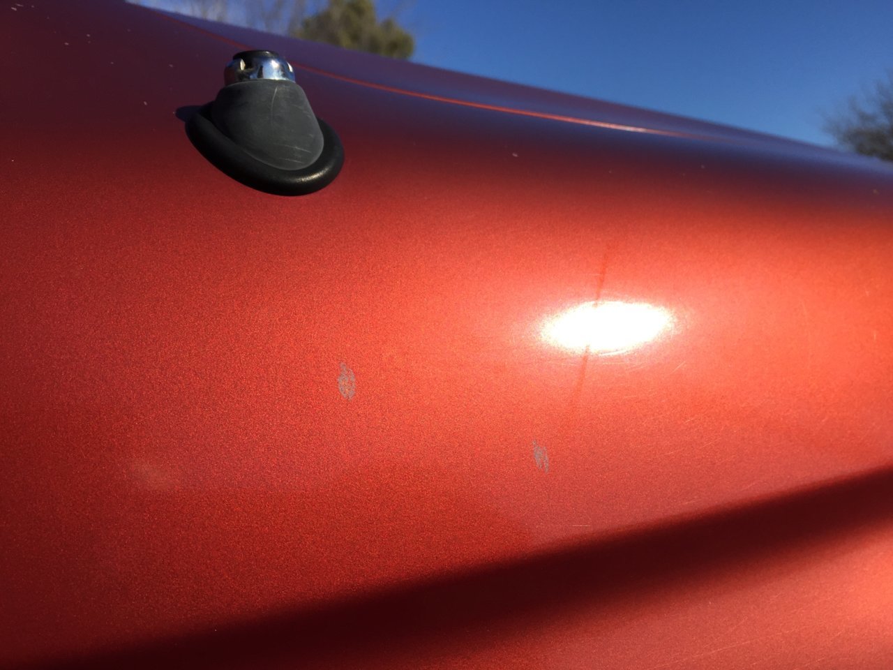

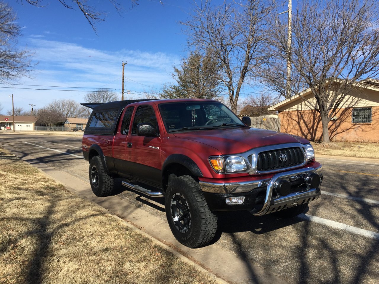

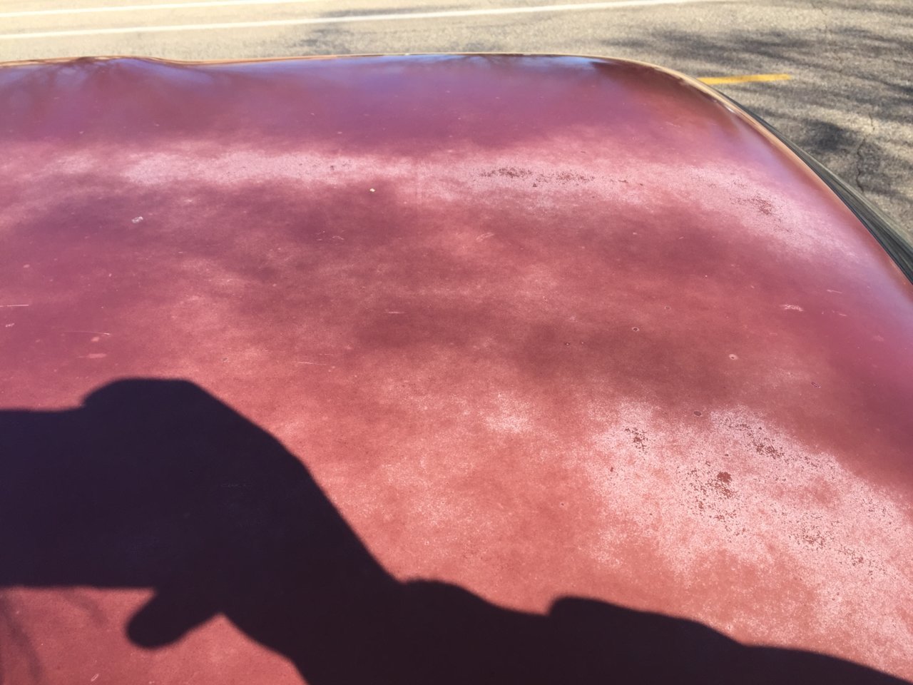

    Hi,
    I recently bought a 2001 Tacoma 4x4 TRD OR Manual with 160K miles. This is the exact truck I've wanted. It’s red as well!
    Pros: Exact truck I've wanted, replaced timing belt and such, brand new oils in all, perfect frame, new tires, just finished truck bed lining the bottom quarter. I wanted to protect the rock chips from eventually starting to rust.
    Cons: Sunbaked paint with pealing clear coat, brakes will eventually need to be replaced, some scratches on the paint.
    I have about 9K into it. A friend could wrap it in vinyl for under $1800, I could get a clear vinyl wrap on the roof for $400, repainted color/clear coat for an ungodly amount, or leave it and would get to the bare metal in about a year.
    I'd like to keep the truck for a very long time even if I get a newer vehicle. I just love these trucks. So I want to protect it.
    Is it actually worth it to spend $1800 on it? Trying to take my emotions out of it and see what other types of truck I could get for $10,800. Maybe I shouldn’t of bought the truck but here I am. :D What would you do or recommend?
    Thanks

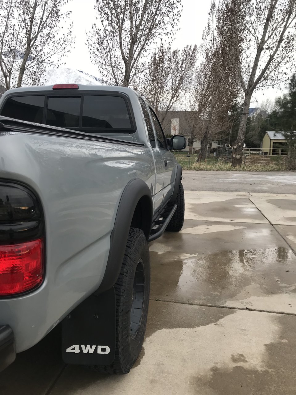

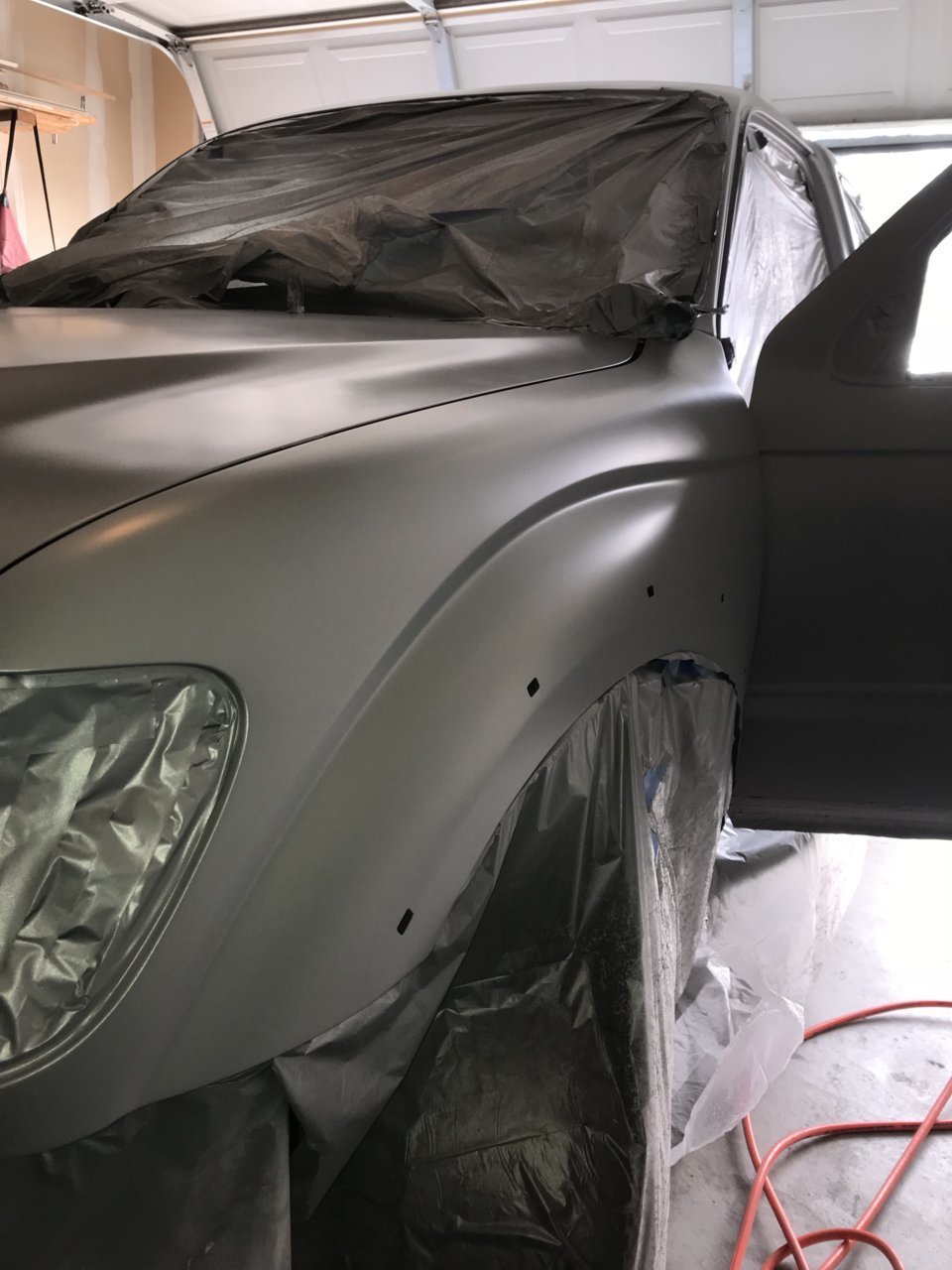

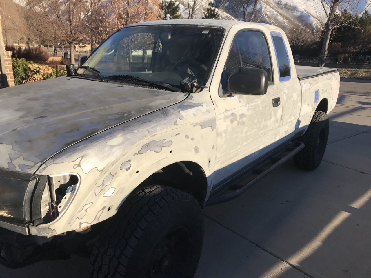

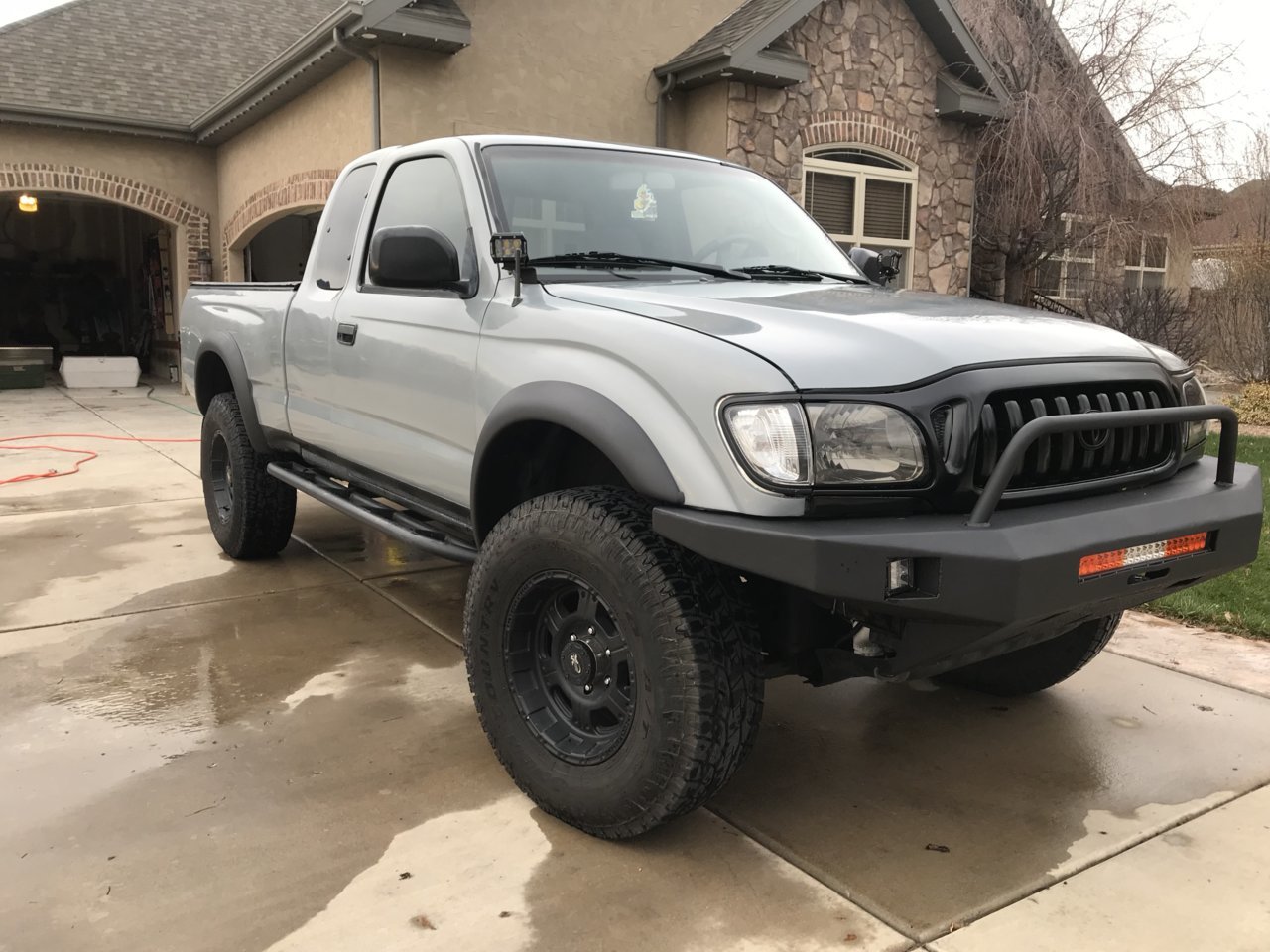

    I had the same issue when I bought my truck as a sophomore in high school. Had no money to fix it for a long time and the clear coat was bad pretty much everywhere, so I needed to fix the whole truck. Luckily I had a few friends that took auto body classes during high school and I had seen his work and trusted him to paint my truck. Went and bought all the supplies from a sherwin Williams automotive for around $500 (cement gray color was more) and went to town sanding off all the old paint. I wasn't super picky about fixing the little dents but I did want the rust spots to be repaired, so we had to sand them all the way down and cover them with a bondo. Turned out good enough for me in the end after some wet sanding. After all the sandpaper, tape and other expenses I was around $850 all said and done.
    r+l3u8lYSqucYD5Umc8Qgw.jpg NTetcaoKTBeGErDwBGzrNg.jpg 4qGO38QUQkaLeK%9xz3GHA.jpg vSeJB7ocRmmzPK6fU10EGg.jpg Z3cE7cwkSIKOjHimXjQIwQ.jpg

    Bad assssss!! That bumper sick man :thumbsup:

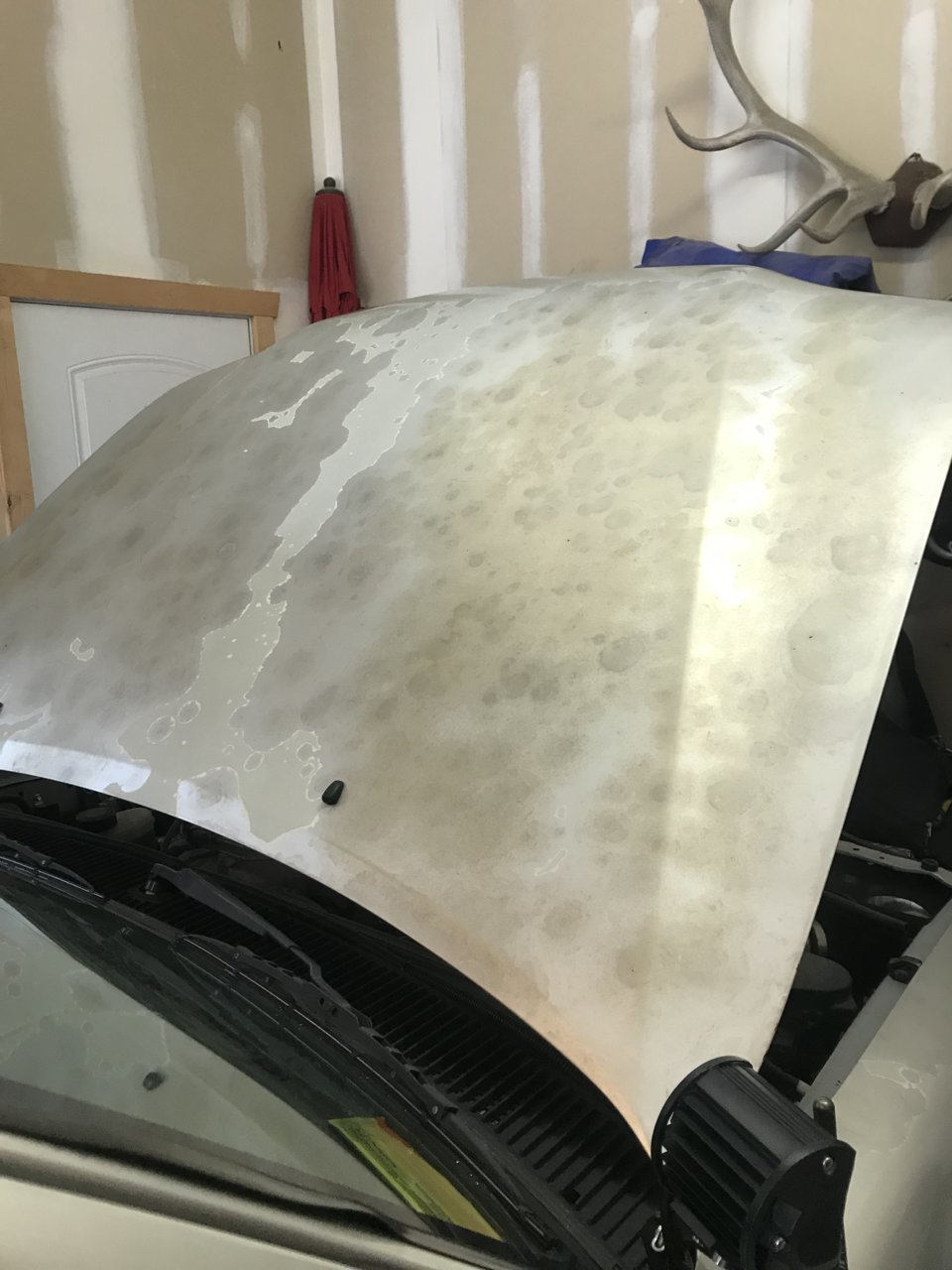

    My clear is coming off the hood. Unfortunately, I am a political prisoner in kommiemexafornia where solvent based paint is a felony. Will have to wait until we make our escape to the US to get it re-sprayed in a non water-based paint.
