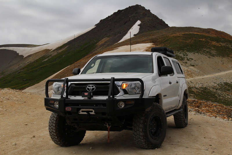

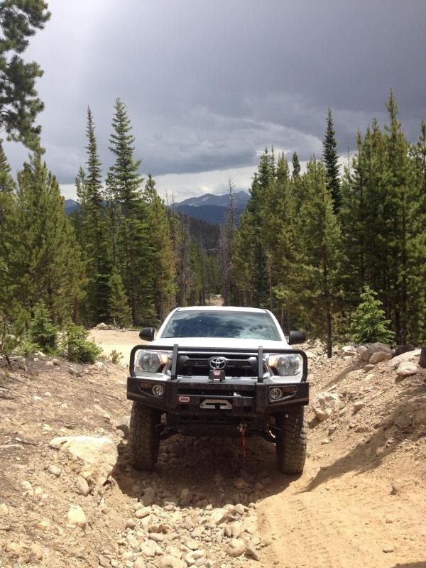

    Hey everyone, I figured Id finally start up a build thread since I have at least a few substantial mods completed.
    The idea of this truck is to have an everyday drivable overland vehicle. It’s a work in progress so I don’t plan on being finished for a while.
    The day i bought her:
    Here’s the rundown:
    2013 Tacoma DCSB, Super White, 6Spd
    Engine:
    - 4.0L V6
    - Bone stock
    Body:
    - ARE CX camper shell
    - BAMF CB antenna mount
    -Front Runner Slimline II Rack
    - Plastidipped emblems/debadged
    Armor:
    - ARB Bull Bar W/ Indicator lights and fogs
    - Armor Tech Offroad Rear HC Bumper W/ all the goodies
    - SOS Concepts Bolt on sliders W/ kickout
    Suspension:
    - OME 886 coils & struts
    - OME Dakar packs
    - SPC Light Racing UCA’s
    - Sway bar deleted
    Wheels/Tires/Brakes:
    - BFGoodrich 255/85/R16 KM2
    - TRD Fake Beadlocks
    - SS Extended brake lines (From TW group buy)
    Recovery:
    - Warn M8000S
    - OKOFFROAD offset hawse fairlead (Needed for ARB)
    - ARB tree saver
    - A few ¾” shackles
    - Warn Premium 24000lb snatch block
    - 48” HiLift
    - DieHard jumper cables
    - Scepter Fuel Cans
    Electrical:
    - Home brew fuse panel (For “automatically on” switched accessories)
    -Scangauge II
    - DieHard Platinum Marine group 31M
    - Pelfrybilt battery cage
    - Cobra 75WXST CB
    - Firestik II W/Fire-ring cable
    - Garmin GPS
    Interior:
    - Weathertech mats
    - Blendmount (For Scangauge)
    - Panavise Indash mount (For CB)
    - ARB Fridge/Freezer
    -ARB Fridge Slide

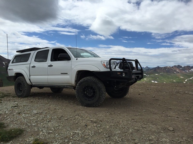

    Most current shot!
    More to come when I get all these damn pictures uploaded. :cheers:

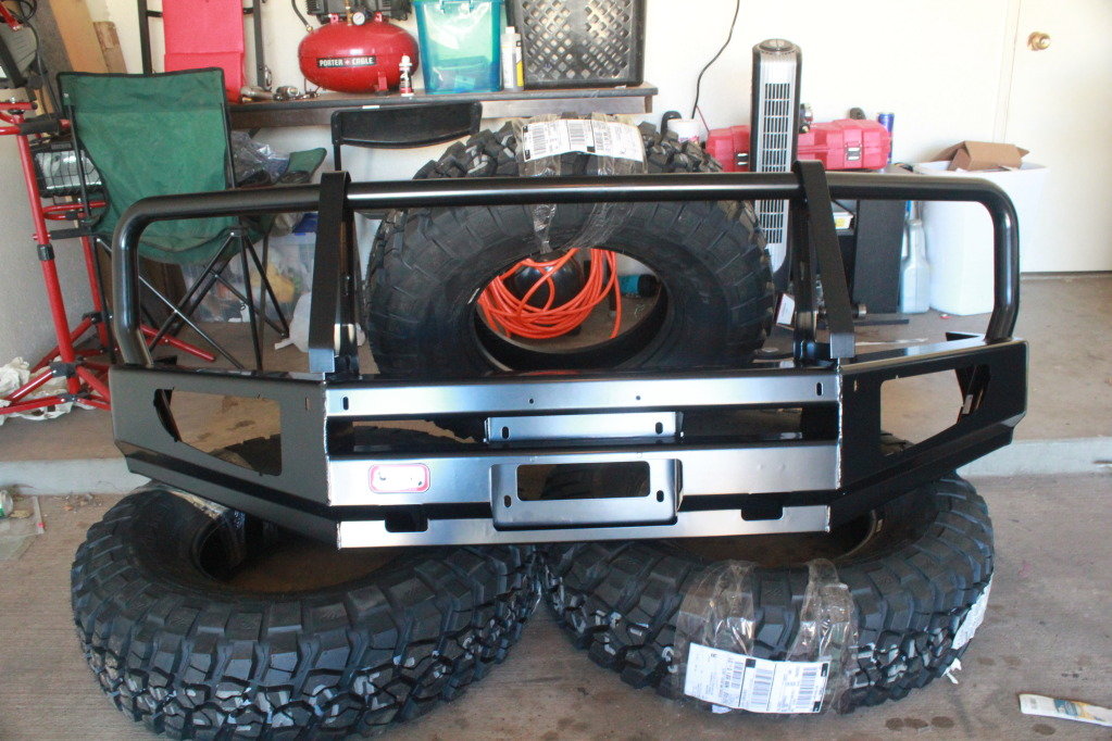

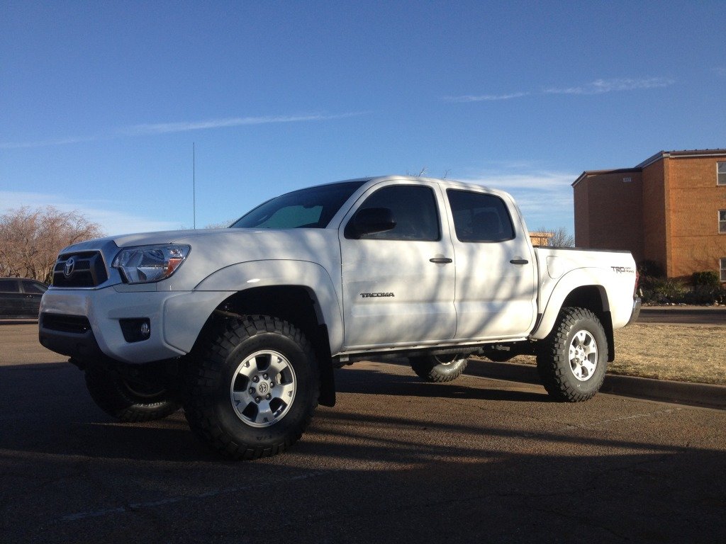

    So i got back from my deployment and had already spend most of my money :eek: :D
    ARB, lift, tires and winch all waiting for me!
    Phase one complete:
    Gotta test out my lame flex!

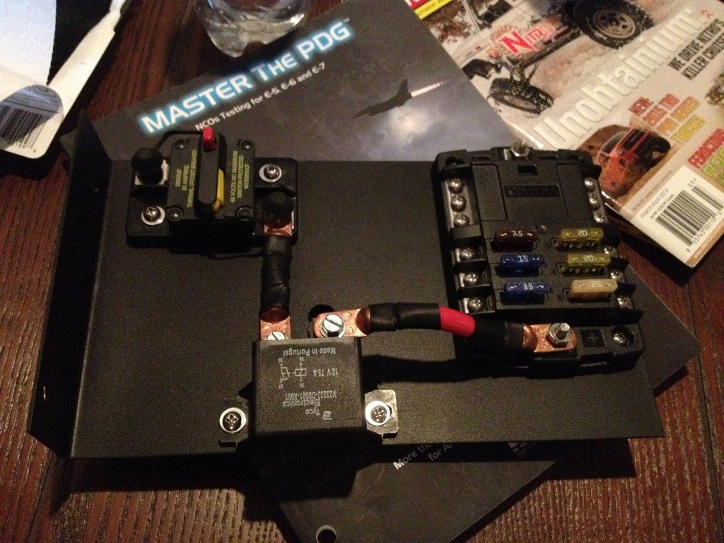

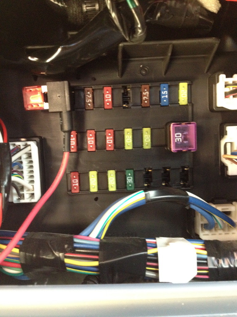

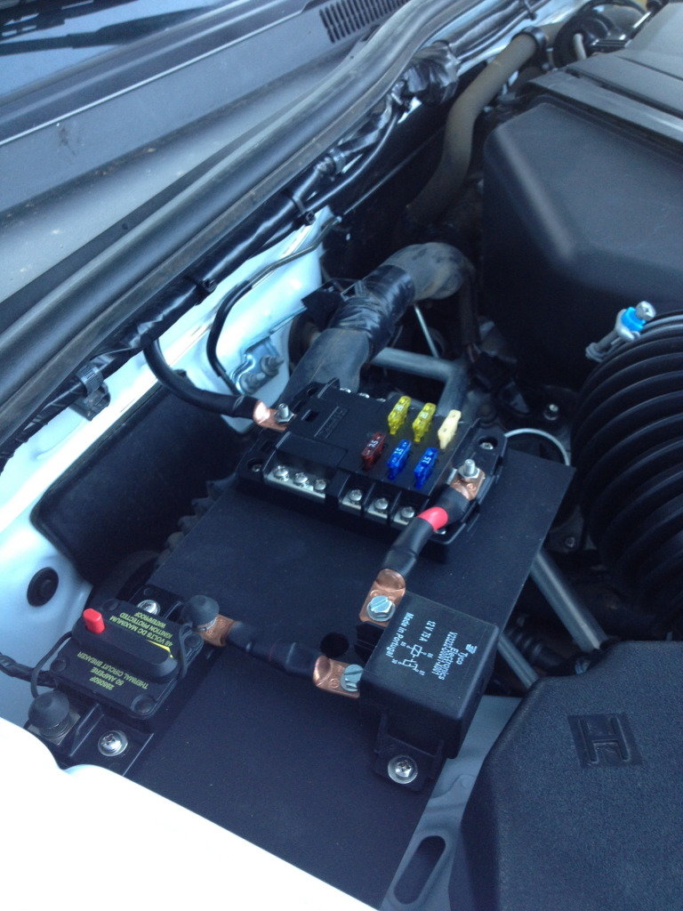

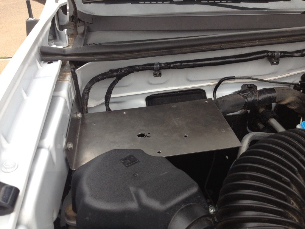

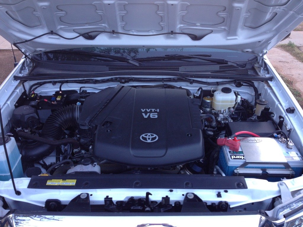

    So i wanted to have all my switched accessories (CB, GPS) come on with the ignition and look clean, so i whipped this up:
    Started with some 16 gauge (i think) and had it bend and put some holes in it:
    Then i added a Blue Seas fuse block and circuit breaker, along with a high current relay:
    Relay energizes from the ignition circuit, which is tapped into:
    Around the same time i also added a Diehard 31M. This battery is ridiculous. I put a dent in my fender just trying to lift it into place i shit you not.

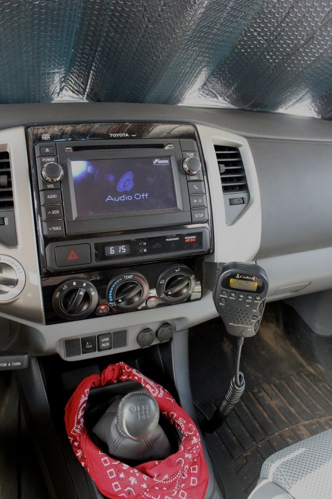

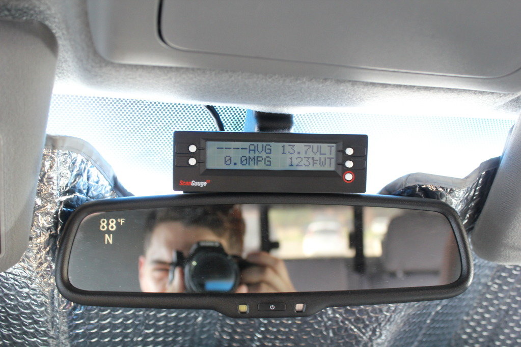

    Next I threw in a ScangaugeII and got my Cobra 75WXST hooked up. The CB is mounted to a Panavise dash mount which is really sturdy for what it is.

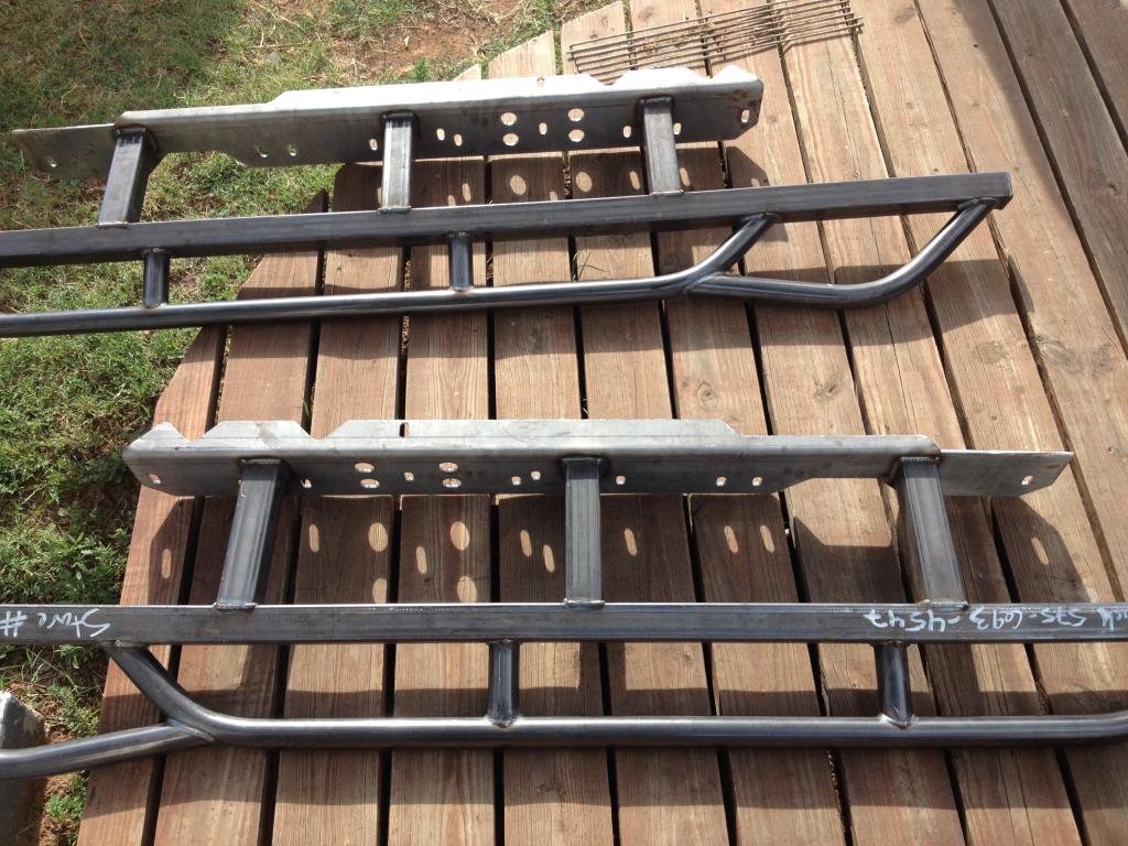

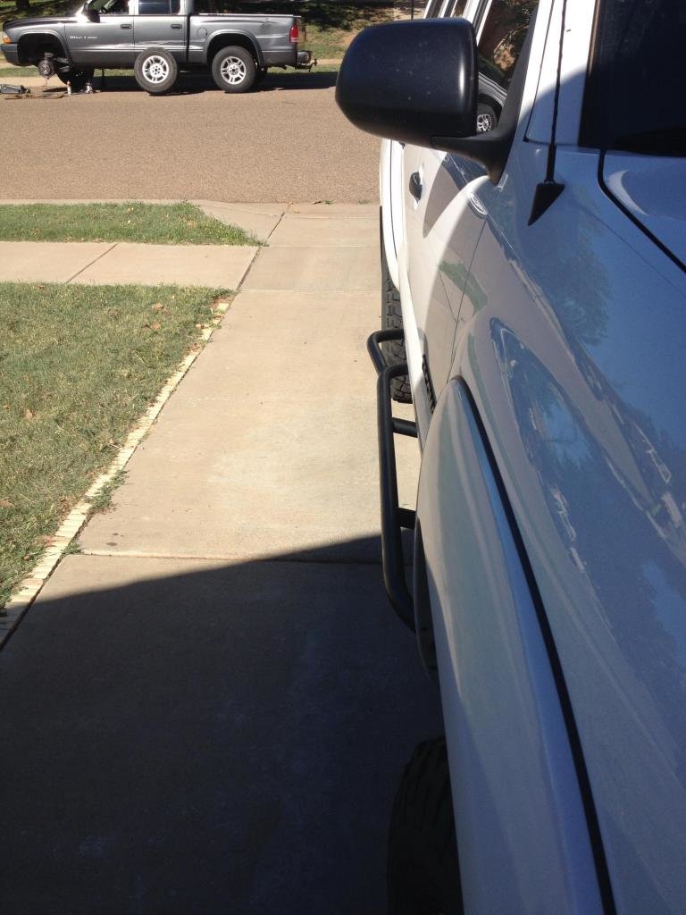

    Next I ordered some sick ass sliders from Eddy at SOS Concepts.
    Six weeks later here are the bolt on's with kickout:
    Rattle canned and mounted up:
    Me likey :thumbsup:

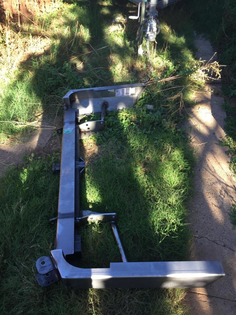

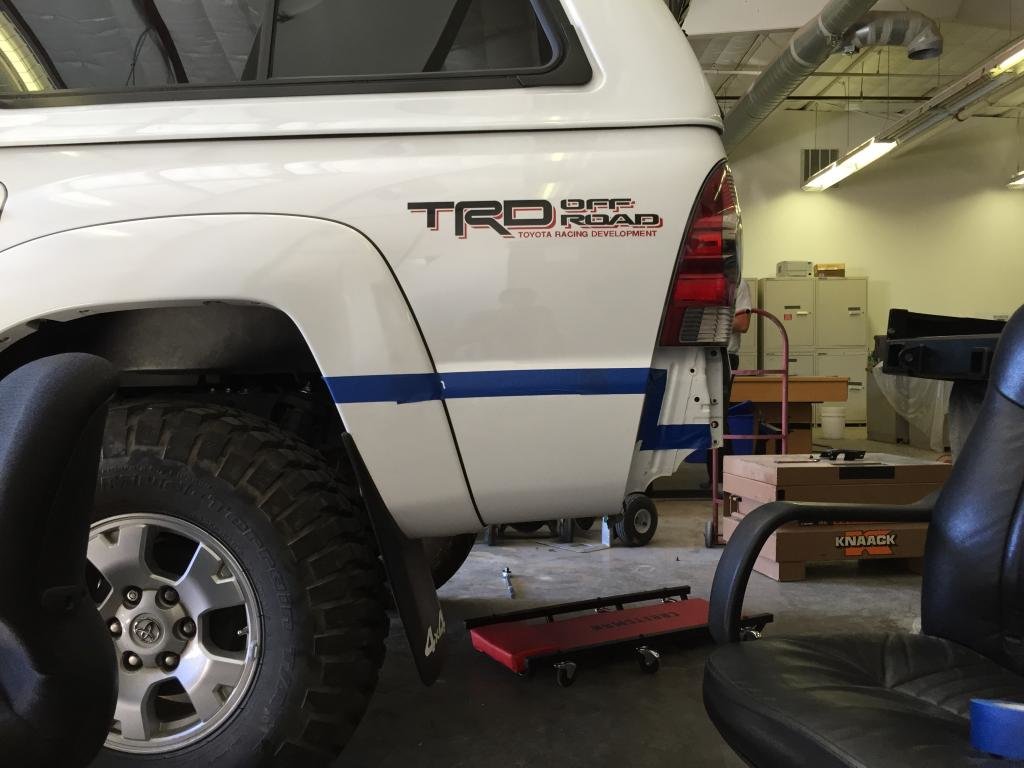

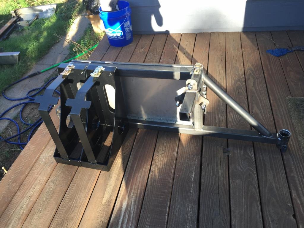

    ATO rear bumper time! I went with ATO because i feel they give the best clearance of any bumper I've seen, and i dig the simplicity of it. I felt really bad for the FedEx guy since i wasn't home and he had to drag 200 pounds of steel up to my porch.
    Time to make a mess of things:
    I just rattle canned this bad boy with some Rustolem. It came out pretty decently. Excuse the poor quality cellphone pictures, Ill get some good ones posted soon.

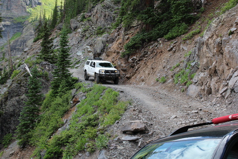

    Here's a few shots from my latest trip to southwestern CO. We camped south of Silverton, and spend the last two nights of our trip at The Camel's Garden in Telluride.
  20. Nov 4, 2015 at 12:12 AM
    #20
    TheGreatPear
    TheGreatPear [OP] Well-Known Member
    Feb 10, 2013
    #97218
    174
    Alex
    Gunsan, South Korea
    2013 DCSB TRD OR 4x4 V6 6 Speed
    Of course we had to hit Black Bear Pass
    I didn't get many pictures of the switchbacks, since i was too busy driving...
