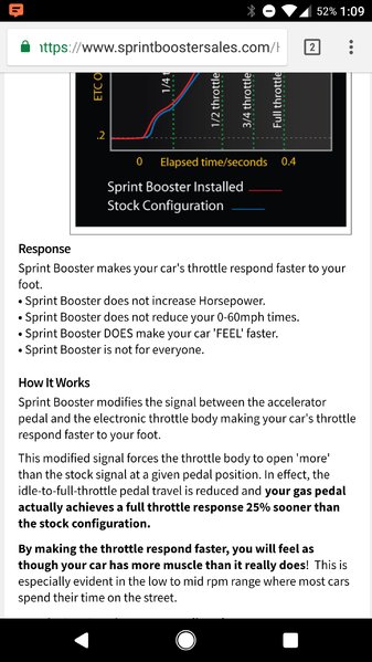

    There is no debate about it. Here it is right on there website. Also note they carefully choose words saying "throttle plate opens sooner in pedal travel" instead of "faster". Which is exactly what I have been saying all along. It is snake oil.

    snake oil means it's selling an outright lie, an empty claim, that the performance alteration claims are false.
    are you claiming that the obvious and not-at-all-subtle changes to my throttle response don't actually exist and my throttle acts the same without it? is that really what you're trying to say? i don't understand who you are trying to convince... of what. seriously.

    No, I am claiming that the box does not add performance as the well worded advertising leads you to believe. I'm not trying to convince anyone. I'm correcting improper statements made about performance, acceleration, etc.
    Actually, yes I'm saying that your throttle response doesn't change. Your throttle PEDAL response changes. Close, but not the same. I think that is what you meant though.
