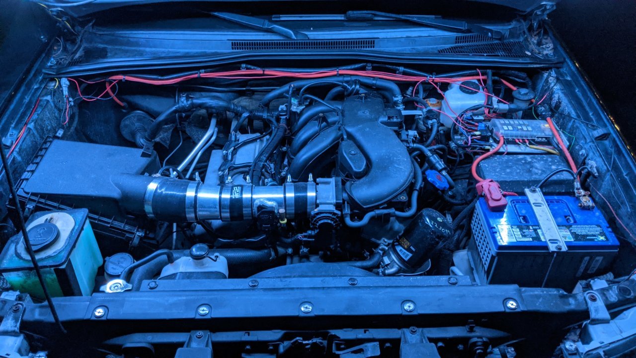

    They seem kind of pointless in a manual trans I would imagine?
    I don't have noticeable throttle lag in my truck under normal driving at all but then again I have a much more direct and open intake.
    I have considered do the pedal angle mod which tilts the bottom of the pedal up a bit giving a fuller travel, allows you to "bottom out" the pedal stroke without standing on it pushing the pedal into the carpet and makes heel-toeing a little easier.
    Only time I noticed any throttle lag is when heel-toeing as it kind of freaks the computer out as it confirms you really do want throttle when actually on the brake as well and then it's only a half second at worst.
    Factory intake routing is awful, upgraded to a FJ cruiser airbox.
