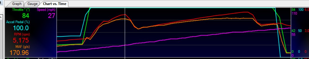

    I have been looking at your 'data grab' for a while now and there's something I don't understand. If the blue line is the pedal and the green line is the throttle blade, wouldn't the space between them be lag? And why does it look like the throttle is closing before the pedal is released toward the end?

    average lag i have seen (space between them) is about 50-100miliseconds (less than 1/10th of a sec) between throttle blade vs accelerator pedal. For logging I have those data points scheduled to be logged at 10hz (10x a second or every 100ms). Updated Data from the ecu doesnt come in exactly at the same time so often times you will see what you describe, essentially the throttle pedal started moving down but it was JUST after a data point had been logged and the throttle blade angle was closing got logged.
    Needless to say, the image is to show there isnt a lag between pedal and throttle blade.
