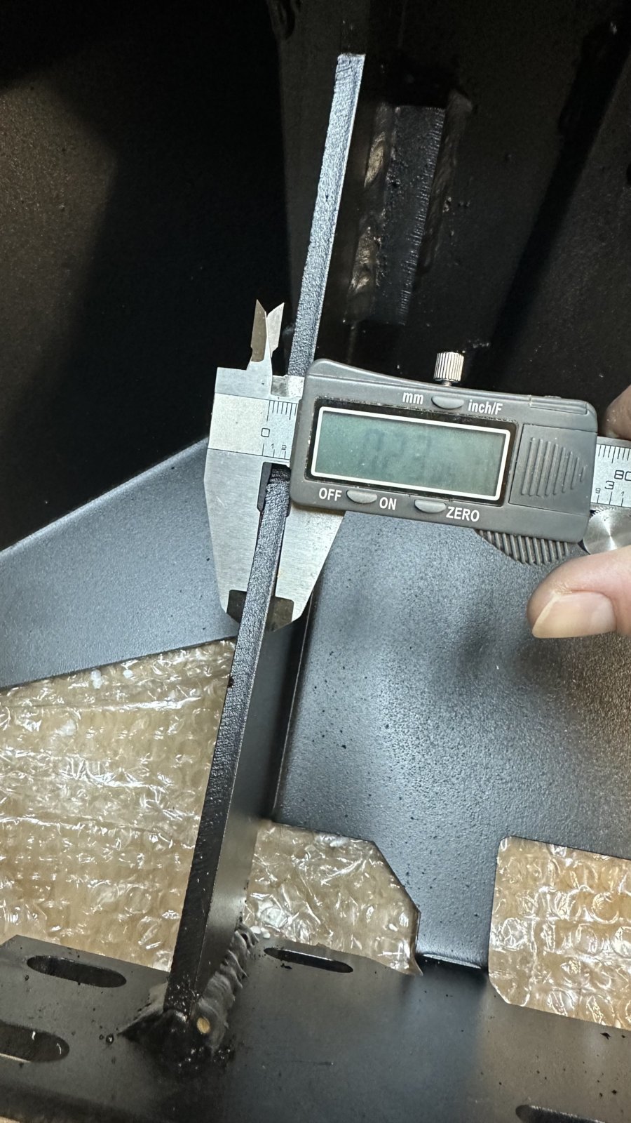

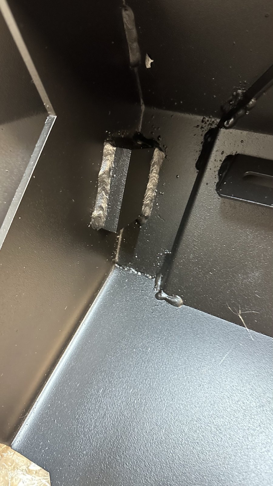

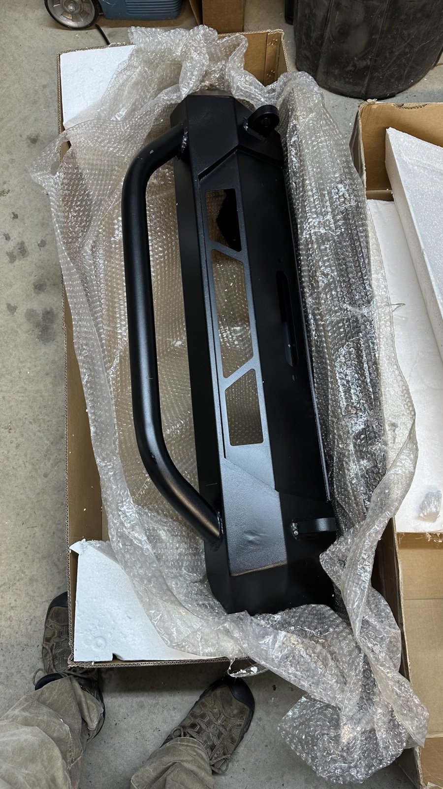

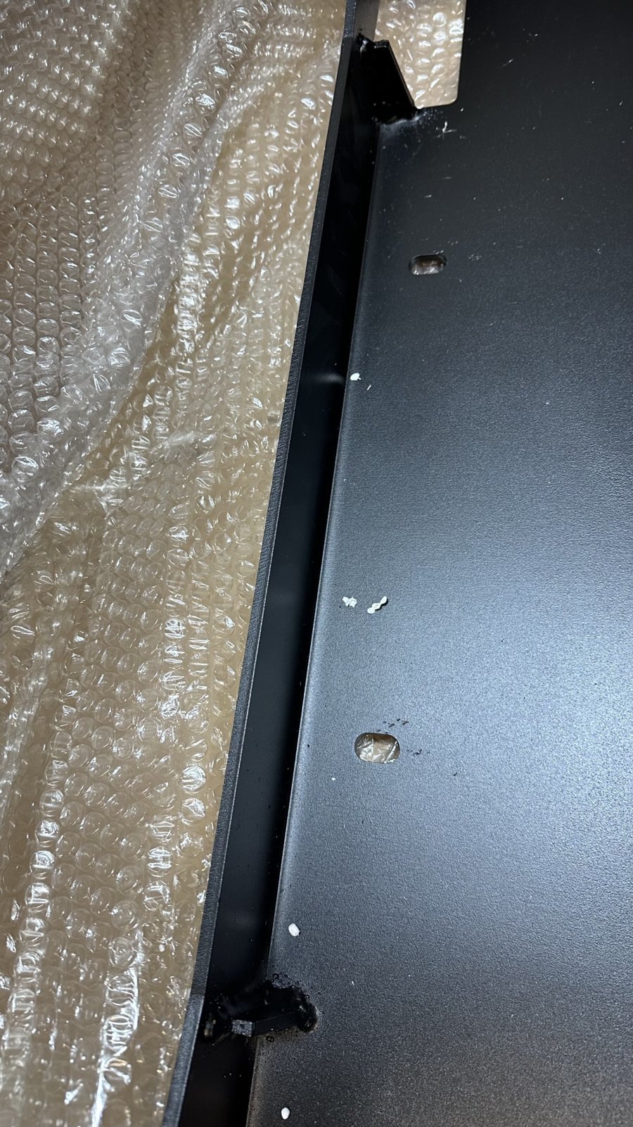

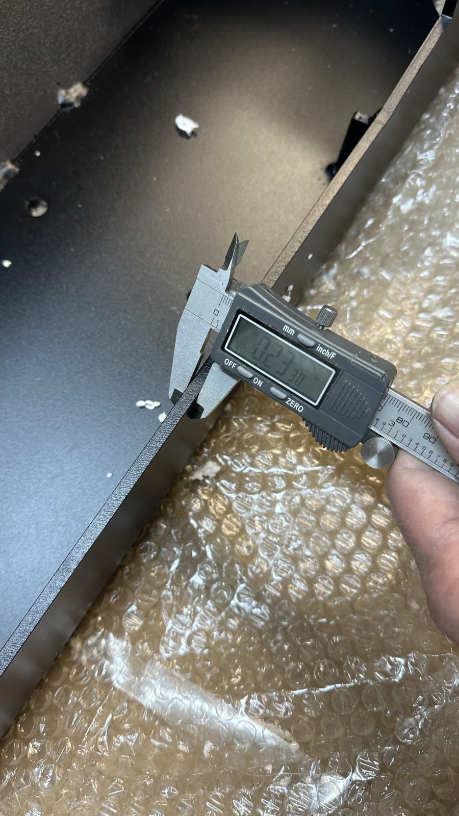

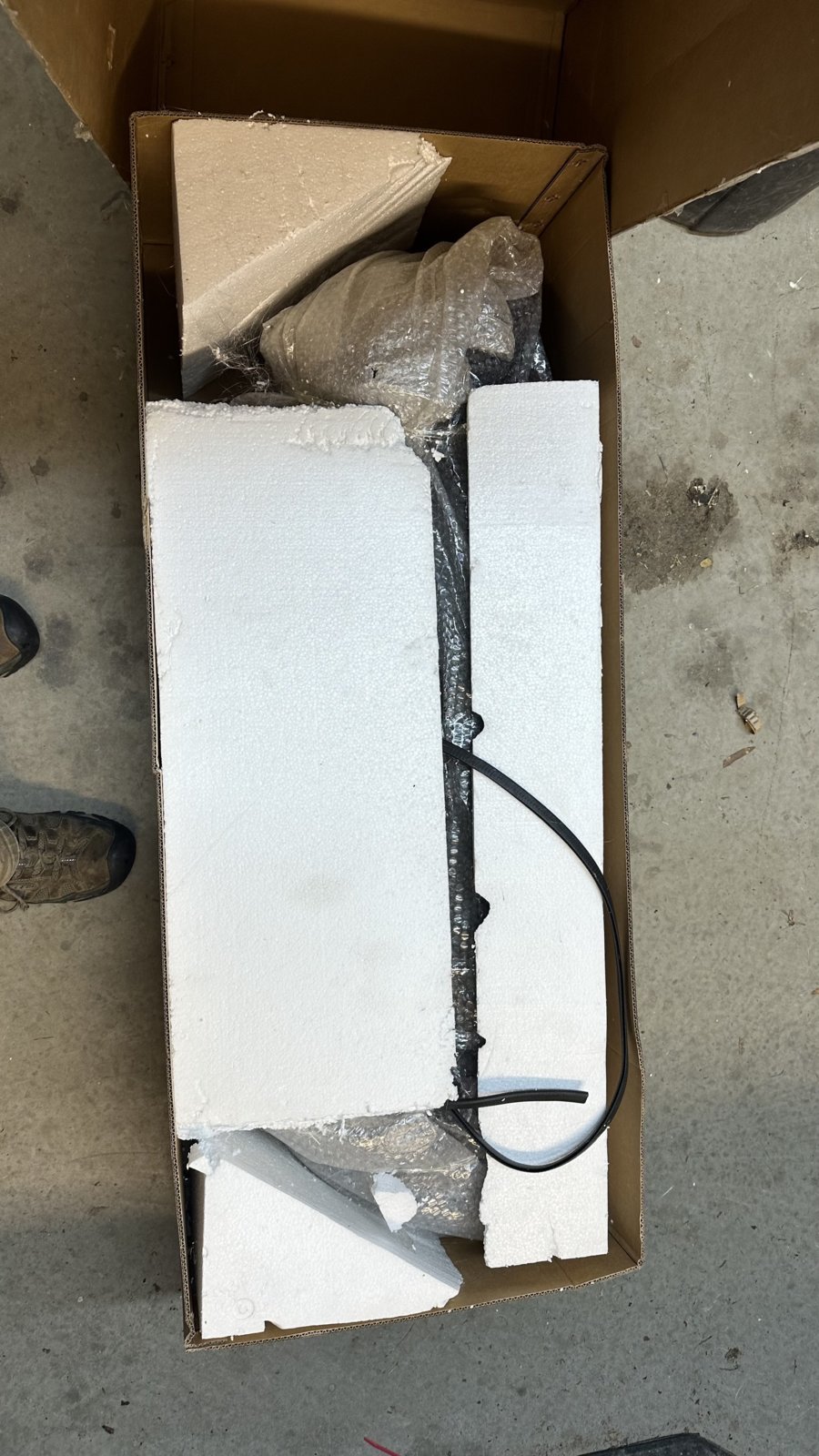

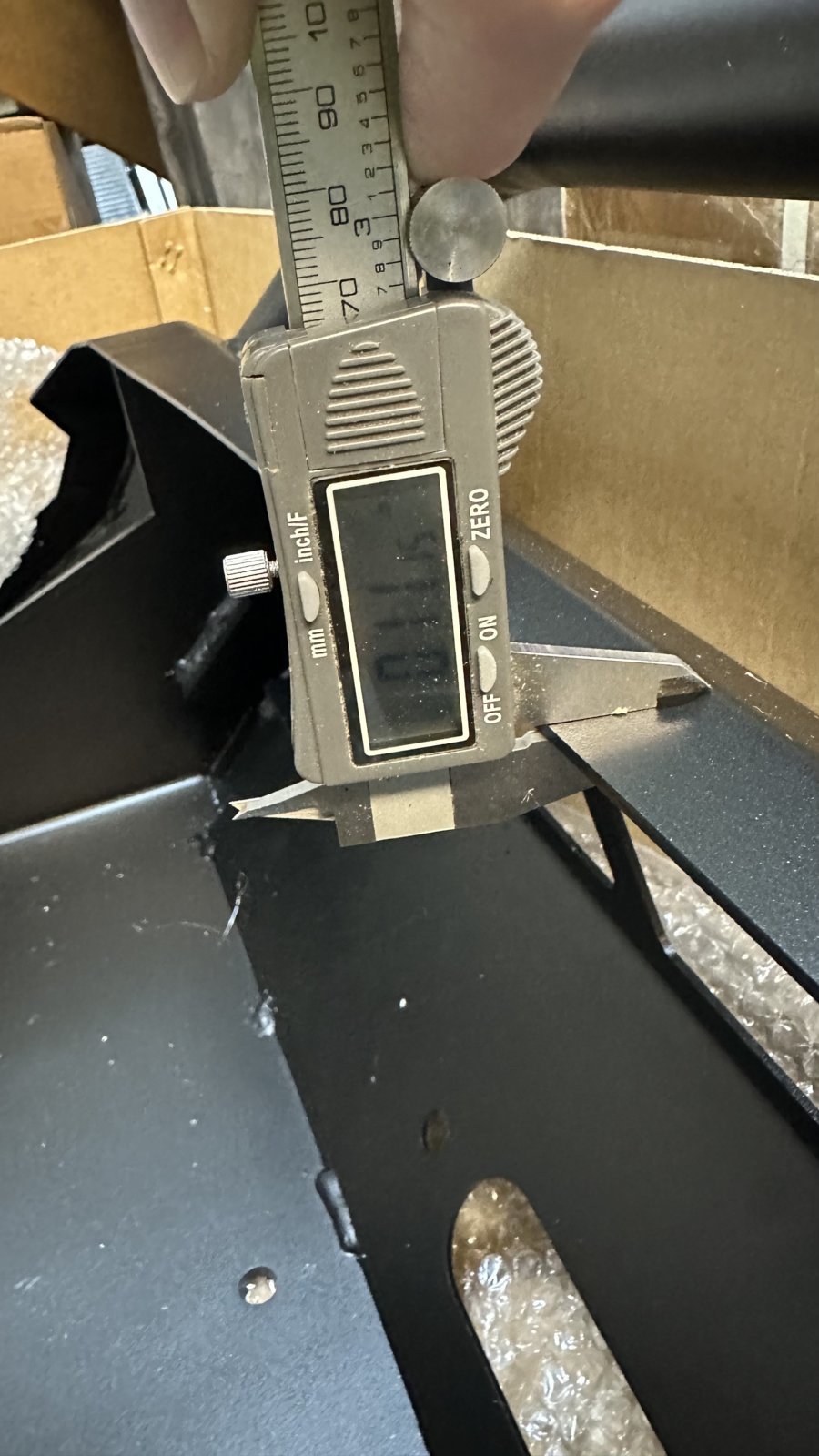

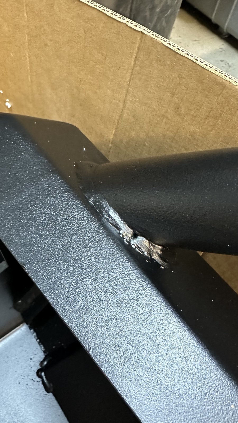

    Just received the BA knockoff bumper. yeah, some blems on the finish and the welds look like something I would have done in trade school but it's not terrible to me. I guess the steel thickness probably qualifies but it's not exact. Anyways, here's the pics...IMG_0867.jpg IMG_0868.jpg IMG_0869.jpg IMG_0870.jpg IMG_0873.jpg IMG_0876.jpg IMG_0877.jpg IMG_0879.jpg IMG_0880.jpg IMG_0881.jpg IMG_0885.jpg

    Definitely looks like it could use some extra bracing and better welds.
    Edit- and, like most bumper of this type, a set of frame tie-ins/reinforcement brackets e.g. C4Fab's

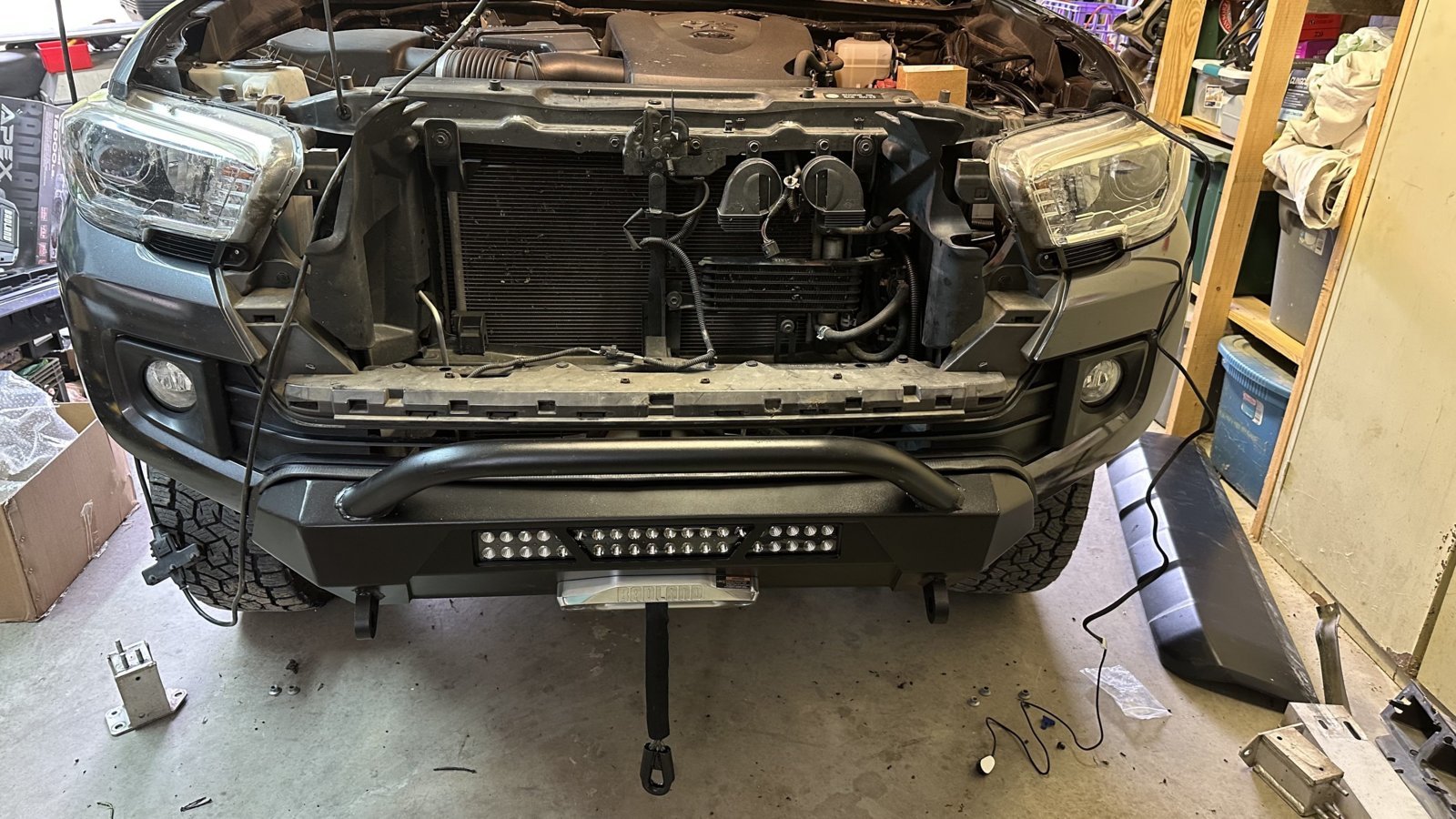

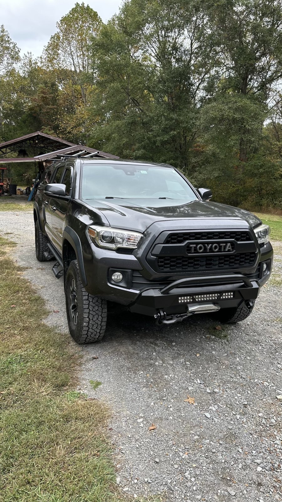

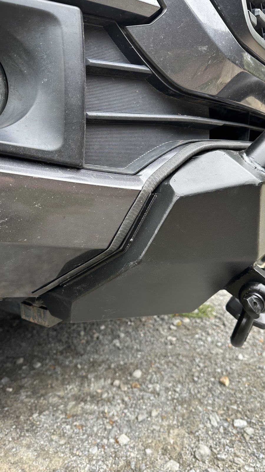

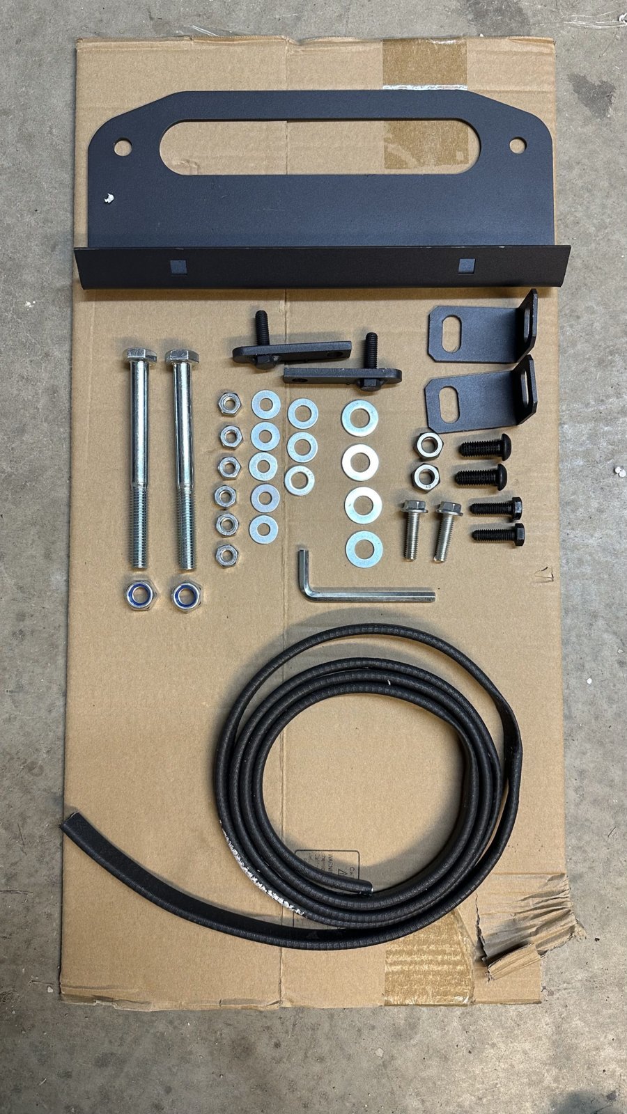

    Install was pretty straight forward. Followed the BA instructions and multiple youtube videos. Everything lined up pretty well. No issues on the fitment. Badland Apex 12k winch fit nicely behind the grill and no remoting of the control box or mods of the hood latch support. Only concern I have is the fluid cooler re-location brackets. Passenger side bolt head is extremely close to the tube. And you don't replace the bolt you must remove from the top of the frame that secure the cooler lines. But that's with the BA version as well, so no secret there. Other than cosmetic, I don't see the difference from this one and the BA Hiline. I'll touch up the scratches before it starts rusting, hopefully. IMG_0895.jpg IMG_0896.jpg IMG_0897.jpg IMG_0899.jpg IMG_0900.jpg IMG_0901.jpg IMG_0902.jpg Just hope it doesn't break...

    overall are you happy with it? It looks good (except the welds..) but makes the truck look awesome
  11. Oct 17, 2023 at 5:39 PM
    Rollo67
    Rollo67 [OP] Well-Known Member
    Dec 6, 2017
    #237786
    169
    Yeah, happy for now. Ascetically I think it's fine. and I'm sure it'll handle what I put it through. I'll try and put the truck in a precarious situation this weekend and stretch the line. Will post after action report.
