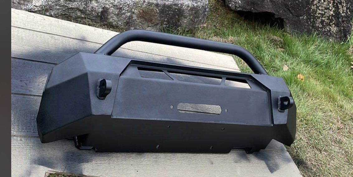

    The reinforcements are to keep the thin plates the mounting studs are attached to from flexing and cracking on really hard/repeated pulls - think being sunk halfway to the window in peanut butter mud where you are pushing the winch near it's limit. Most scenarios you are using a winch are not likely to require that much force to get you free.

    A slow pull, even a hard slow pull, like your scenario isn't super likely to damage the frame/mounting points, but pulling/being pulled by the two shackle mounts at cross angles will put a lot of stress across the two vertical ties between the mounting plate "feet" and the winch/bumper base plate. Even a couple extra ribs welded in would do a lot to strengthen the bumper. But that's extra metal and extra welding, for the price, it could be worth stripping the coating and adding them in yourself if you were worried about it.
    The bigger concern would be someone trying to use something like a kinetic recovery rope/strap on the front shackles. Might get away with it once or twice.

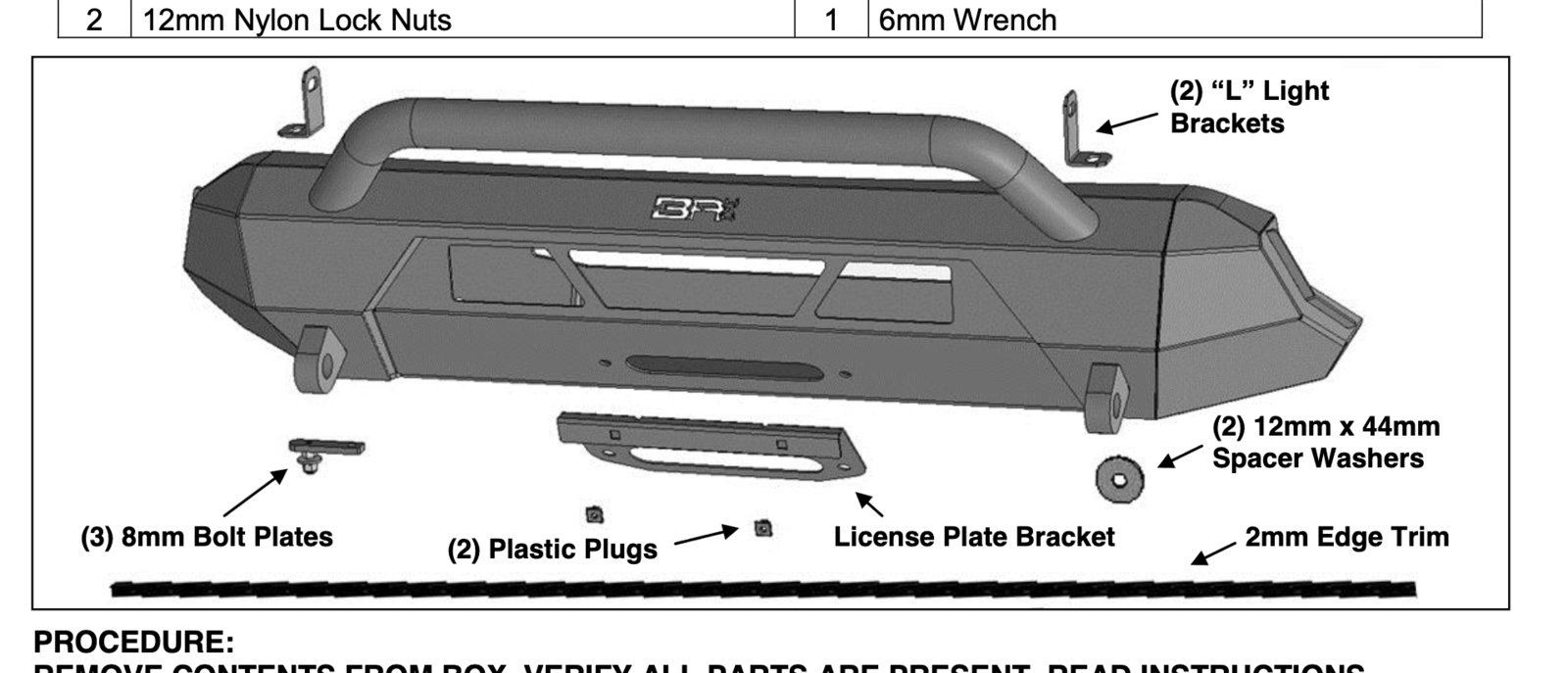

    Be prepared to use shorter bolts or spacers from the bumper bracket to the light. I used a nut with lock washers on both sides as a spacer. Time will tell is it works, but it was kind of a PITA to get it adjusted properly. My arms were at maximum length to be able to reach behind the grill. Granted, I'm not that tall...

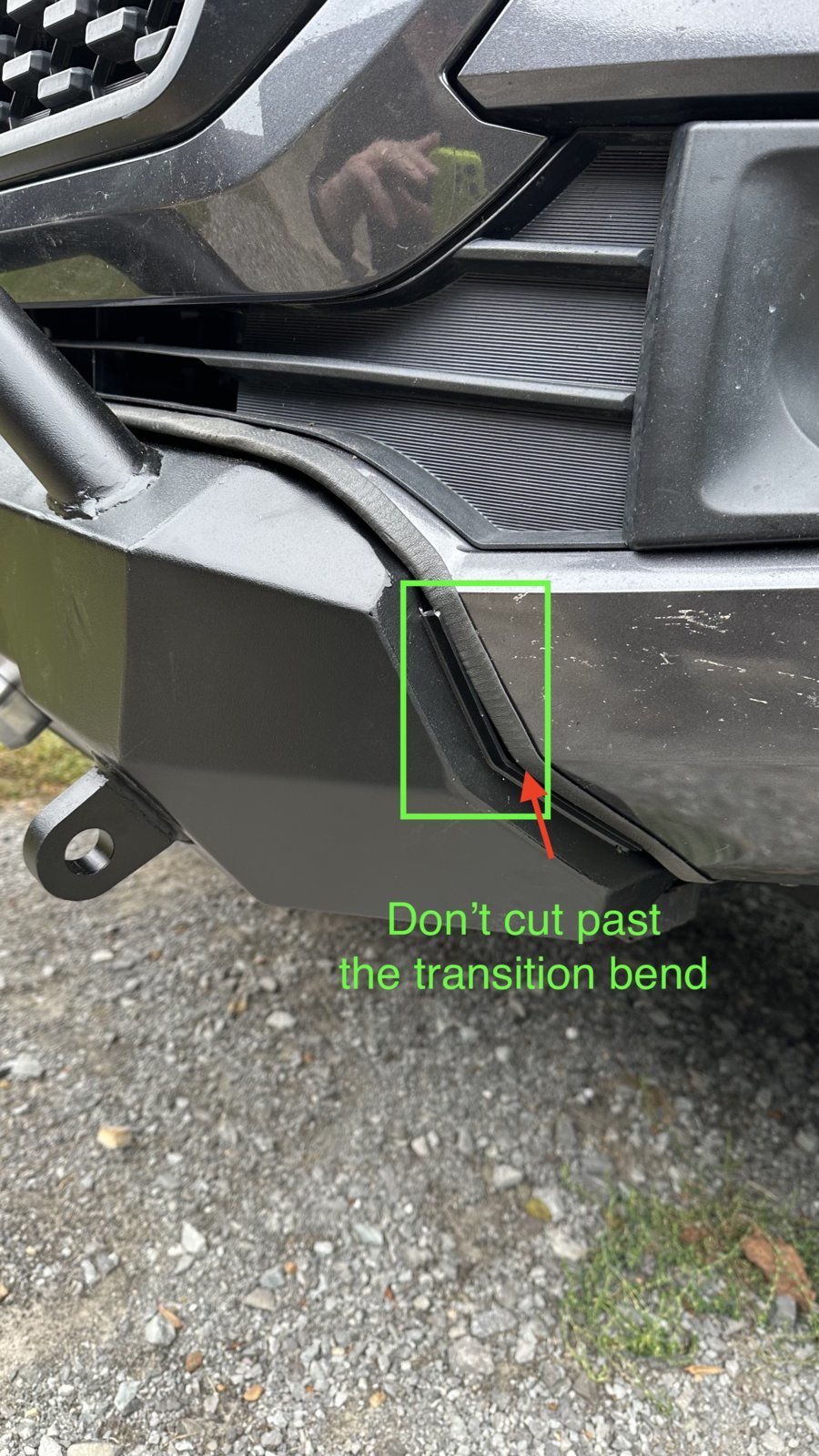

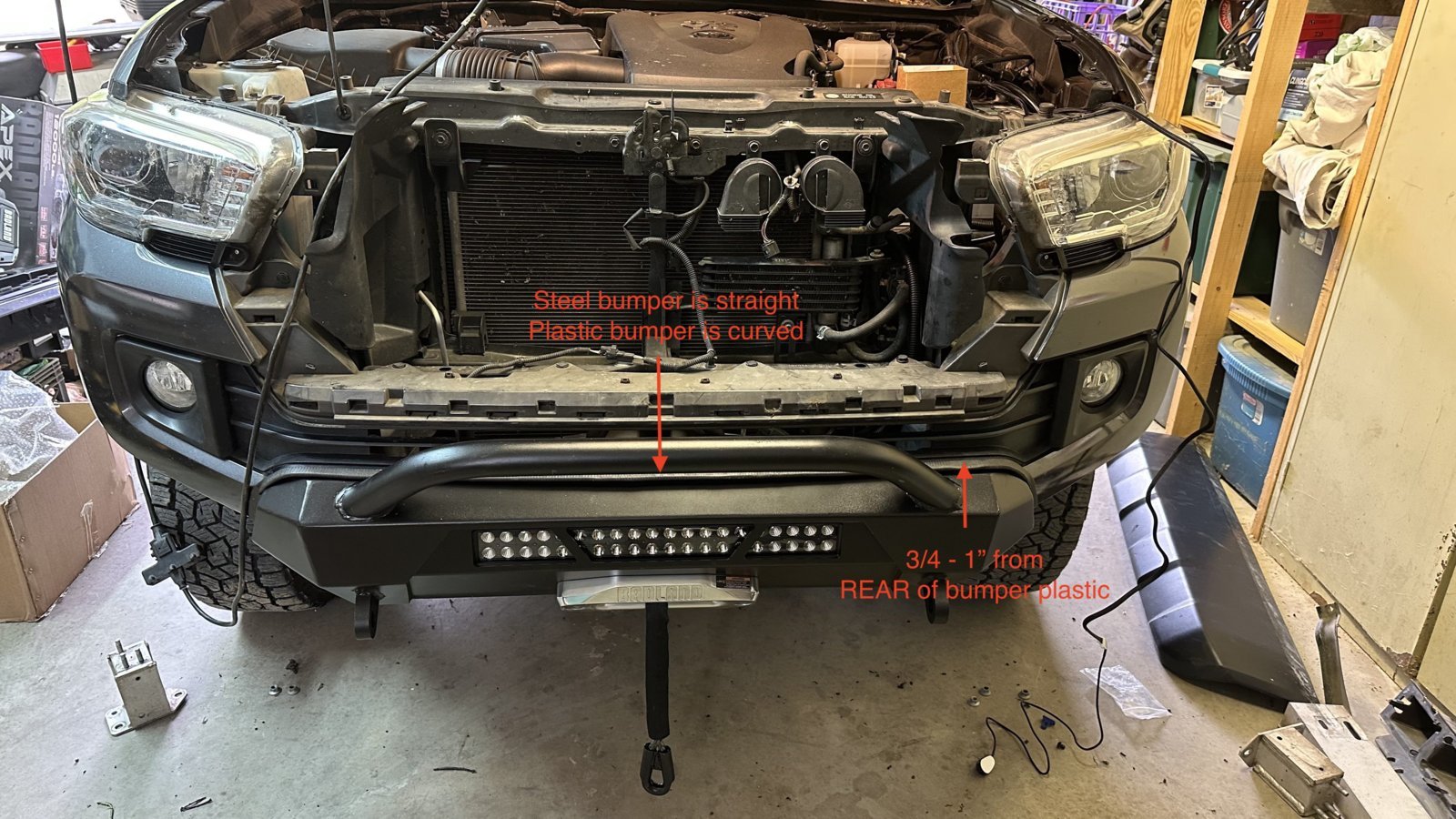

    All the tutorials say to start your cut 20mm (3/4") from the front edge of the plastic, and to be conservative. So I started with that. Honestly, this was the most time consuming part. There are multiple factors that will determine your outcome. One is you are dealing with plastic. It's not held on to the truck very well to begin with (as most modern vehicles), so one side may be slightly different from the other (mine was). But only relative to were it sits to the frame, which is where your new bumper is going to be mounted to. Just tape, mark and start cutting. Test fit after every cut to see how it sits. But make it slightly snug to fit. You don't want to cut too much, especially on the sides where the little tabs on the outer edge of the steel bumper are. Those, I believe, are designed to keep the remaining plastic bumper in place since you've just whacked off it's lower support. The top, however, has plenty of plastic to cover the steel bumper. Just make sure that cut is nice and straight. You'll see in the pics a note about the curve in the plastic bumper that compares to the straight steel bumper. It looks kind of weird to me. So I don't know if I'd try and make that cut parallel to the truck (like I did) or to the steel bumper. However, I did end up cutting about 3/4" from the REAR of the plastic edge, not the front. Your results may vary...
