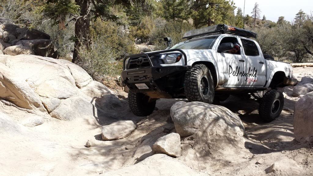

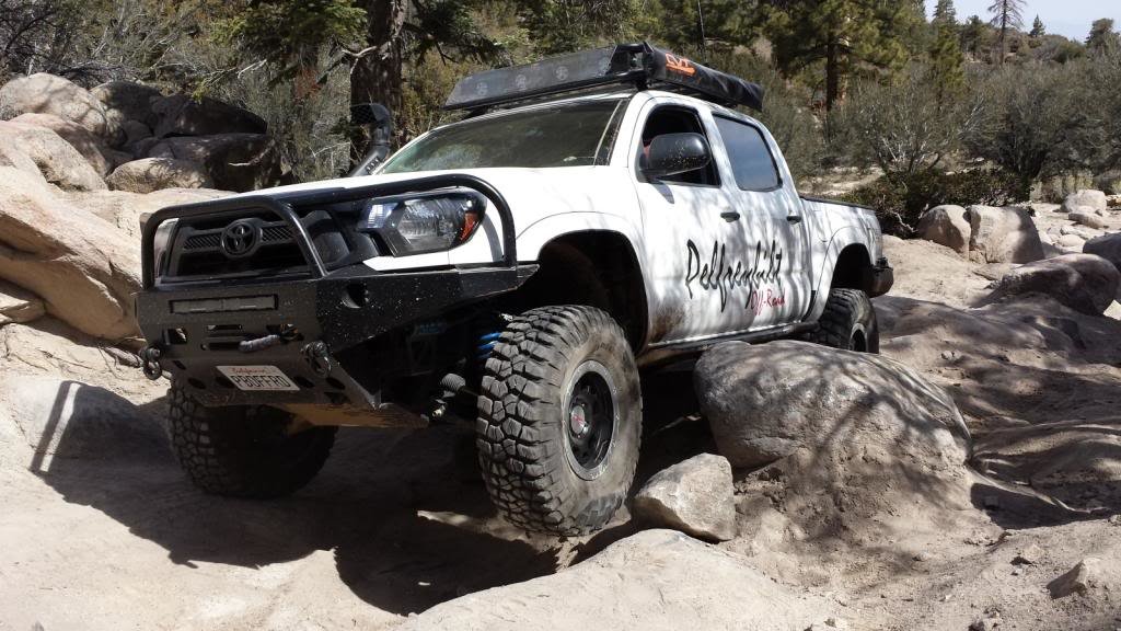

    Showing off the droop from the rear shock kit, dumpin out 35's

    Sliders doing work
    Posin with the monkey

    That's a great pic! What's your strapped travel # in the rear?

    Basically uses up entire 12" shock, strapped a hair short of full extension.
    Bump height is basically same as stock, that's where the springs are happy. They have droop left to spare if you allow them, stick shock location is the limiting factor.
