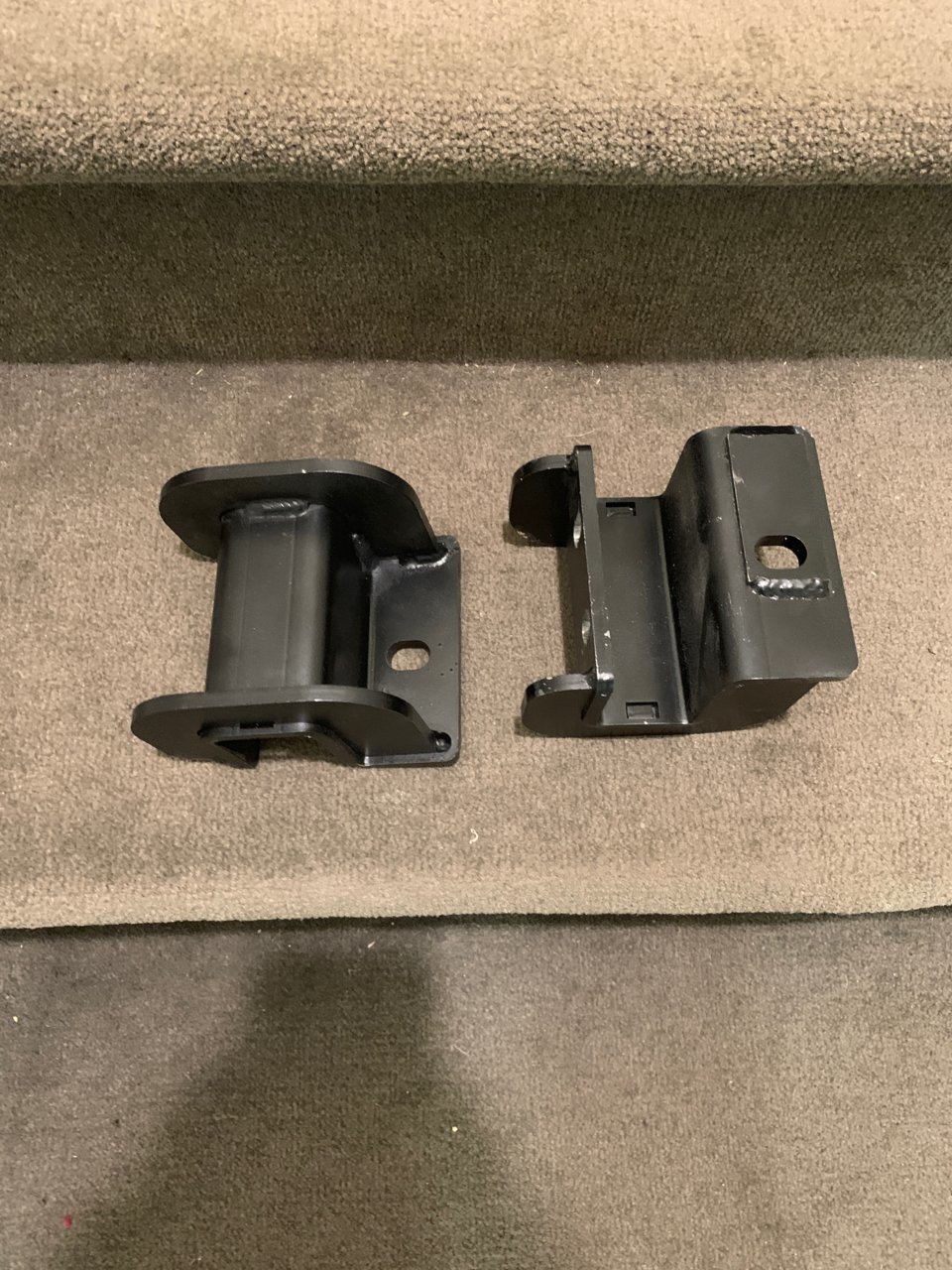

    Not mandatory but highly recommended. Its a frame reinforcement bracket. Provides a better hold that just the 6 nuts that the crash bar is mounted to. Even more highly recommended if you plan to run a winch.

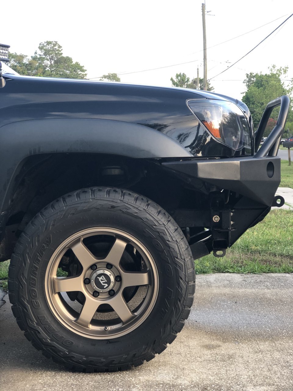

    Yes. The two holes go over the leading bolts where the crash bar was mounted originally and the long bolts go through the single hole and through the frame. It kind of cups the bumper I’ll send pics and links.

    To give you and idea. I can take better pics after work.
