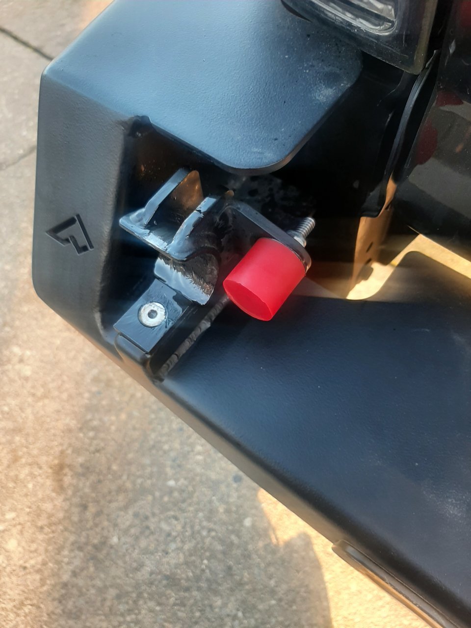

    Found a bump stop that works well and will hopefully hold up a little longer then the black rubber one. I did have to drill the hole slightly larger for the stud but overall bump dimensions are the same. It's poly so a little more stiff, little more closing resistance. I'm happy with it.
    McMaster-Carr part# 9546K185

    Nice! Thanks for the info.
