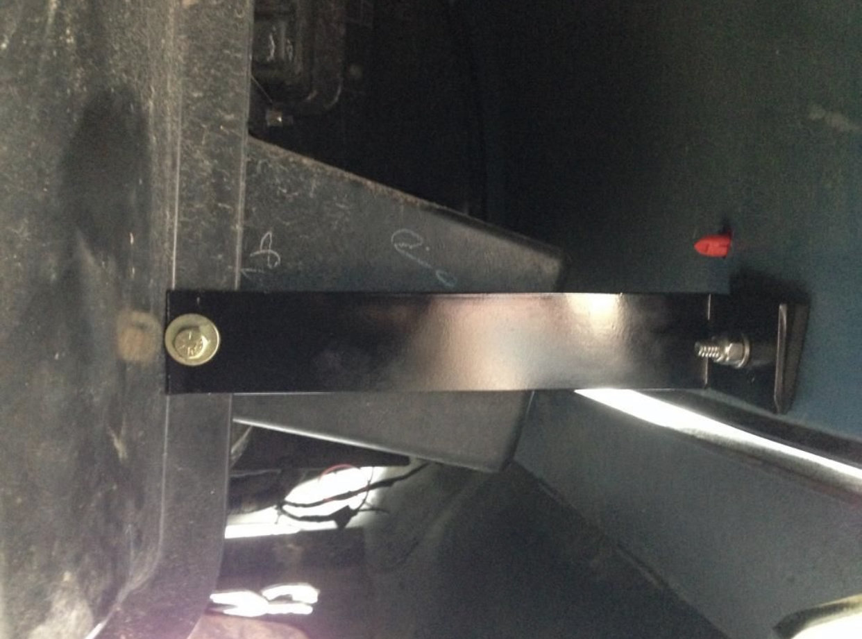

    Here is what I made, just a simple L bracket. The bolt that holds it to the fender is behind the flare. I put some EDPM rubber stripping between the bracket and fender to keep the paint from rubbing off.

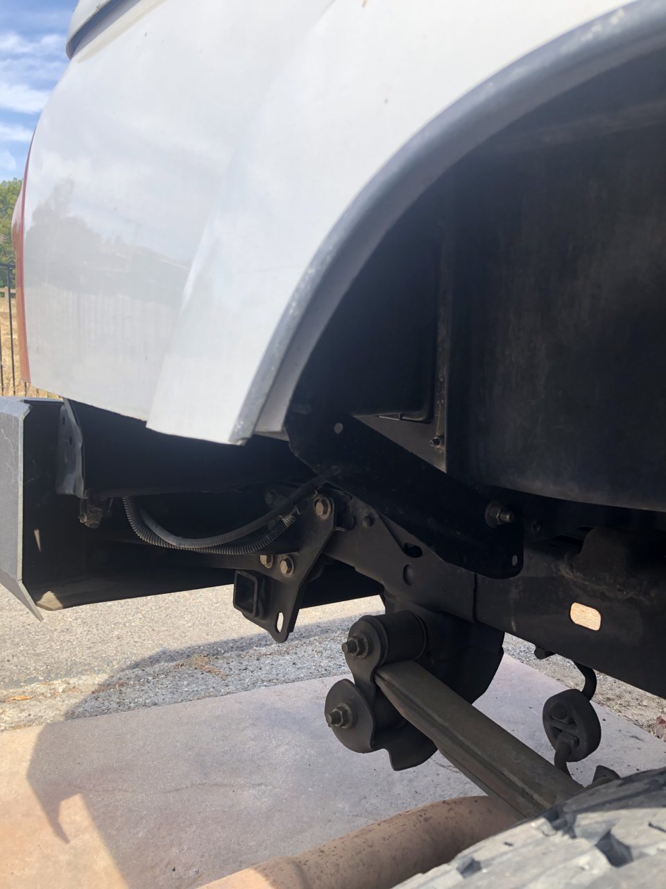

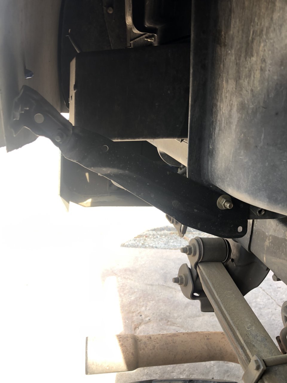

    I re used the stock ones, cut them to where it won’t hit a HC bumper and I might have swapped the sides I’m don’t remember
    485DD835-72AE-40FE-870B-64E58D53FFE6.jpg 4C3CCD4A-222C-48AC-96BB-1536FDF94188.jpg

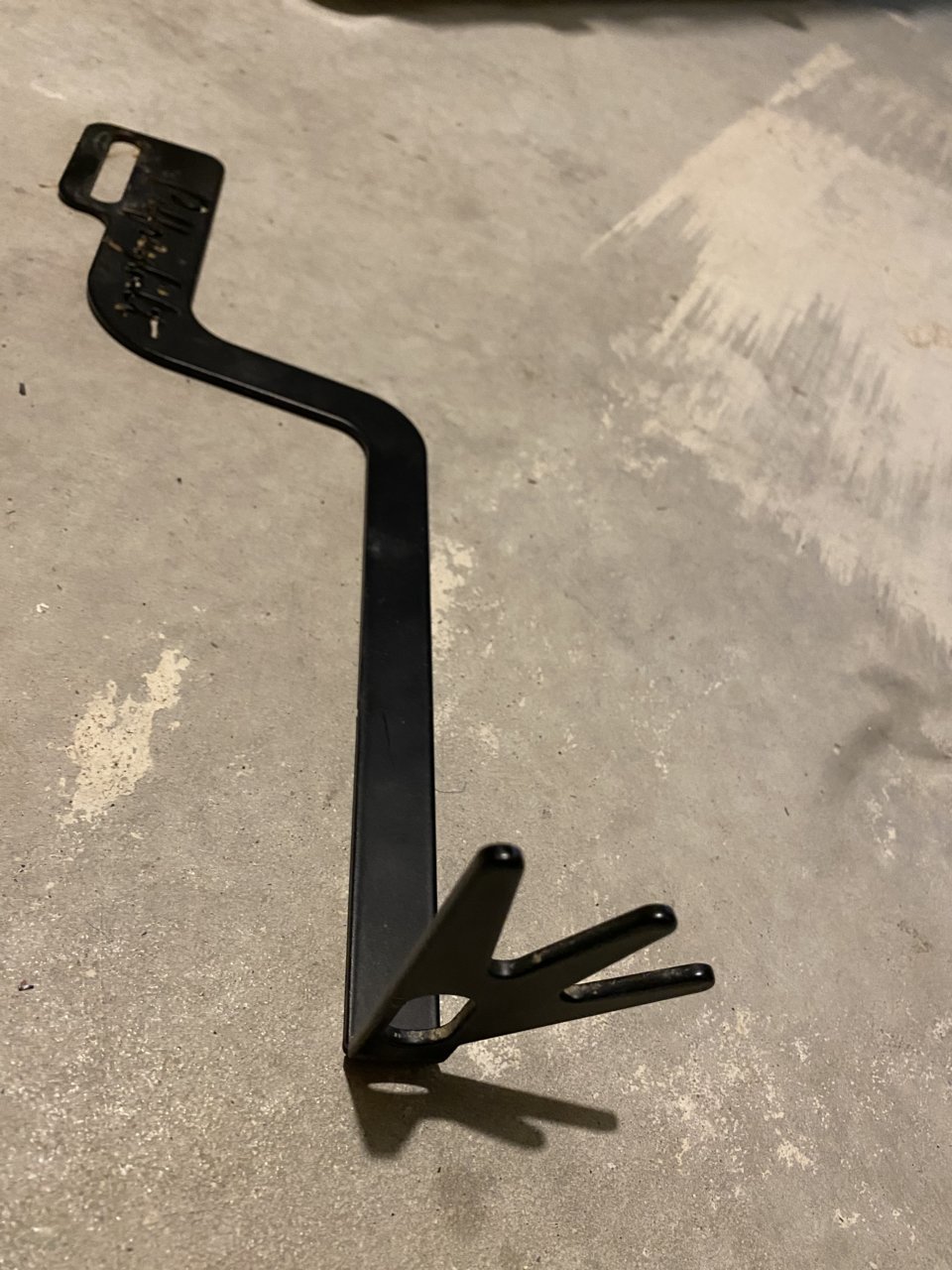

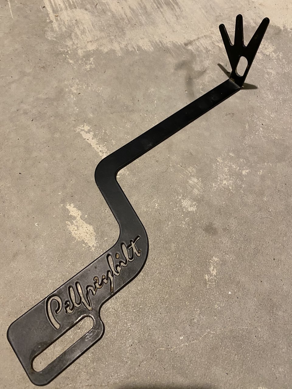

    pictures of the pelfrey supports that came with my hc bumper
    been meaning to put them on now for a couple years... been lazy keep telling myself my fenders are more dent resistant
    but now i have a crack forming from all the dumbo ear flopping around during highway driving

    That pelfreybilt bracket is way more trippy looking than I thought it would be haha. Thanks for all the responses guys

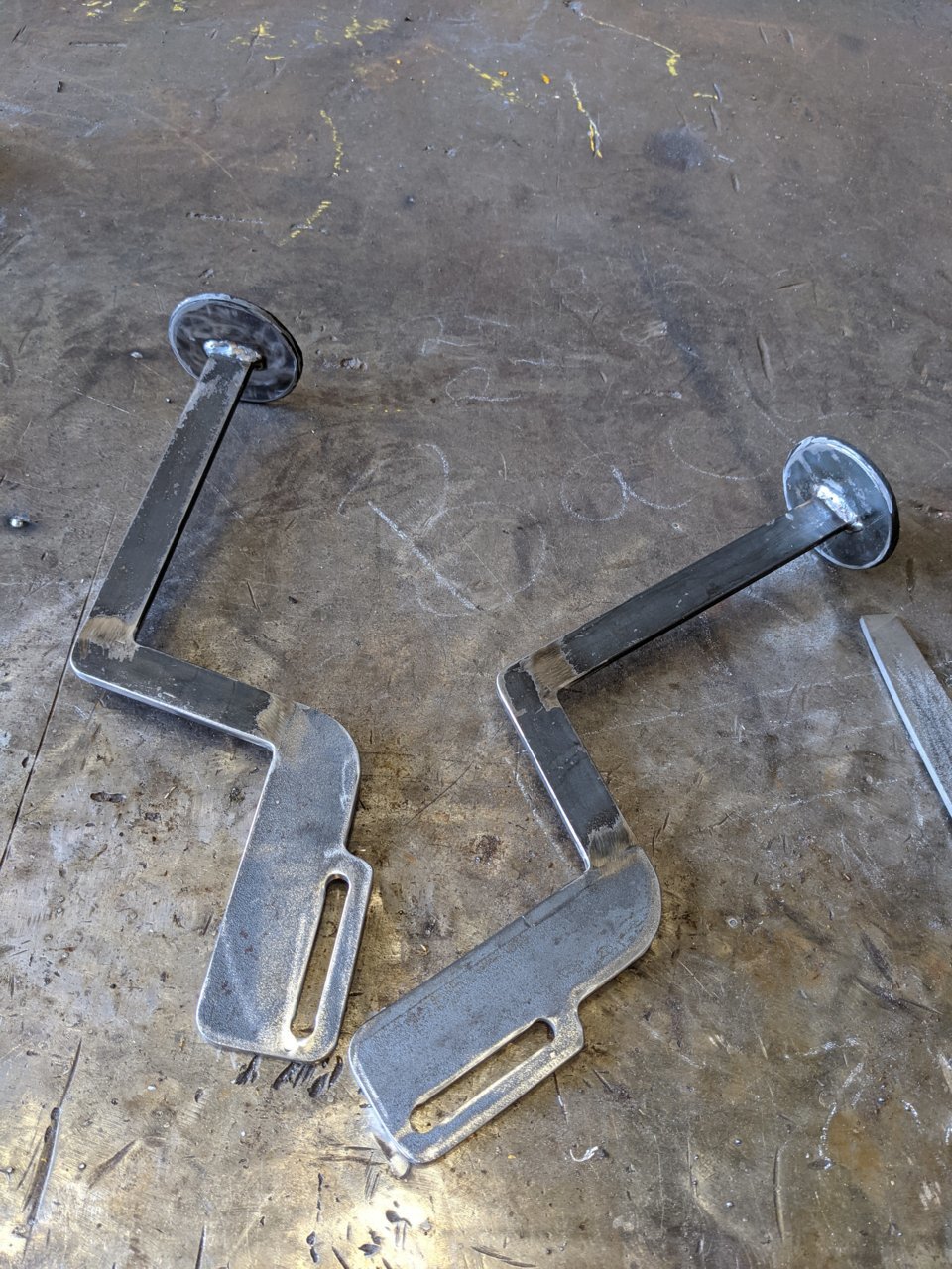

    Here's my variation. A coat of Steel it and I'll mount em up
