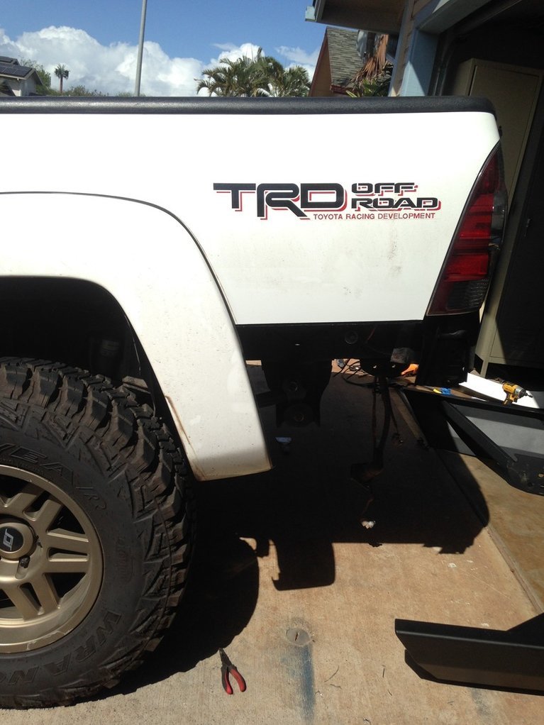

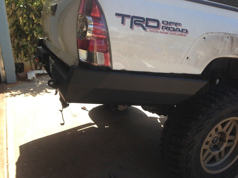

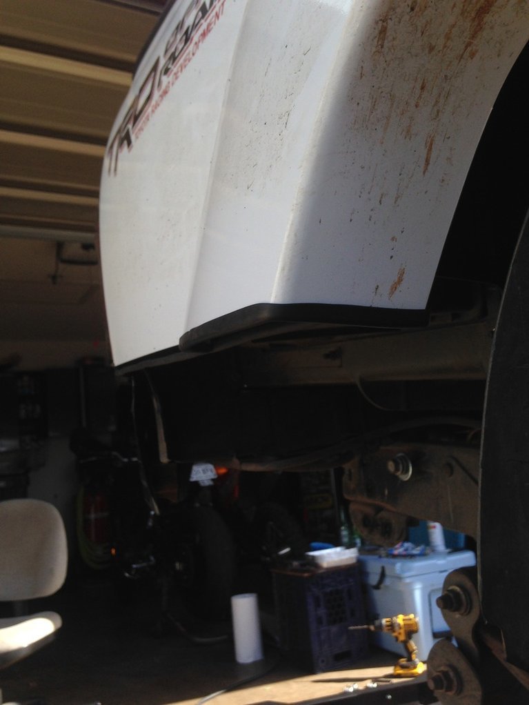

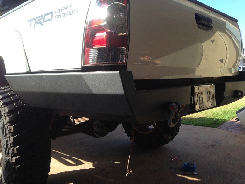

    ok, for u guys who got H/C. 1/2" below the tail light is perfect. Its roughly 17" from that point to the bottom of the plastic tailgate cap. The absolute hardest part of the install was removing the first flare. those stupid plastic clips are a mother fucker. once you figure out how to bend the wheel well liner and maneuver your hand, its cake. it was a lot of fun and I am super stoked on how it came out.
    mock up

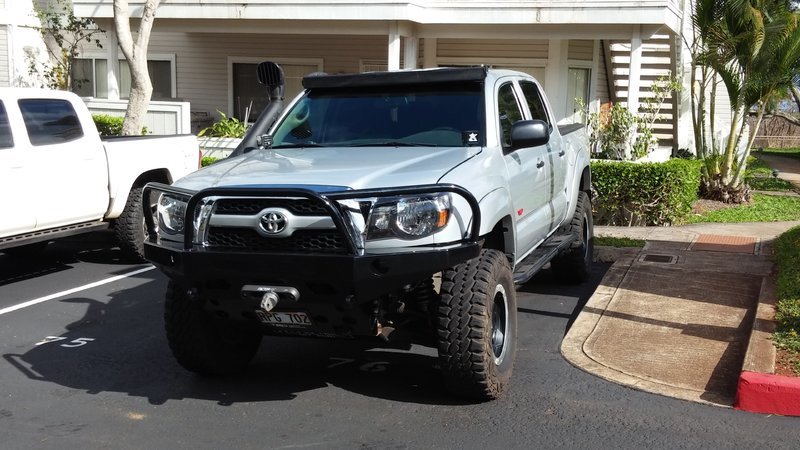

    Added close to 200lbs to the front of my truck...

    Sweet Ron, even got a winch on there too.

    Yup..changed to poly front bushings too...thank goodness for 700lb springs..maybe should have gone to 750lb. Lol

    What a beautiful taco! :thumbsup::bowdown:

    What winch did you go with?

    Smittybilt 10k synthetic
