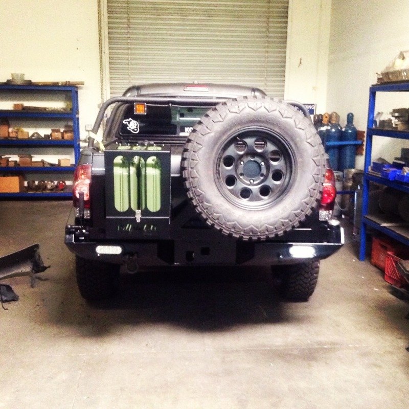

    This product made me realize just how great Tyler is to work with. He made everything exactly to the spec I wanted on the swing arm; dual nato fuel cans,
    spare tire, & a hi-lift mounted along the bottom. Its built stoutly, welds are great. Lots of research went into this product. It differs from the photos Tyler has on his site because he switched from rounded tubing to squared tubing for strength and ease of welding I believe. On the hidden hitch Tyler welded on brackets to be able to attach a chain easily which is great. The mounting points sort of matched with the truck which I understand as most bumpers require alignment just like factory ones. The latch and the swing arm canister/bearing are beyond sturdy. The latch that holds the swing arm open caused some issues for me. Both Tyler and I think that he got a bad batch from the manufacturer of that part since he hasn't had any issues with it with any of his other clients and after sending me a stainless steel one I haven't had anymore issues. I went through 2 of them before we made the change. Great thing about this issue is Tyler had a new one out for me the next day and then immediately after he got the stainless steel one in stock.
    *PROS*
    - stout
    - built well
    - Tyler will work with you on any accessories for the bumper
    - sturdy latch and swing arm bearing
    - Tyler can put any back up lights you want
    - Great hidden hitch
    *CONS*
    - I wish I wouldn't have powder coated it and painted it myself. The latch has knocked some of the powder coat off and it rusts where the swing arm is attached. Easy maintenance but not a fan of the fact I have to paint where it was coated.
    No significant cons regarding the design or issues. If you want to powder coat it go for I would just figure something out to place inside where the swing arm attaches and is latched in.
    I can't say anything about the installation because I was lucky enough to have Tyler install the bumper personally. He is a perfectionist and it shows both in his products and in his installation. Tyler even included come foam padding for the gas can mounts so that they don't move or rattle while on the trail.
    -Some tips when ordering-
    1. Call Tyler or Satin, they will work with you on the design you want.
    2. Go with the recessed rigids, trust me. If I ever get around to it I will fill the holes for the lights I have and put rigids in because the ones I have installed suck.
    3. Don't be scared of the first cut, it'll be worth it once the bumper is installed.

    Pics???

    7917CF41-B89D-482A-AA22-201E72B6CA1C-849_5a29901868af19278d35c7a1a70a57ac1edf62d3.jpg
