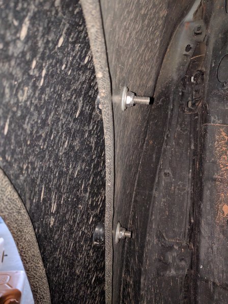

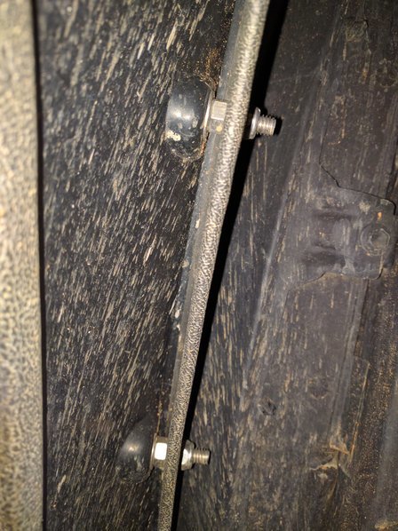

    Hey Tyler, random question for you. I noticed the trimmed fender flares and was wondering if you could show the backside of the flare. They look very similar to Sean's (defcon) trim job and I know @Datsik had the stock flares trimmed before you took possession of the truck. What I'm curious about is how the flare is supported (if at all) or if they are just trimmed and left with the open gap leaving only the body clips to hold them in place. I've been considering trimming mine, but some members have said they loose rigidity (which is understandable) but I wonder how tolerable the floppy flares would be.

    Unfortunately I don't have the truck with me right now to take a picture. You may be able to see what you're looking for one page back in a couple pictures. I trimmed the stock fenders and flairs for Datsik when it was still his. The stock flairs do seem a bit floppy since there is little to no support. I have had trimmed stock flairs on a couple trucks now, they work but they are floppy. I chose to go with the bushwhackers so that I could bolt them up to the fender for rigidity. They are very rigid. The Bushwhackers have false screws that are just for looks, luckily most of them line up with the factory holes where the fender clips click in. I just went with longer hardware and bolted thru the fenders. I also used some small spacers between the fender and flairs so I could tighten them down without distorting the flair. I finished them off with some rubber trim. All of the hardware used to mount them is below. Hope this helps :cheers:
    http://www.mcmaster.com/#97763a360/=13kx0j5
    http://www.mcmaster.com/#95615a160/=13kx0r6
    http://www.mcmaster.com/#98023a030/=13kx13a
    http://www.mcmaster.com/#90130a030/=13kx1cj
    http://www.mcmaster.com/#92510a489/=13kx1oh
    http://www.mcmaster.com/#8507k65/=13kx3j4
    http://www.mcmaster.com/#8507k12/=13kx3t7
  13. Jan 10, 2017 at 11:34 AM
    #53
    GHOST SHIP
    GHOST SHIP hates you.
    Mar 9, 2015
    #150537
    22,398
    GHOST
    Thanks Tyler. Much appreciated. Looking around at other trucks with trimmed flares, it seems bolt-through is common practice.

    Modifying the bushwackers for bolt on definitely increases the strength over stock but you do lose a little from wheel well liner/hardware removal.
    Something like this?
    Thanks for posting up the part numbers, when I was sourcing hardware I couldn't find any with a black finish. Definitely going to replace them when I take them off to trim them again for a +2 kit, I hate the look of the plain stainless finish.
