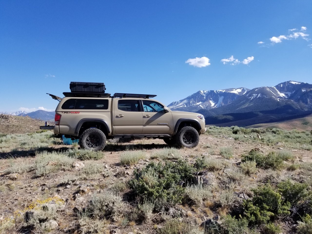

    Mine is a Pelican Vault case. I forget the size, but I'll check when I get home from traveling. The Pelican Vault cases are cheaper than standard Pelican cases, but they are also quite a bit lighter in weight. I had this case mounted to the Front Runner rack on my 4Runner prior to moving it to the Tacoma. Holds my tools, air compressor and some recovery stuff.

    I wanted a case that was just a bit taller so that my Viair compressor would fit. Weather seals are perfect even after a year in midwest elements. Truck stays parked outside too.
    Here it is mounted on my old 4Runner.

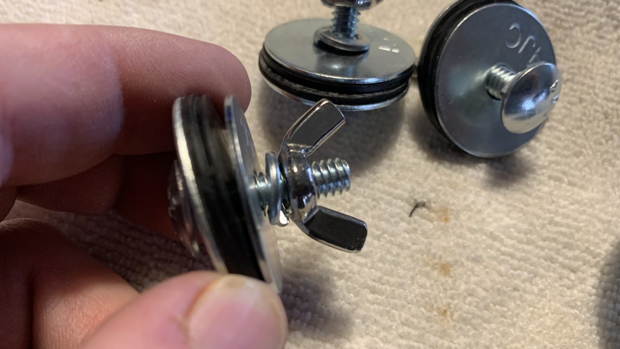

    I finally got around to taking some more pictures of my Pelican Vault case. I did confirm mine is the V700, but as you can see from the pictures, there is easily room for the 730 or possibly the 800 with a Prinsu rack. I bolted mine up with a combination of SS carriage bolts, lock washers, fender washers and rubber washers. Inside, there's plenty of room for my Viair compressor and hose, tire repair kit, tool roll, torque wrench, breaker bar, trash bags and misc. gear. I keep in locked by a couple of exterior rated Master Lock padlocks. It's relatively low profile and easily fits in our 7'-2" parking garage at work, with approx. 4" to 6" to spare.

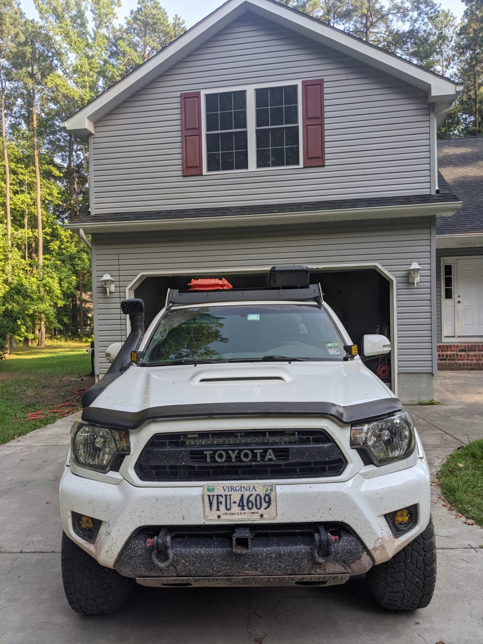

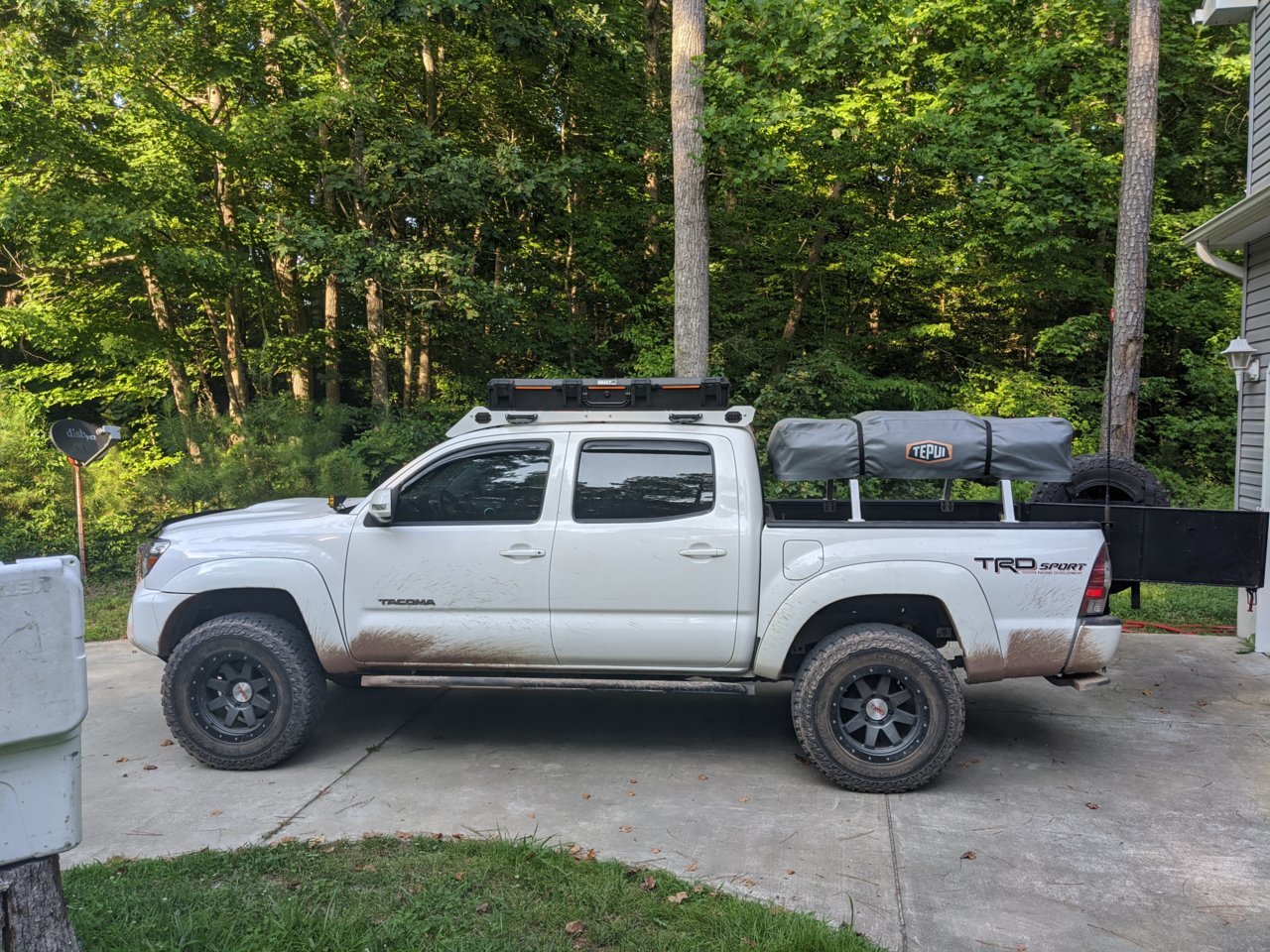

    I recently mounted a v770. I wanted the skinnier model so I could still fit my rod racks up top if I needed too.

    Nice set up brotha. I just bought the v700 and planning on mounting it on my prinsu. What’s the length of the carriage bolts that you used? Wondering if the 1” carriage bolts that I just bought will be long enough to use with a stainless steel washer and rubber washer.

    I think those would be long enough. I'm not sure what length I had used.

    How's the weatherproof for those rubber washers? Seems much better than having to use silicone to fill the gap on the holes. And looks great im going to mount mine tomorrow.

    They've been fine so far. I've never has issues with moisture coming in from the mounting holes. I will say, I did start to have issues with the seal on the newer Vault case leaking around the lid. The Vault case that is over a year older has had no signs of leaks. I did have a few camp chairs up in that box which may have prevented a good seal, but I'm not sure.

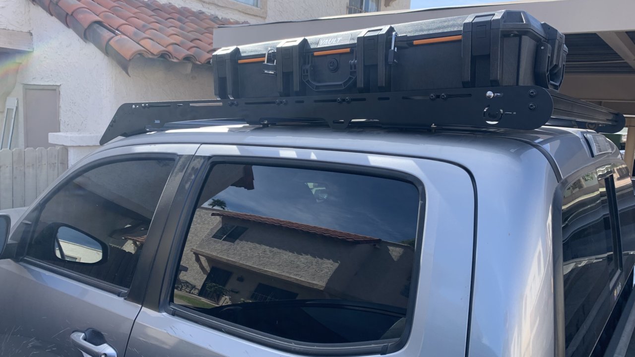

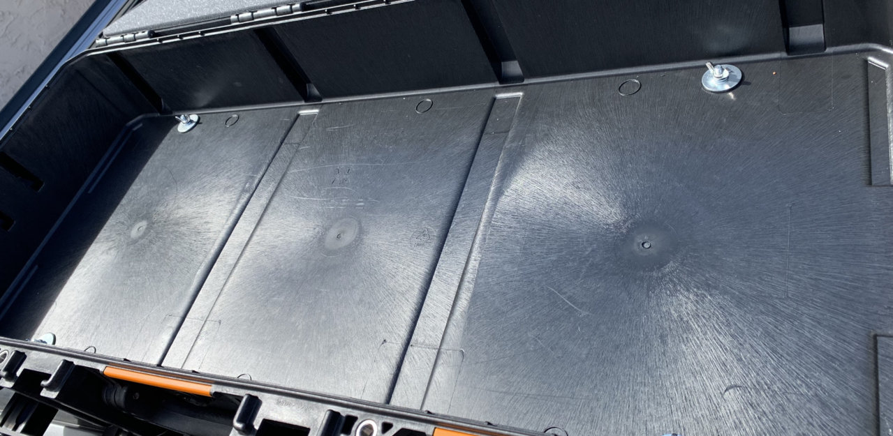

    Bolted my V700 to the Prinsu today. Not much to review. Not as robust as more expensive Pelicans, but I don’t so much need a ‘super protective case’ on my roof for storage. This is also why I decided against Roam cases- just too much money for the same functionality. This thing isn’t going to be tossed around by baggage clerks or shipping companies. I just wanted simple storage.
    Oh, and for the individual who asked about bolt size, I used 1” carriage bolts. 3/4” would be long enough.
