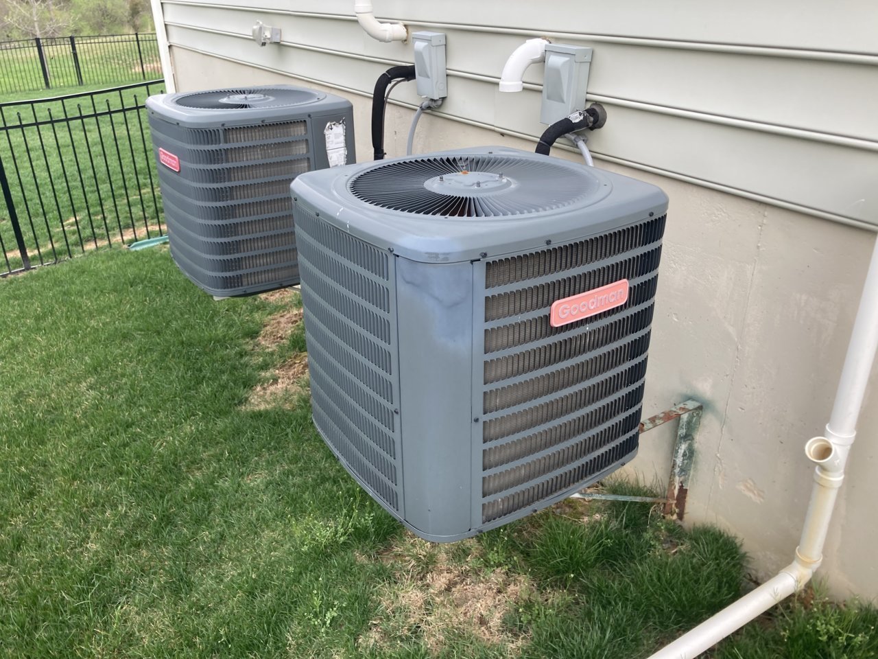

    Back in about 2006-2011, I was more obsessed with HVAC than I was with cars! Everybody knows Carrier, Lennox, Trane, York, etc...
    My grandma bought a house in 2006 that was built in 1993-1994, and it had a 2004 Goodman heat pump that had replaced the original York system; I had never heard of Goodman until my Grandma bought this house, and unfortunately the unit my grandma's house was from an era when Goodman was junk...

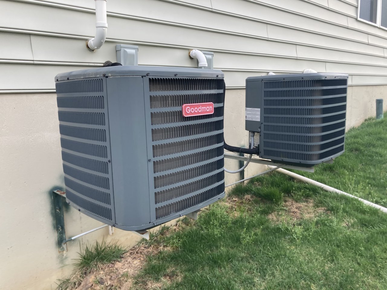

    My parents' house was built in 2016 and has Goodmans of the the greatly improved era that were first introduced in 2006 or so...
    4EBBE019-8926-4C16-B0EA-EE78C18DDD09.jpg A745D07F-66E9-4698-867B-FFFA6E86AC62.jpg

    My parents' A/C units are 14 SEER, with R410a refrigerant the venerable Copeland Scroll compressors; They are certainly not the quietest units around, but they are comparable to the 13 SEER Carriers at our old house in terms of noise level, and certainly quieter than any pre-2006 Goodmans!
    The EPA mandated that all residential central A/C units and heat pumps have a minimum of 10 SEER beginning sometime in 1992. There were air-conditioners and heat pumps of 10 to 12 SEER and higher as early as 1985-1986, but the typical standard efficiency condensing unit was about 8 SEER prior to 1992; The highest efficiency residential central air-conditioner (also available as a heat pump) you could get in 1990s, at least that I am aware of, was the dual-compressor Trane XL1800 that was first released in about 1997...?
    The EPA upped the minimum rating from 10 SEER to 13 SEER in January 2006 I believe, and since our old house was built in 2007, it had 13 SEER units. The majority of new houses being built today have anywhere from 14 SEER to 16 SEER units, though I do believe that the minimum is 13 SEER.
    The phaseout of R-22 began in 2009, and R410a was first mandated in new homes beginning in 2010 or so; R410a was first introduced by Carrier under the name of Puron, and my best friend's parents have a Lennox system from 2003 that has R410a. R410a started becoming more mainstream in like 2006-2009, and by 2010 it was mandatory.

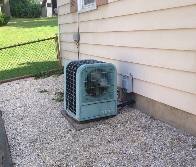

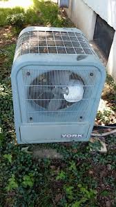

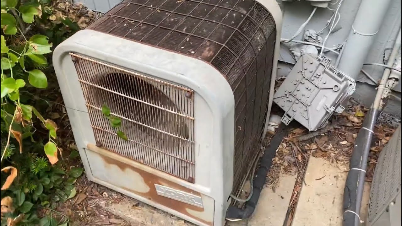

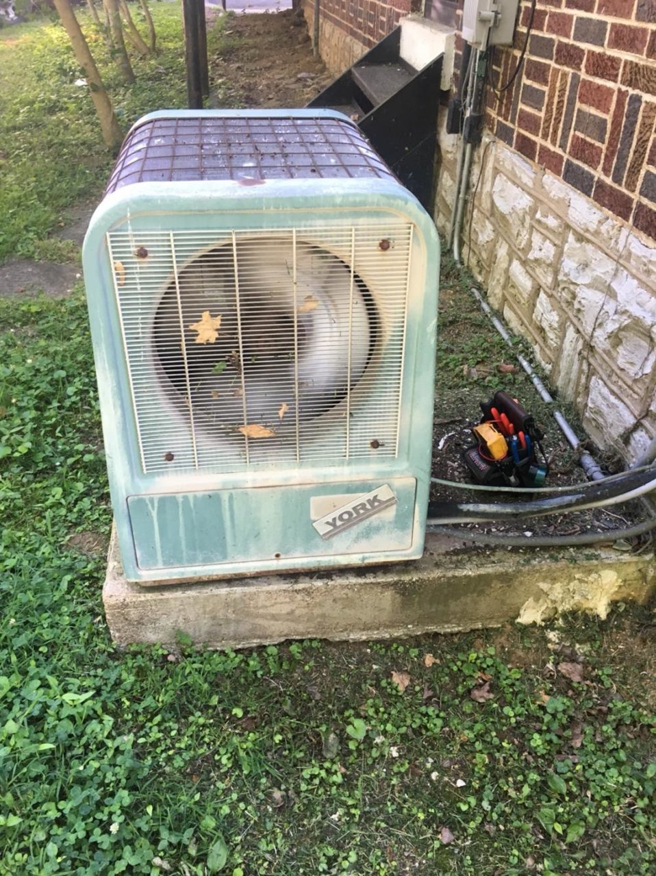

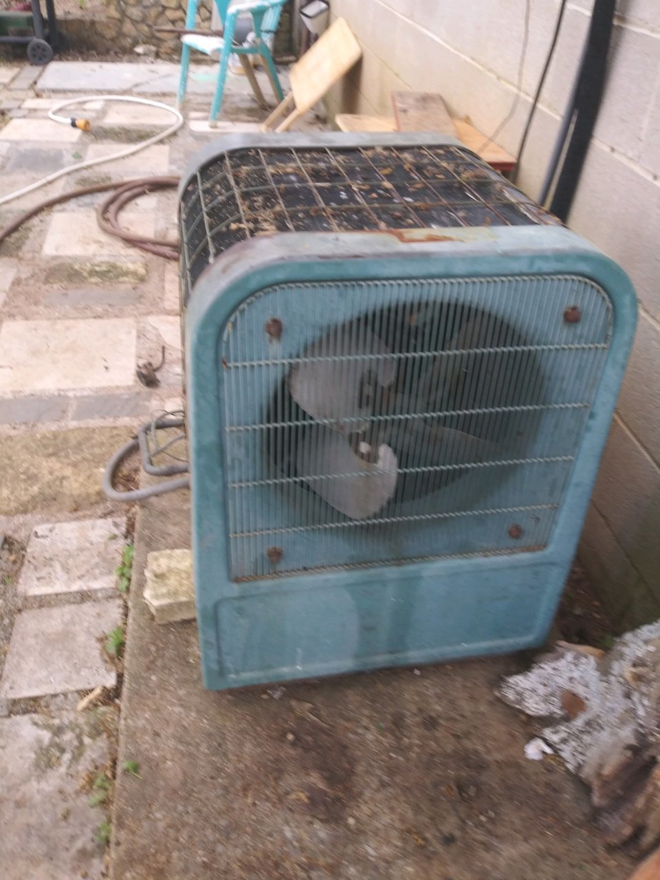

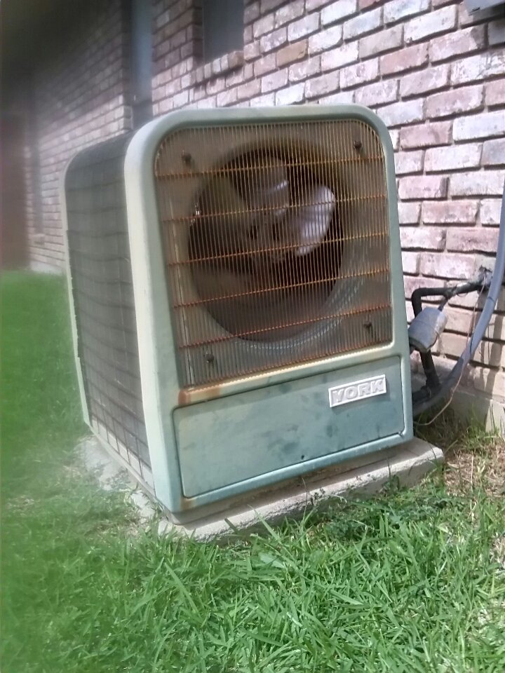

    Wow, those are kinda strange looking.

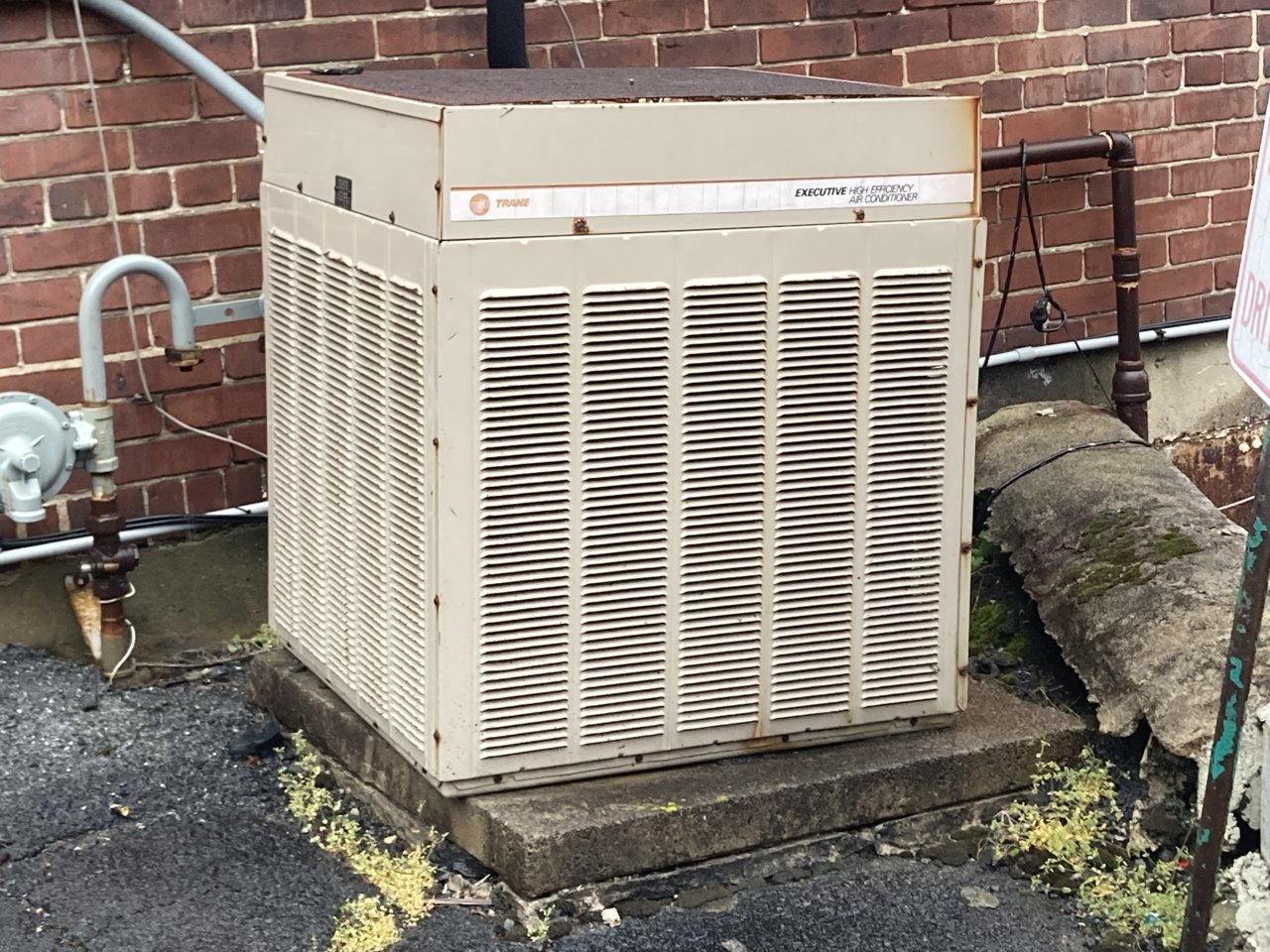

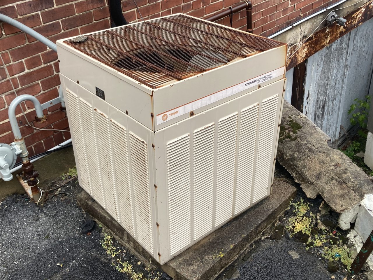

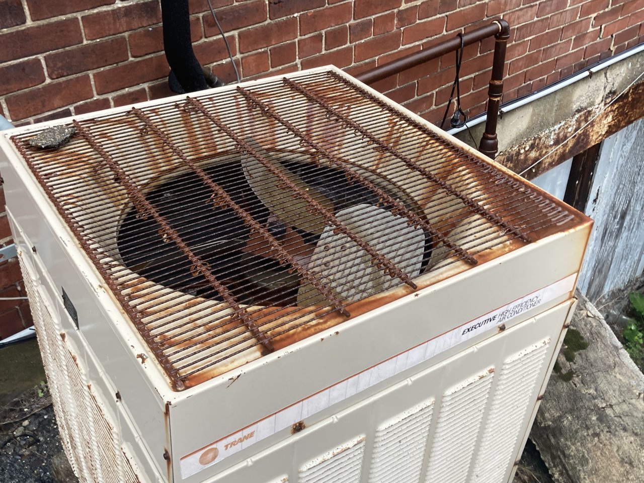

    Here's a more normal-looking unit I saw at a building next door to that car museum in Pottsville a couple weeks ago; Circa mid-1980s Trane air-conditioner! These things were built from the late 1960s until the late 1980s with minimal changes, and as you can see they enjoy a remarkable survival rate!

    It looks a little rough but if it works then great!!

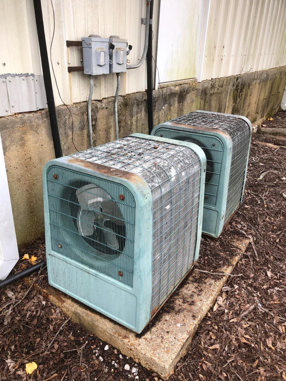

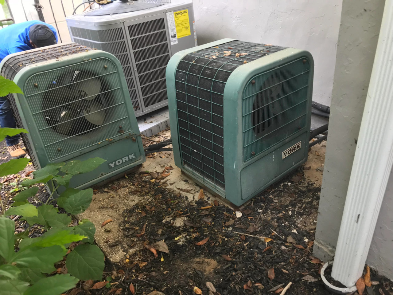

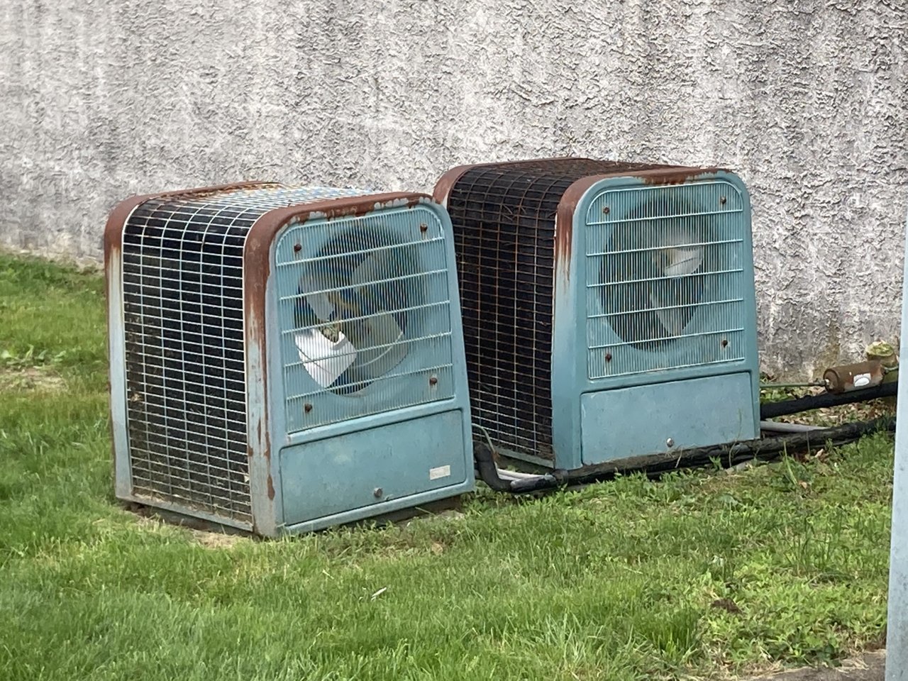

    I found more of them!

    Nice!

    The other ones were just pictures I found on the internet; I actually saw these in person at a commercial building in Ivyland, Pennsylvania!

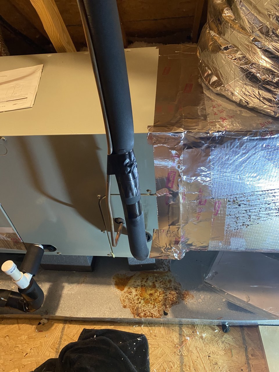

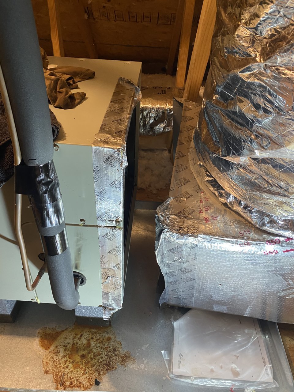

    Any HVAC or other input on this?

    We’re both inner and outer sleeves taped? Any zip ties used?

    no zips. and not sure what you meant by inner/outer sleeves. i reattached it all the way around with tape.

    So you have all solid pipe? Big zip ties (a few feet or more in length) are used to connect flex ducting to plenum flanges, y-pipes, and boots but tape is the primary sealer. Flex has an inner sleeve with a spiral wire for shape, a spiral wrap of insulation, and an outer sleeve to protect the insulation as well as improve its efficiency.
    For solid pipe connections you can use sheet metal screws before taping but never on dryer exhaust since it captures lint.
    If it’s in an unregulated space you should wrap all uninsulated ducting with 1” thick roll insulation or those pipes will be wasting a lot of your heating/cooling energy, cold air returns too.

    ah gotcha. Not sure if there were or not. It is the flex duct type tubes running everywhere up there. Only issue I was having was the return plenum separation from blower unit.
