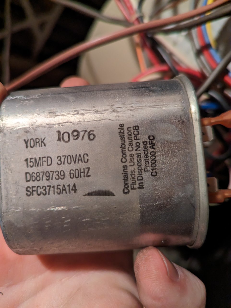

    Run capacitor for blower motor/squirrel cage?
    auskip07[QUOTED] likes this.

    that seems likely, The malfunction occurred at 11 pm i was awakened by my wife at 4 am. When fiddling with the heater unit the fan motor was not cold like the rest of the attic before i started the reset process.
    i think im going to replace the Cap anyway and see if this issue pops up again. just need to match the specs and ill be good to go

    pulled the spec off the cap but it has a 15 in sharpie written on it that i would have assumed was the date. Little strange since we moved in 2014 and have not had anyone service the unit or any issues.

    Maybe MFD doesn't mean "manufacture date" in this case?

    oh thats Microfarad or the rating on the cap. the 15 in a sharpie i was referencing was written on the top where the connectors are. maybe they just wrote that to reference the farad rating? who knows.

    I'm thinking that "15" on the capacitor has nothing to do with the year. You bought the house in 2014 and it came with the current system, correct?
