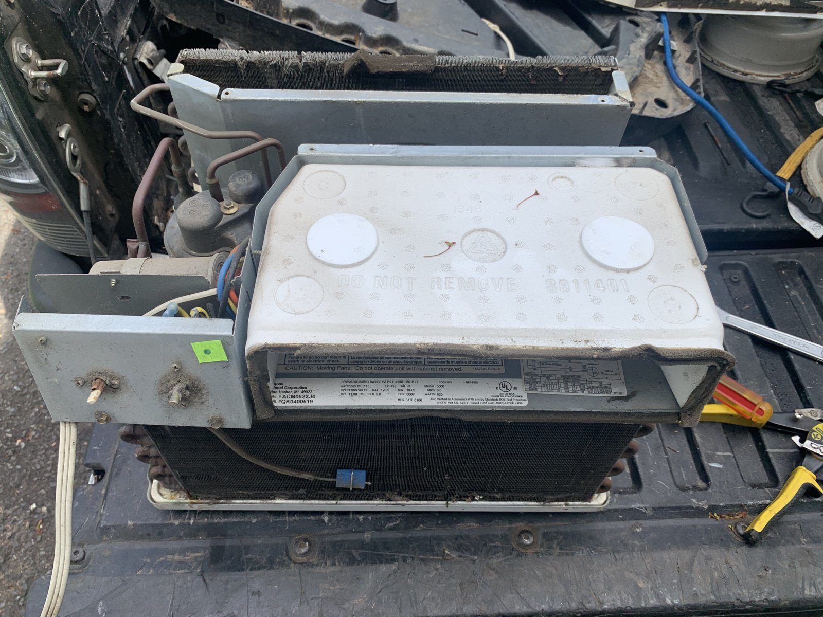

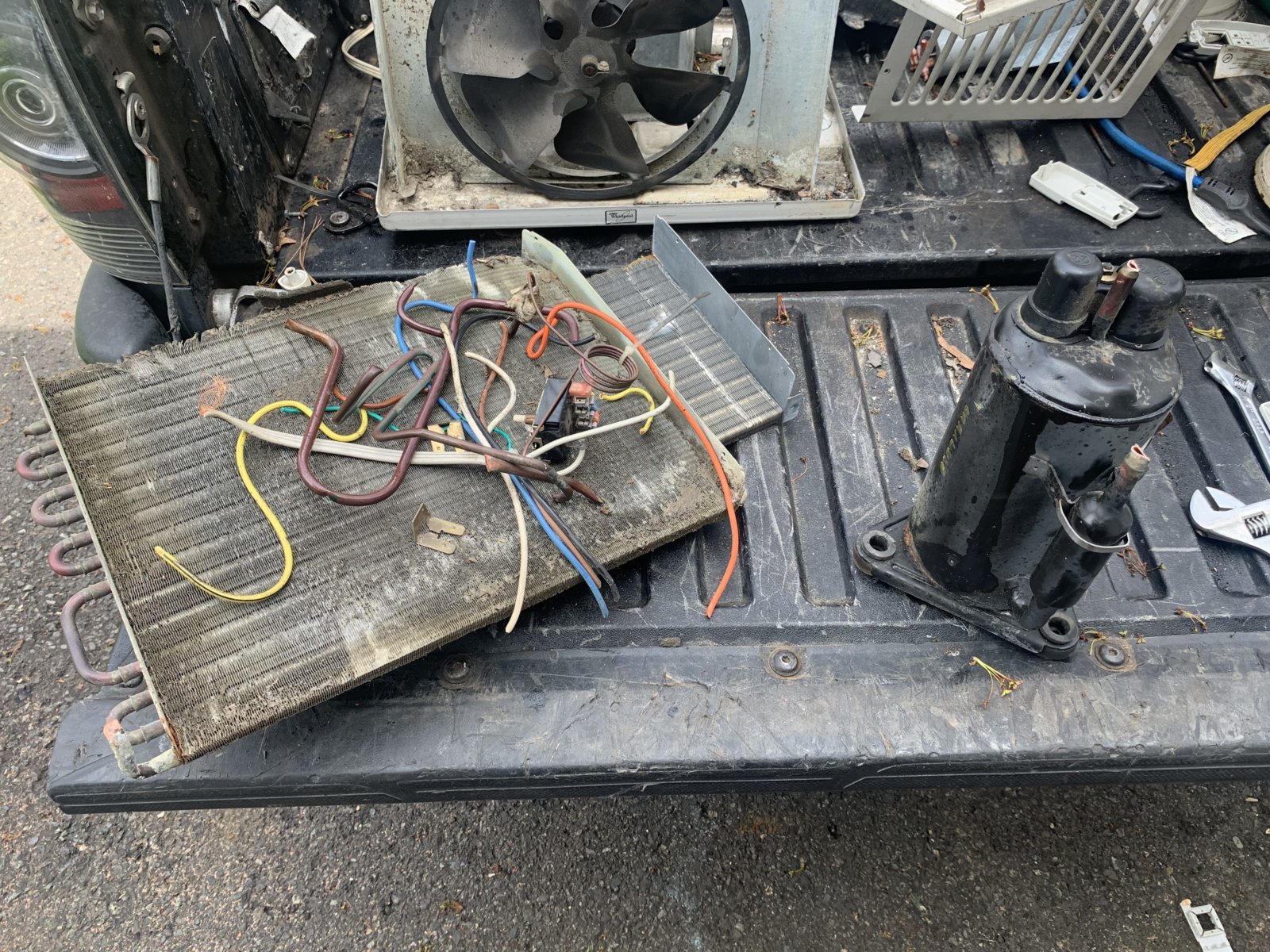

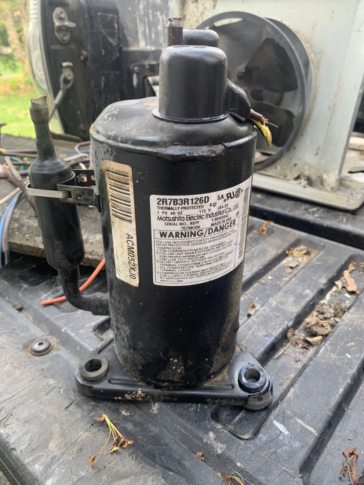

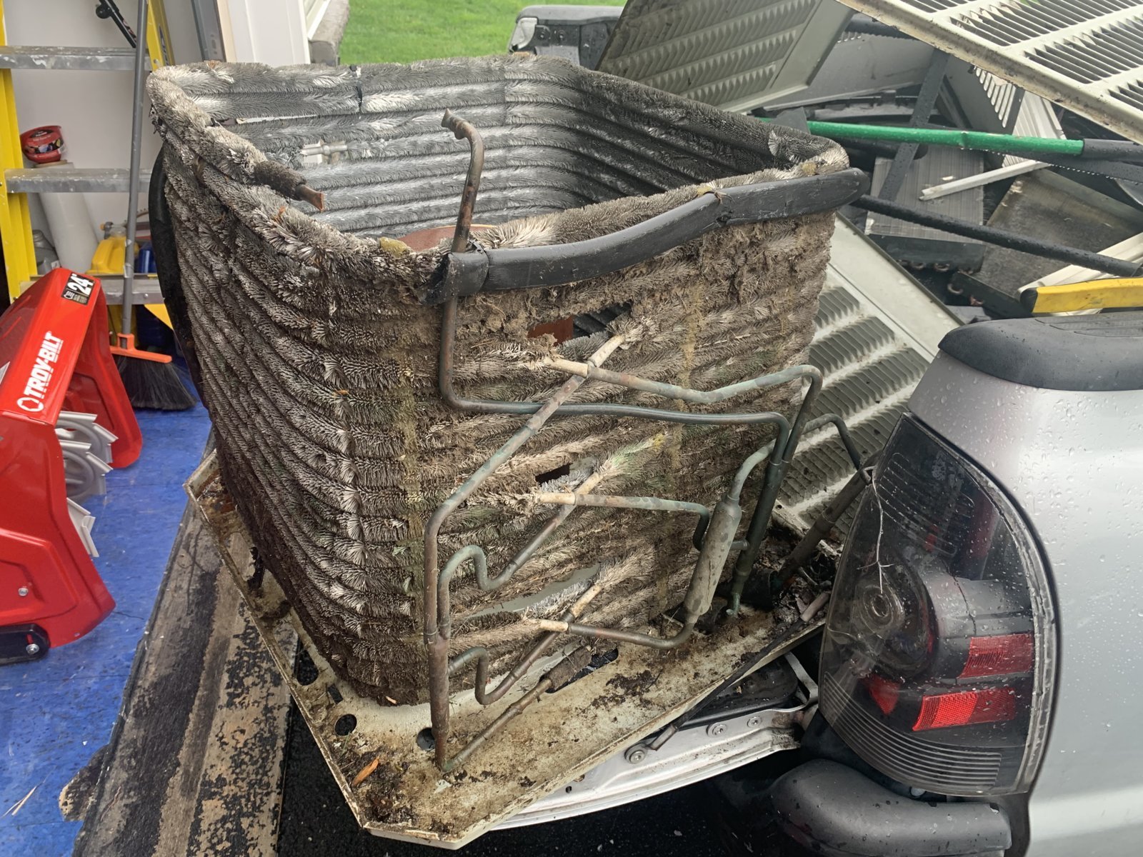

    The compressor, condenser coils, and various copper scraps are the most valuable parts...

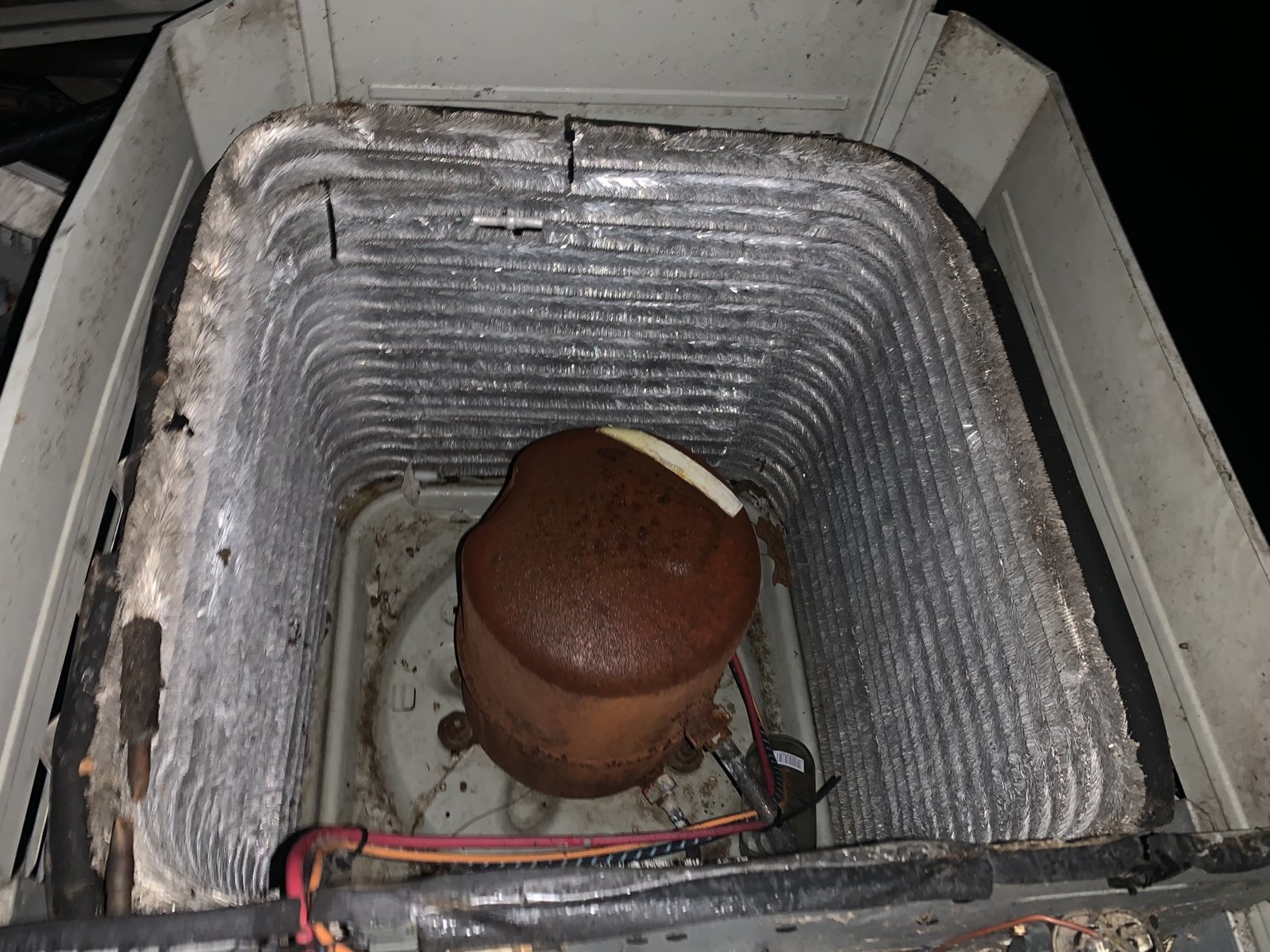

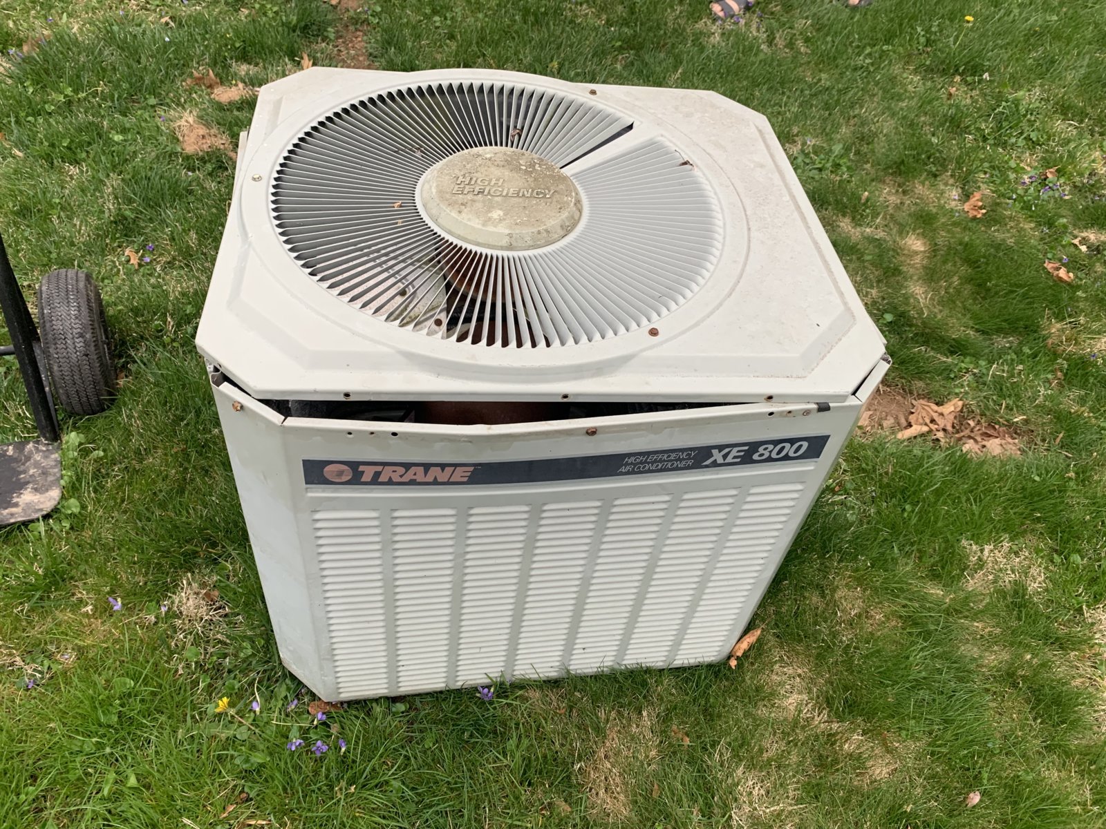

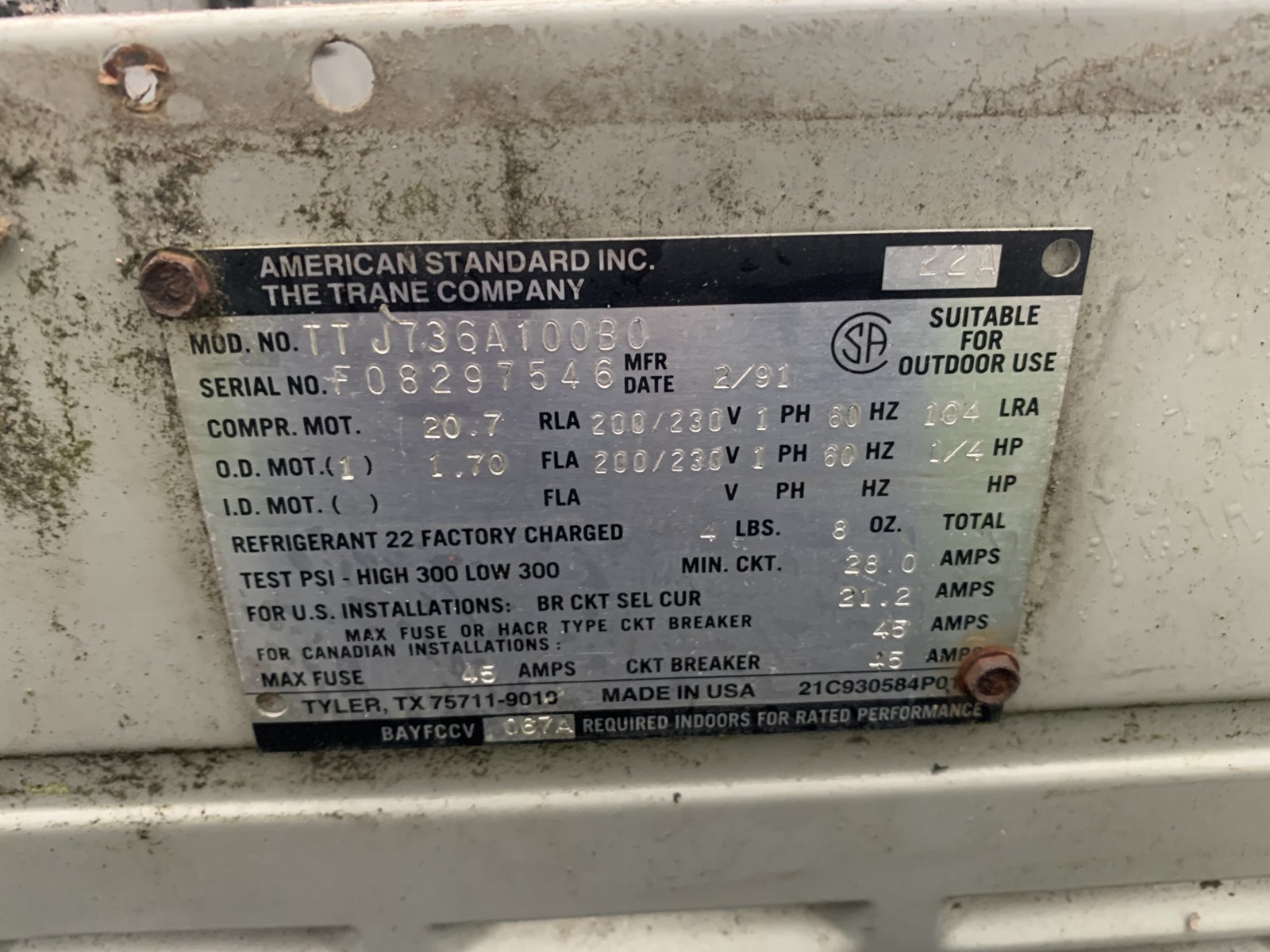

    This was my best score in a very long time; I had to drive down to Berwyn, PA (near Paoli)to get it, but it was free and it will be worth it! This is a 3-ton Trane XE 800 air-conditioner, manufactured in February 1991 and installed a short time later at a house that was built in 1967. The compressor just recently died, and the homeowner installing a Fujitsu ductless mini-split heat pump system, while keeping the natural gas baseboard heat. I snatched this up as soon as it hit the market, and drove almost an hour to get it!

    The government first implemented a mandatory minimum energy efficiency ratio in 1992, and from 1992 to 2005 it was 10 SEER. Prior to 1992, typical central air-conditioners and heat pumps were 6 to 8 SEER, though higher-end models could be 10 to 12 SEER. In the late 1980s, Trane came out with a 15 SEER inverter heat pump that had a variable-speed compressor, but they were very expensive and required special training to service. As a result, this unit did not sell well and there aren't many left. This Trane was manufactured in February 1991, so there was no minimum mandatory SEER. Trane also made an XE 900, and came out with the XE 1000 in 1992. Many of these are still in operation today, and I've also seen XE 1100s and 1200s, but the XE 1000 (last manufactured in 2002) is by far the most common.

    Trane is the only HVAC manufacturer I'm aware of that installs its own compressors in some of its products. Trane's in-house compressor manufacturer is Climatuff, and this unit has one of these legendary compressors! The compressor is allegedly what failed, but it was an impressive 33 years of age, so that's definitely not a bad run!

    Those Climatuff Comps were a cinch to replace since you didn't have to braze/solder them, simply use 2 wrenches and your were in. So quick and easy. The really big ones had a nut welded on the top so you could insert some all thread and lower them in with a buddy.
    As for the Runtru brand mentioned about 20 pages ago, I just installed a Runtru furnace in my house (A952V060BU4SAD) and a Trane HP (4twr40303N1000A with a baytwgr0003). The Runtru furnace lacks the finish of the Trane, but is functionally identical ( to the S9V2B060U4PSCA). If you cruise through both install manuals, they are so identical that Trane uses the diagrams and pictures of the Trane in the Runtru book. Weights are the same, everything except for one thing.
    Trane has a lifetime (99 years) warranty on the heat exchanger where Runtru goes only 20 years.
    I don't care as much for the Runtru O/D units. The QC on them is not as great as the Trane and the fit and finish looks builder grade IMO. I install them typically in rentals. The service ports are supposed to be clocked about 45º and I have encountered a few Runtru's that were at 0º and had to bend the sheetmetal to get my gauges on.

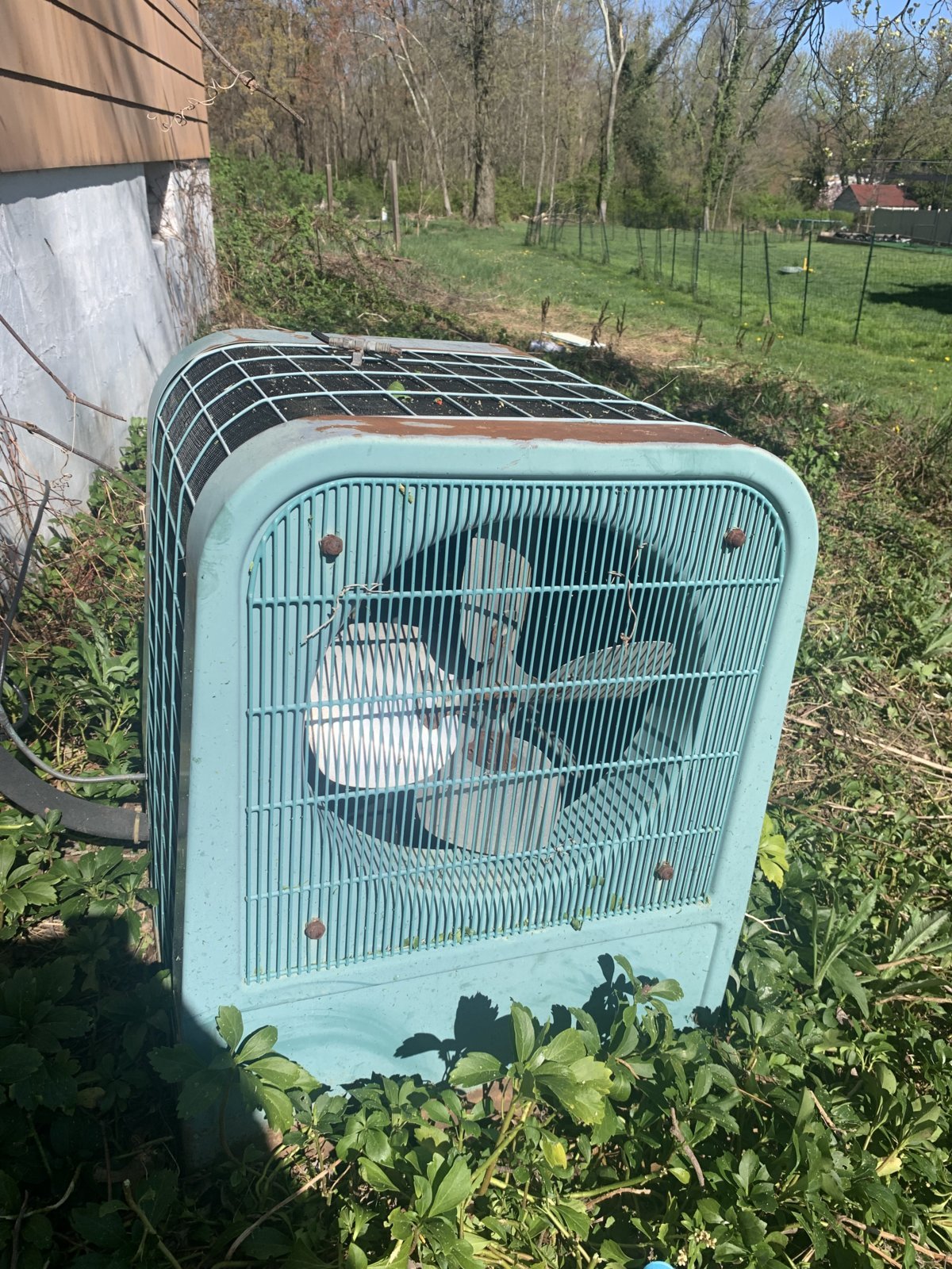

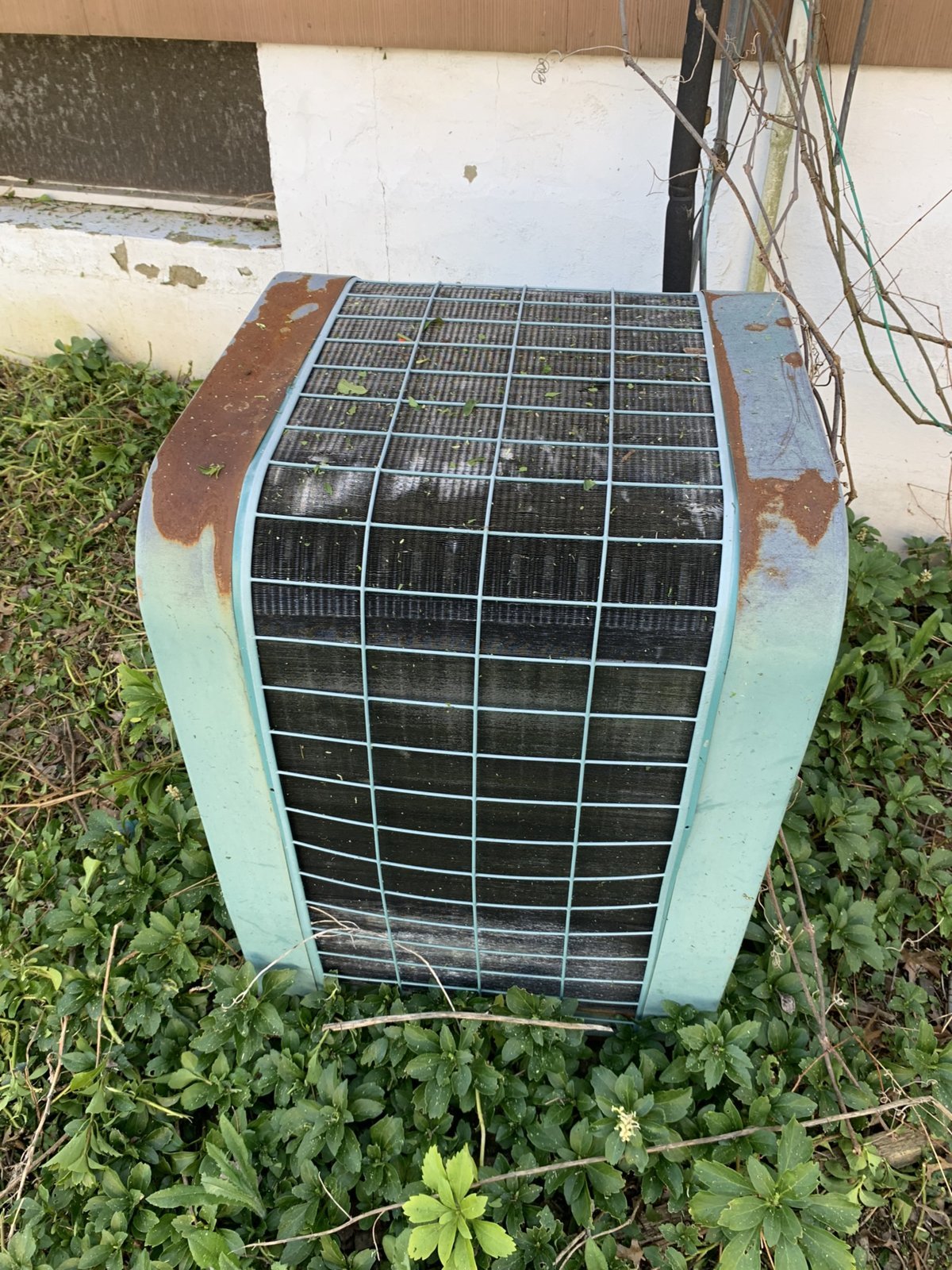

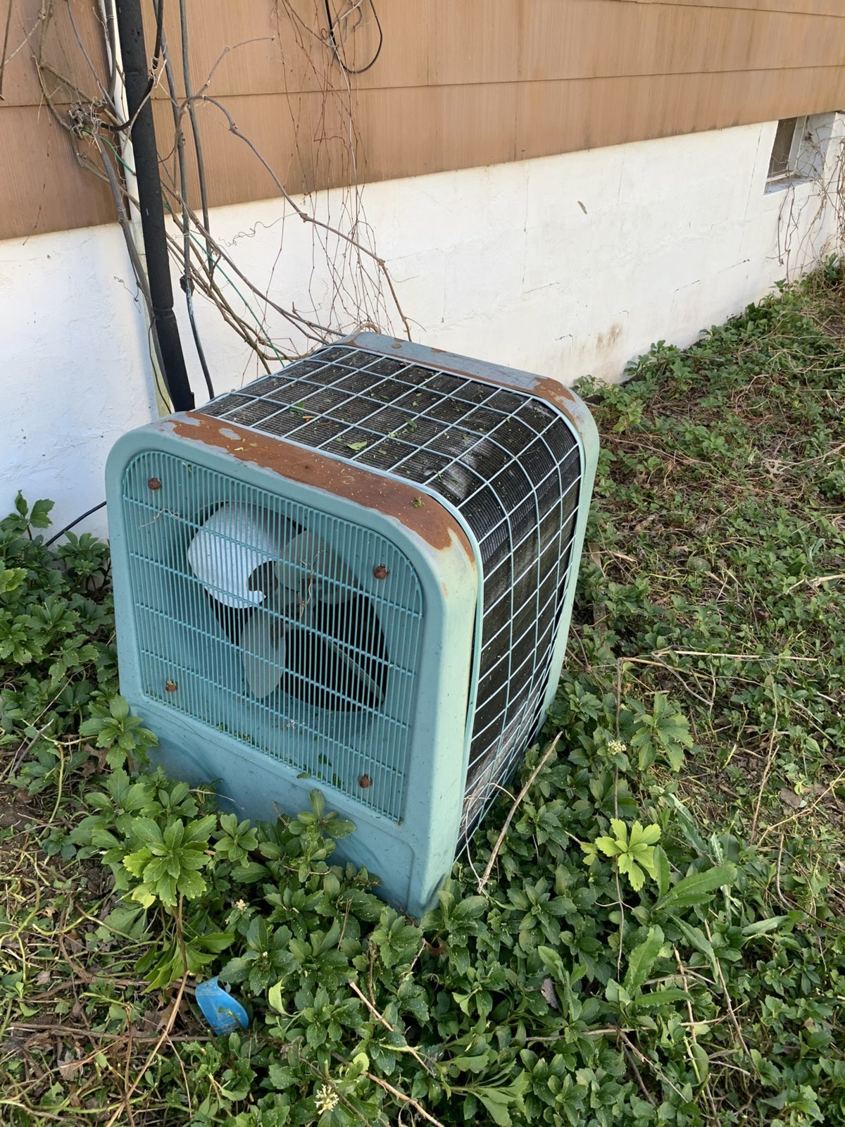

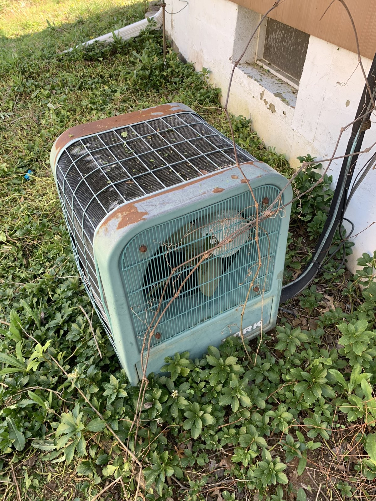

    I will soon be the proud owner of a York Champion "Tombstone" central air-conditioner; I am getting it for free because I answered an ad on Facebook Marketplace and helped a guy clear out a house he bought and is presently renovating!
    shakerhood likes this.
  16. Apr 15, 2024 at 10:19 PM
    #756
    PennSilverTaco
    PennSilverTaco [OP] Encyclopedia of useless information...
    Jul 15, 2014
    #134007
    72,351
    Charlie
    Central Bucks, Pennsylvania
    2010 Zombie Truck 2002 PT Cruiser
    @6 gearT444E
    @ColoradoTJ
    @Just_A_Guy
    The house presently has no electricity and the new owner has to wait several days to get it turned back on. As such, we have no way of firing this beast up. When the power is turned on, we will fire up the A/C and see if it works. If it works, I will restore it and sell it to a collector (yes, A/C collectors are a thing!), but if it doesn't work I will just scrap it...

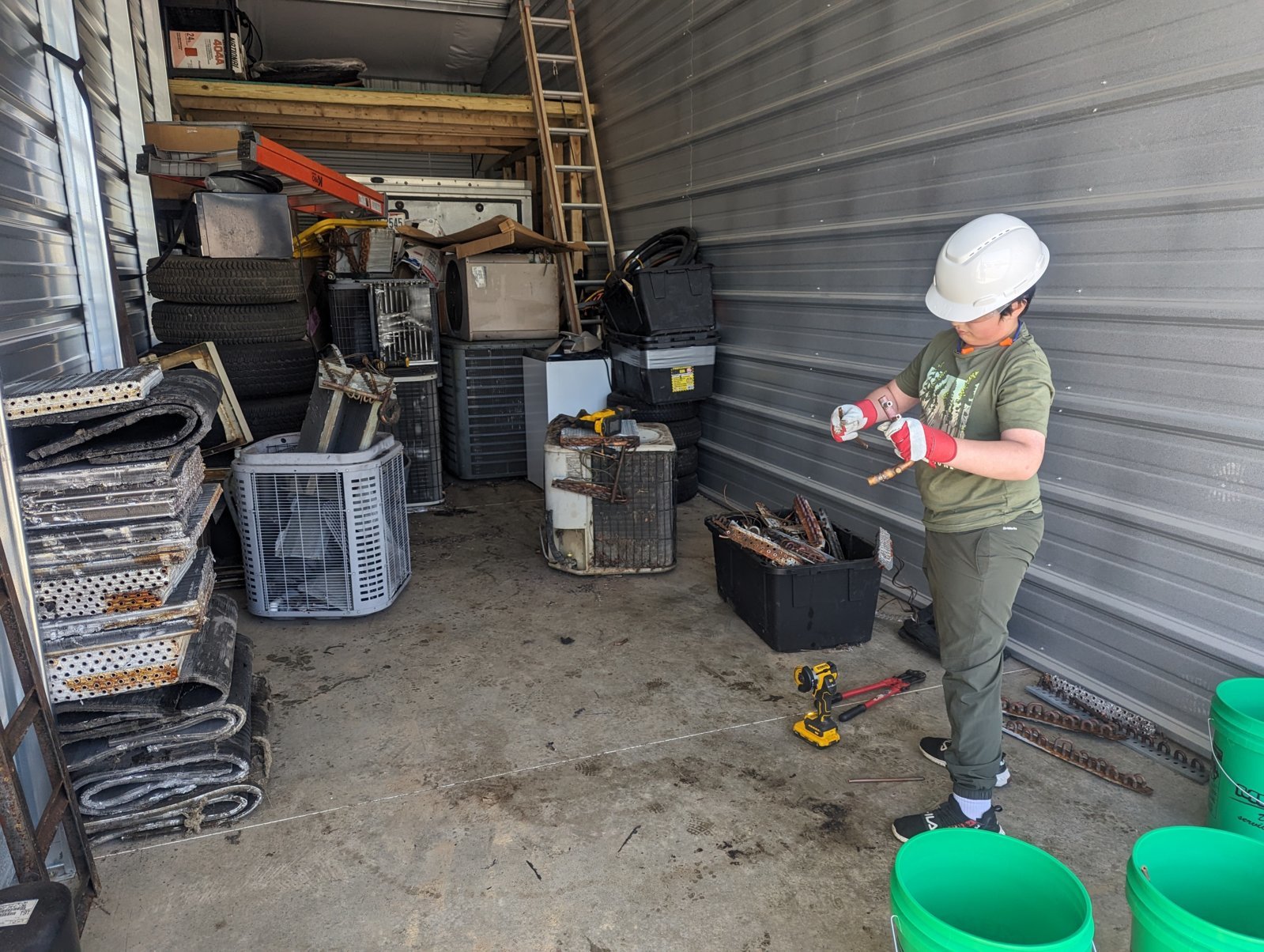

    @PennSilverTaco
    Current pile I'm working through. I store them until they take up too much space, or save them for when work is slow. I'll probably finish them up later in the week as it got warm here right now.
    Current stack of coils is over 5ft tall as it is taller than my helper when we quit. I'm not sure how many I have in total.
