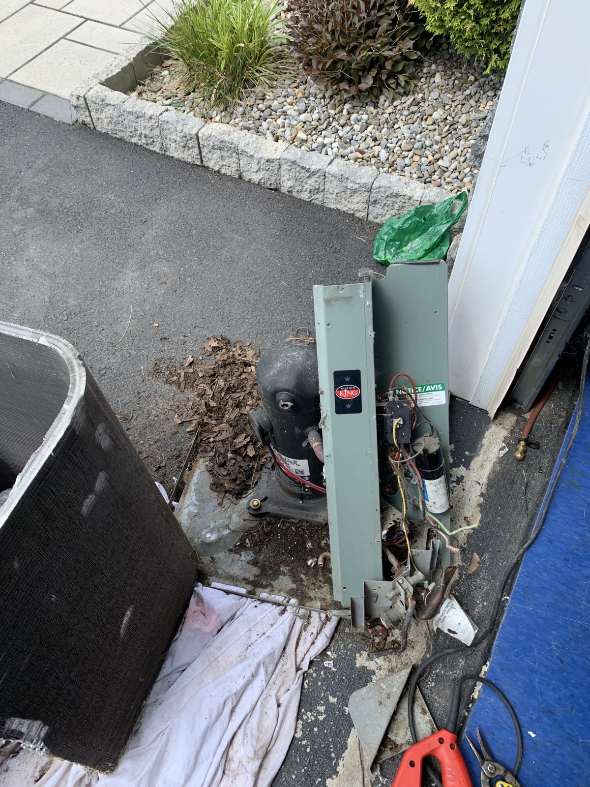

    I cut up the Weather King this morning as well...

    2011 and it has a hard start capacitor; I'm thinking this unit was not functional when it was removed...

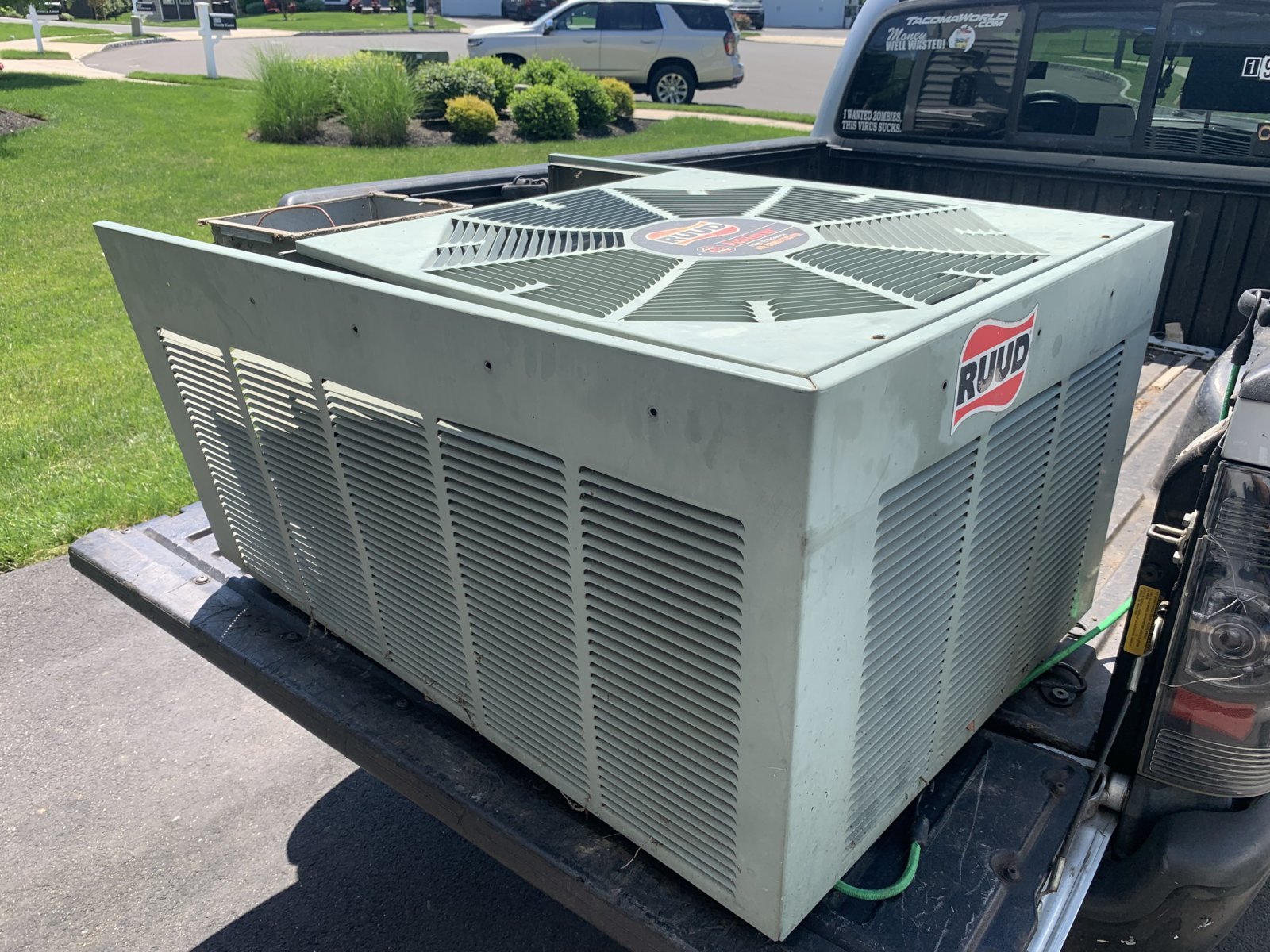

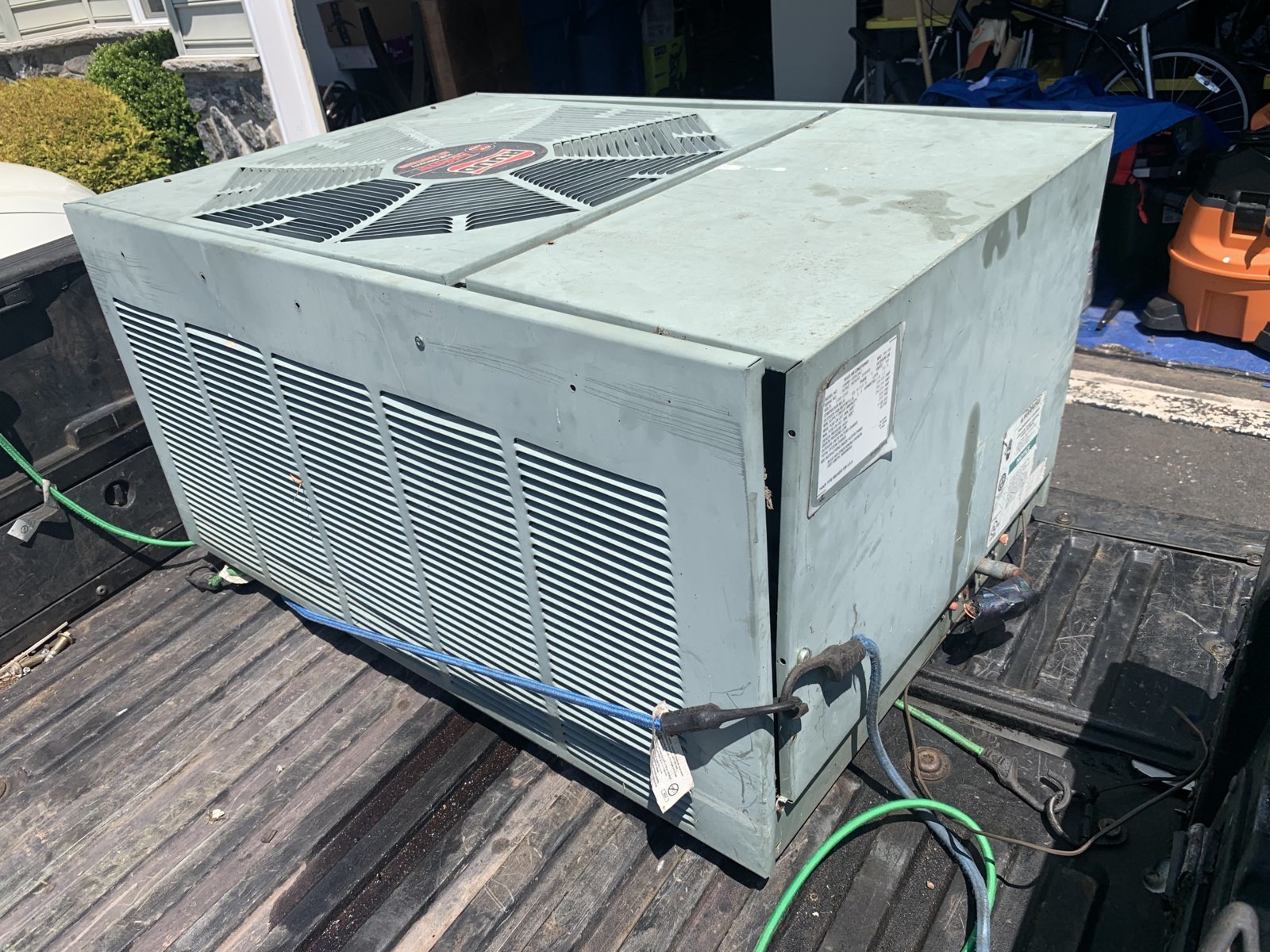

    I have had a serious soft spot for pre-2005 Rheem/Ruud units, which I lovingly call "Stamped Octagons" due to their unique fan grille design, for years; I found one on Facebook Marketplace about an hour away from me in Jersey for $100, and asked the guy if he'd take $50. He said that was fine, and I picked it up on Tuesday afternoon. This 2-ton Ruud Achiever, manufactured in June 2000, was still fully operational. The house was a small older rancher, which already had gas baseboard heat, and the owner had decided to leave the gas heat but switch to ductless mini-split heat pumps; I have decided to turn this unit into a coffee table!

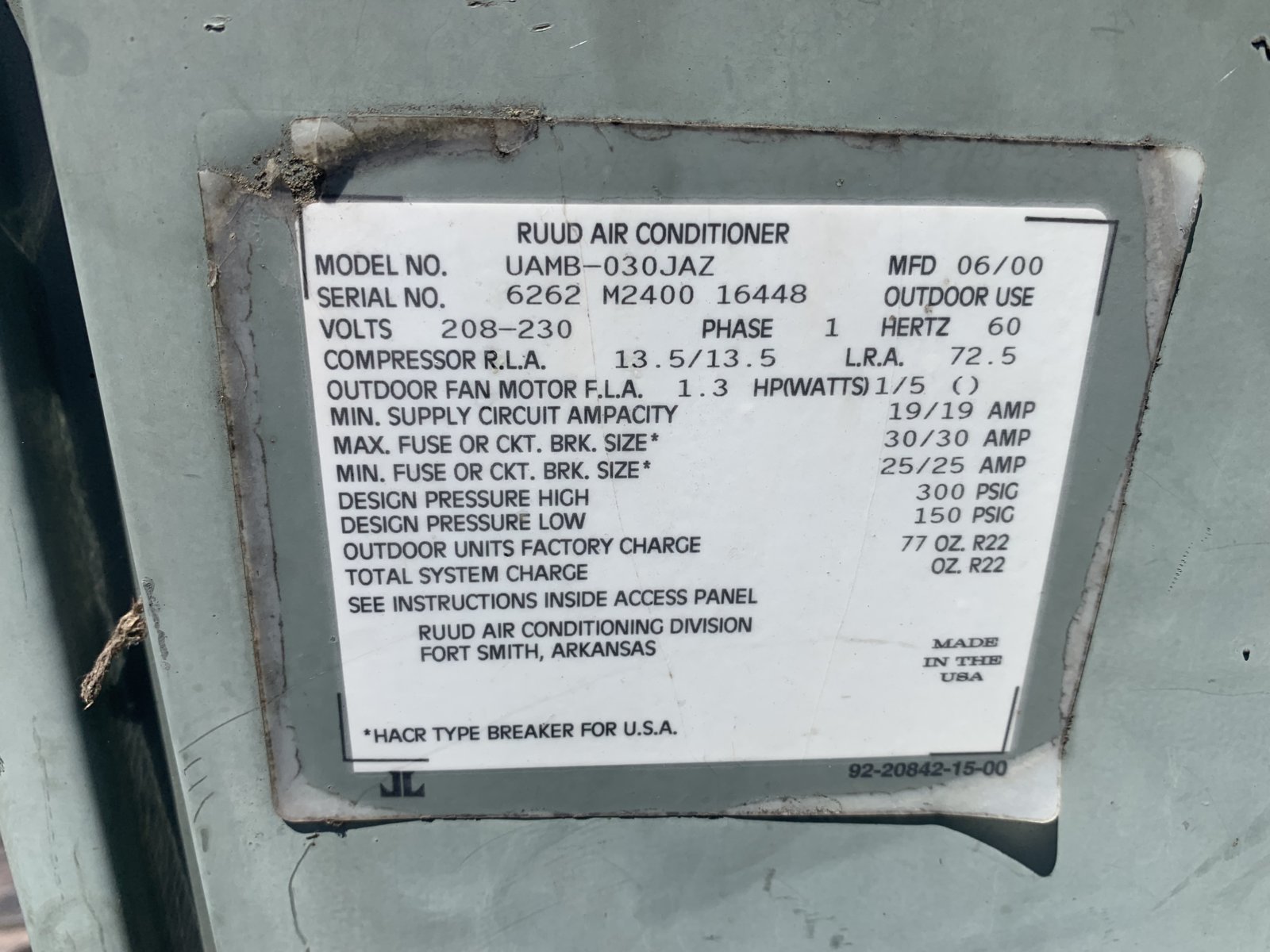

    This is a 2-ton unit (24,000 BTUs), manufactured in June 2000. My grandma had a new Rheem Classic X installed in 1987, and the thing lasted over 30 years!

    Everyone has their opinions, but I think that pre-2005 Rheem/Ruud units are some of the best ever made! Even the older units with reciprocating compressors are incredibly quiet. These units also don't rust like other brands from the same area, though I have never seen one in a salty beachfront environment. One of greatest features of the newer "Stamped Octagon" units is the isolated compressor area, that doesn't require disassembling the whole unit to service it. This Ruud Achiever is from 2000, and I believe the oldest "Stamped Octagon" I have seen with this setup was a heat pump from 1992 at a commercial property in Warminster (I forget whether it was a Rheem or a Ruud). The "Stamped Octagon" design has been around since probably the late 1970s, and 2004 was the last year. It's possible that the isolated compressor design debuted in the 1980s, but the aforementioned '92 heat pump is the oldest one I've seen...

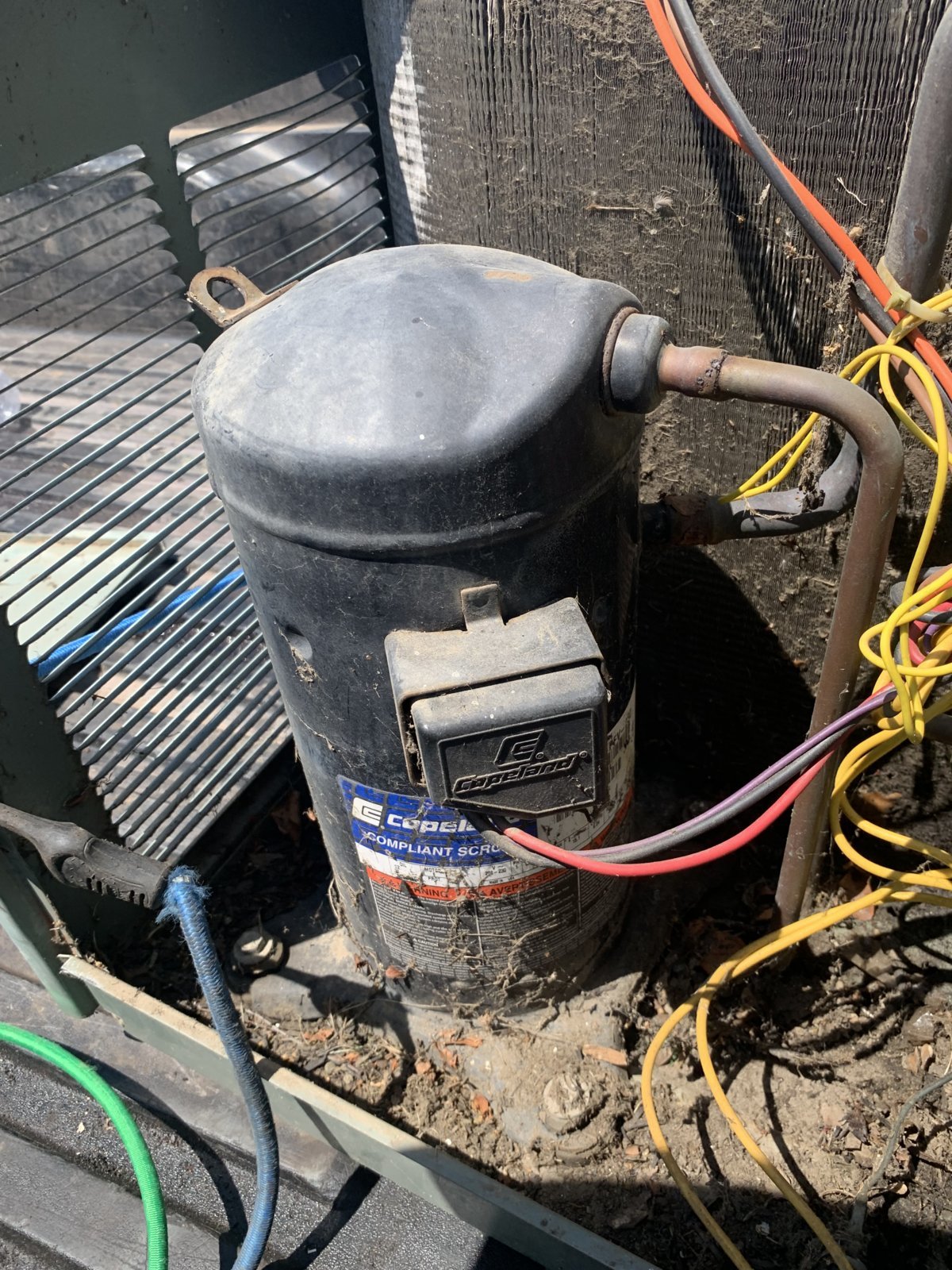

    The venerable Copeland-Scroll compressor, once a Rheem/Ruud exclusive, but now found in everything except Trane and American Standard!

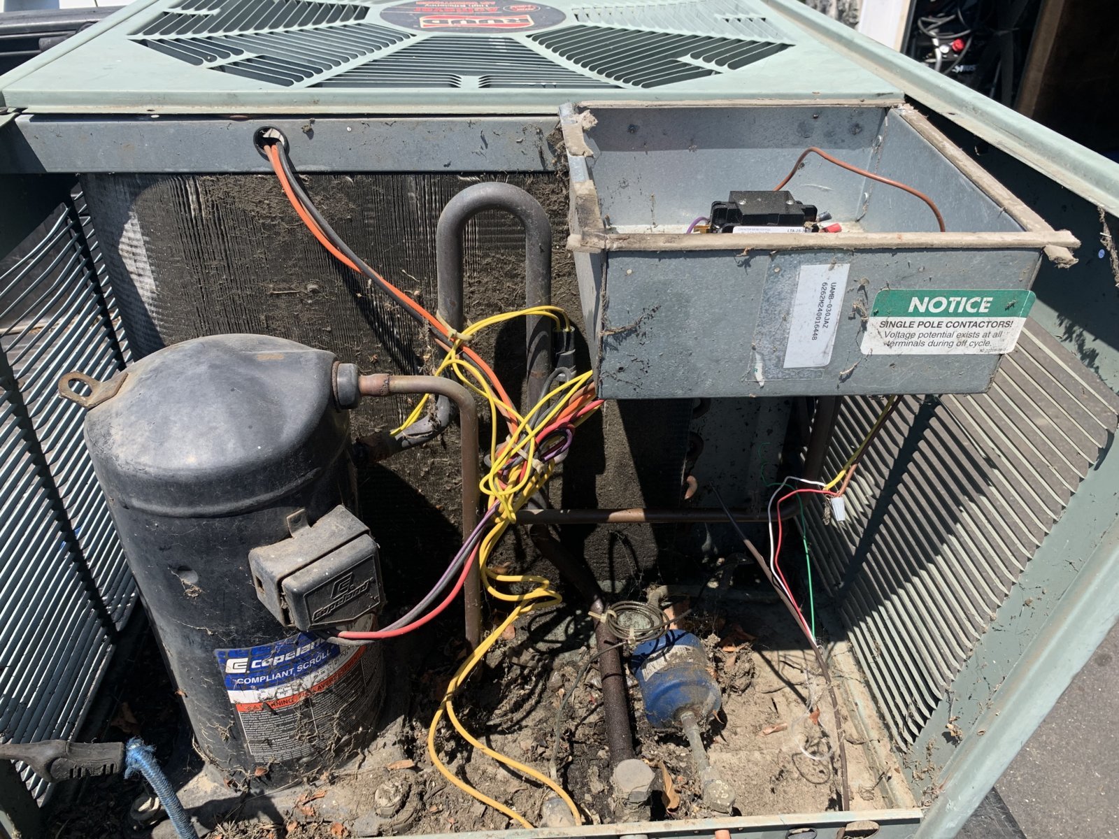

    Easy access to capacitor and other stuff...

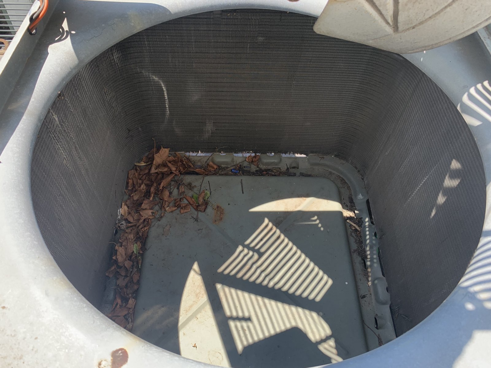

    The area directly below the fan is empty, which results in a quieter unit...

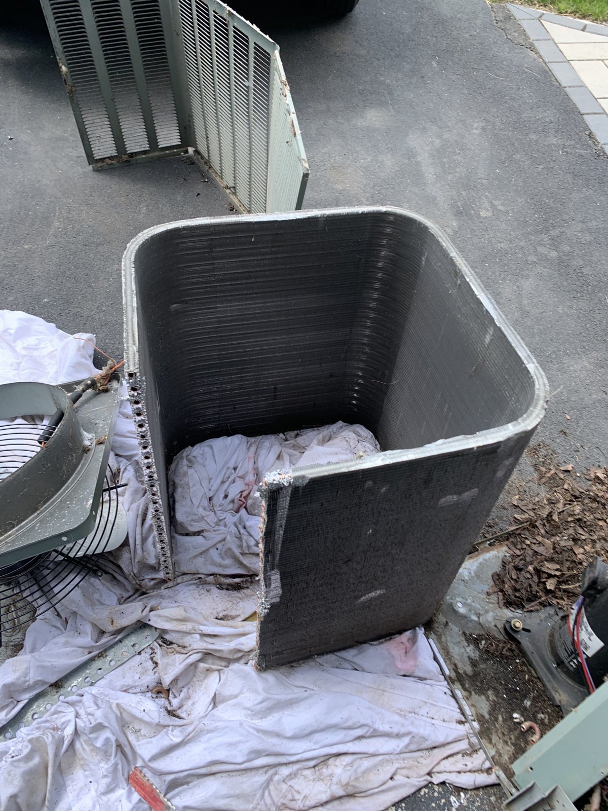

    The 2000 Ruud still worked great at the time it was decommissioned according to the homeowner, but I suspect it wasn't operating with peak efficiency levels; I don't thing it was ever cleaned...
