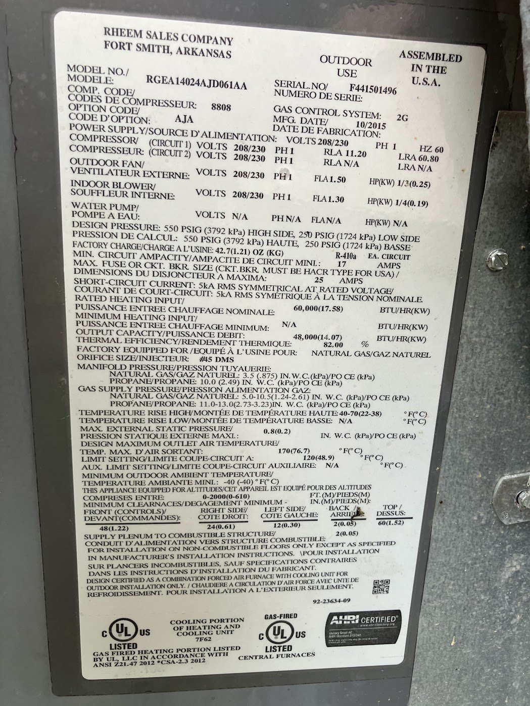

    2015 Rheem gas-pack (Straight-cool central A/C and gas furnace) packaged in one outdoor unit, 2-ton/24,000 BTU. Gas-packs are not common in residential buildings (except for trailer homes) in my area, and really not anywhere north of the Mason-Dixon Line. My aunt and uncle’s house in Norfolk, VA has a crawlspace. The first floor has a Carrier gas-pack, the second floor has a Goodman split system A/C with the gas furnace located on the second floor, and the one-bedroom apartment above the detached garage has a Goodman heat pump with the air handler in a closet in the apartment. I have absolutely no experience with packaged units beyond changing the filter in the aforementioned filter in the Carrier at my aunt’s house…

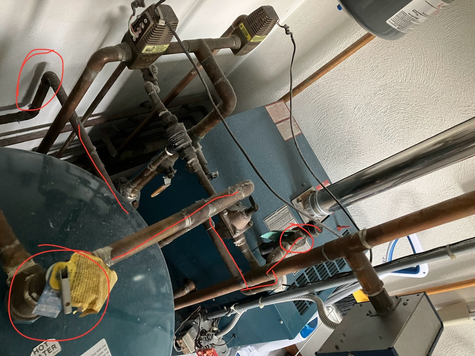

    I'm throwing out a request for help :)
    I've always had SOME drip, but not nearly as much as there has been the past 6 months after the flush.
    I know just enough to be dangerous.... so figured I'd ask for some help before I blow up the laundry room.

    What's the pipe connected to? Like a T&P valve?

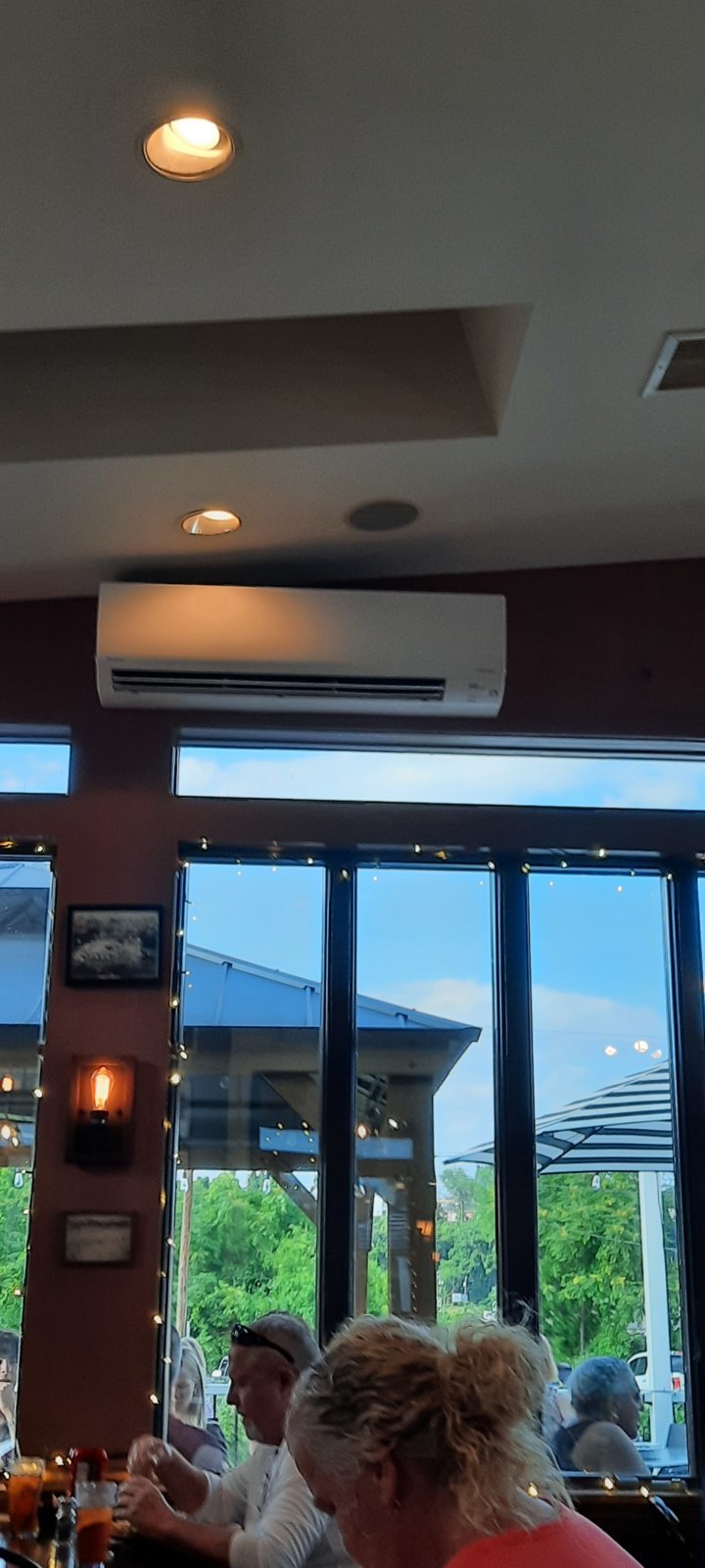

    Charlie , name this.

    It's the indoor portion of a ductless mini-split system, but my vision isn't good enough to get the brand name...

    If it were to guess. It's the AC condensate drain.
    My mothers house has that type system. The system is in the attic, and the drain is piped out of the wall.

    Never mind. I just seen the other pictures. I don't see an AC system there.
    I see a water heater?
    PennSilverTaco[OP] likes this.

    No it's not the AC. Looks like it's connected to two t&p valves, one on the furnace and one on the tank.

    Sometimes when you open a T&P it won't seat properly and will leak. Ok, so what I would do and have done before is these 2 things first.
    1. Reopen the T&P and flush out the body and let the lift arm shut suddenly hoping it makes a good seal.
    2. Gently tap the top of the T&P with a wrench or such trying to jiggle it to shut properly. This works far more often than I would like to admit lol.
    Final option, T&P could be weak and needs replaced.
    Of course could be any number of other things, but adjusting the T&P one way or the other is always my first move. Crud in the system can easily interfere with the valve sealing and you get a continuous leak from them.
    I only go this way since you said the problems got worse after a flush.
    I could be all wrong too so don't take this as gospel and keep in mind I am not there looking at it. I'm willing to try and help though.

    Can I play? I'm gonna guess it is a Fujistu based on the look of the unit as Charlie already said what it was correctly. Possibly Daikin, but I don't think so.
    Any chance we can get the name of the place and location? I'm curious if google maps can get me some pics of the outdoor unit. Nothing better to do and solving a great unknown HVAC mystery is fun for some of us lol.

    Sure, it was at a restaurant
    Speers street grill 121 Speers Ave, Belle Vernon pa 15012
