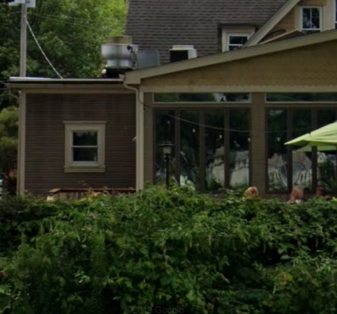

    That looks like a Mitsubishi City Multi to me on the roof.
    So unsatisfying. Go back and demand to speak to the manager, or take a ladder I guess and solve this lol.

    The one on the roof looks like a 1980s Sanyo mini-split. There are still a decent amount of those in service in my area…

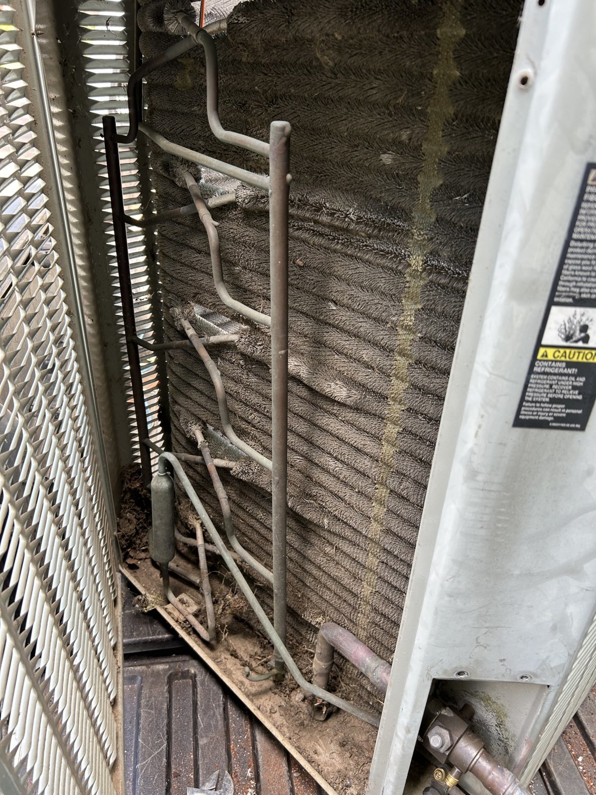

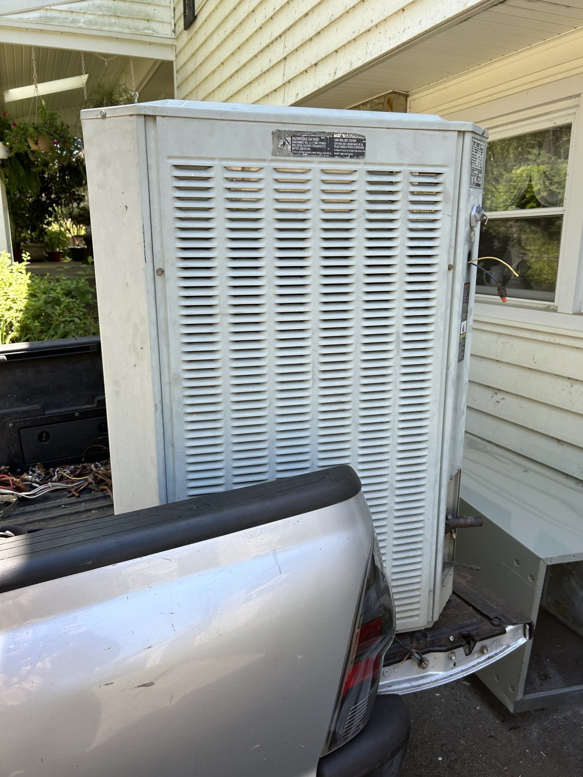

    @Stitchgirl90 and I tore down the 2001 Trane XE1200 3-ton A/C on our day off (Friday, June 28th), but I still have not fully recovered from working back-to-back 12-hour shifts over the weekend, and I keep forgetting to post. Here is the indoor coil…

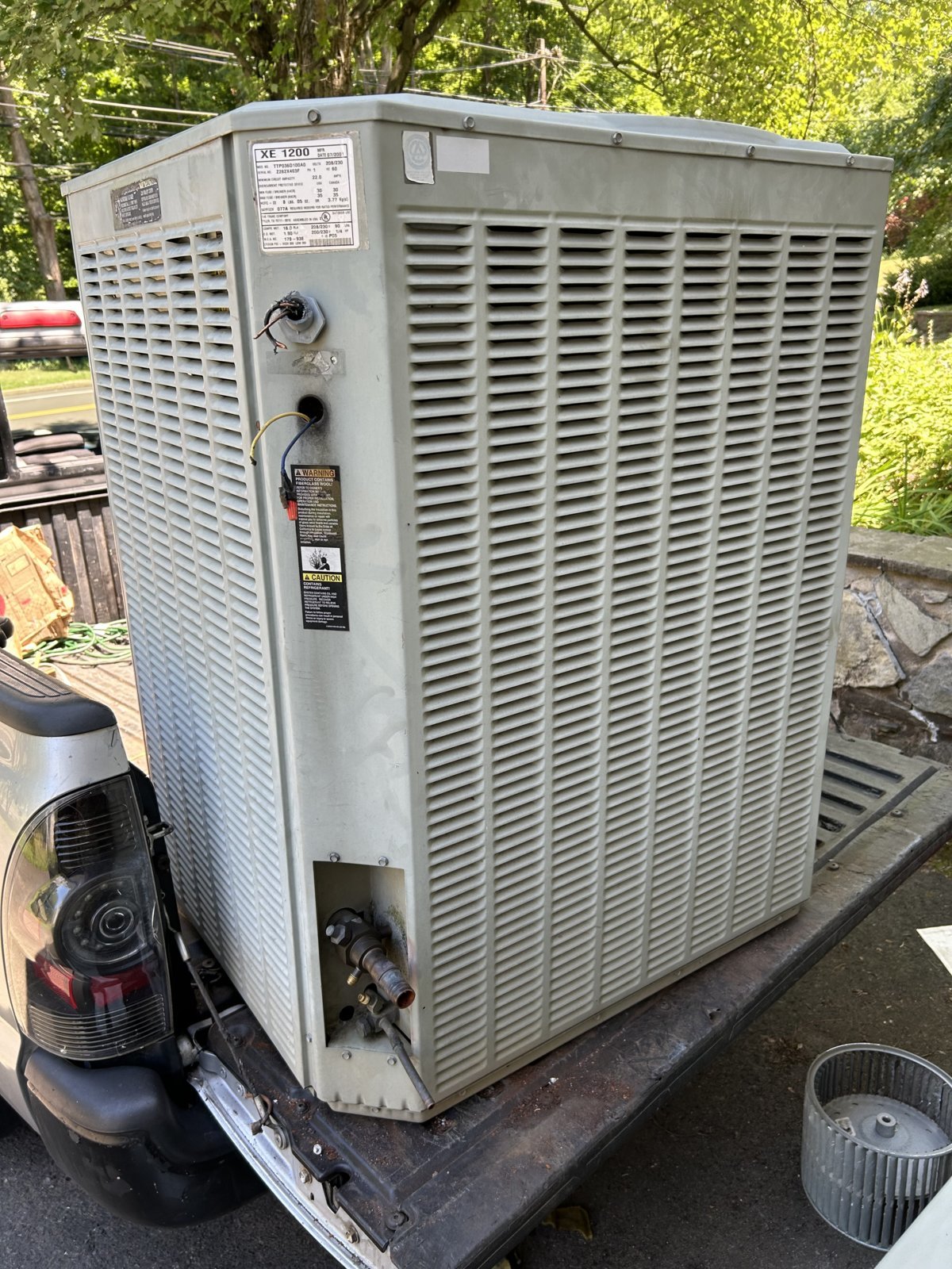

    The Trane worked at the time it was taken out of service, but it would not hold a charge of R-22 for more than a week. It just suddenly developed a leak during the recent heat wave and the HVAC charged it to see if it would last, but it didn’t. The Trane has been replaced by a Rheem…

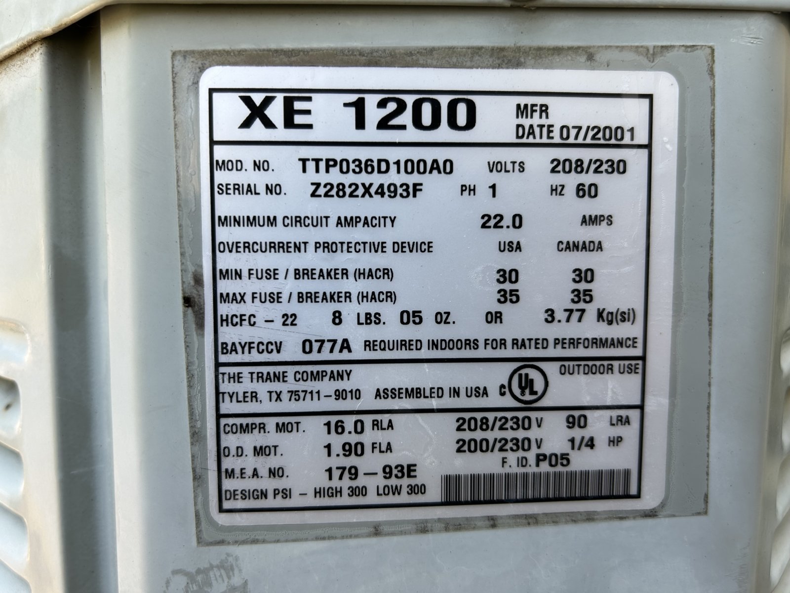

    @TnShooter
    This unit is easily identified as a 3-ton (36,000 BTU) by the “36” in the model number. Many HVAC manufacturers put the week and year of manufacture in the serial number (like Carrier/Bryant, Lennox, and Goodman for example), but Trane and American Standard actually have the month and year of manufacture clearly printed…

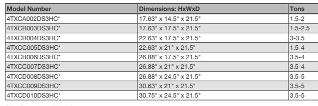

    More surface area typically on the higher efficiency stuff, but other things go into it.
    As for the coil, Trane has many different sized coils like everyone else. You can get a 3.5t coil anywhere from 22" tall to over 30" tall as example. A 2t coil can range from 17.6"H to 27" H. Widths vary as well of course, although Trane is typically "B","C" and "D" width now. "A" width are all but gone from their lineup unfortunately.
    Here is a shot from my price book showing the various sizes of coils that have the same capacity. This is just one model of coil, Trane has several others as well.
    Honestly, it really boils down to available instal space and availability of coil at distributor. As long as they match up of course. I generally try to install whatever makes the job smoother if I am honest.

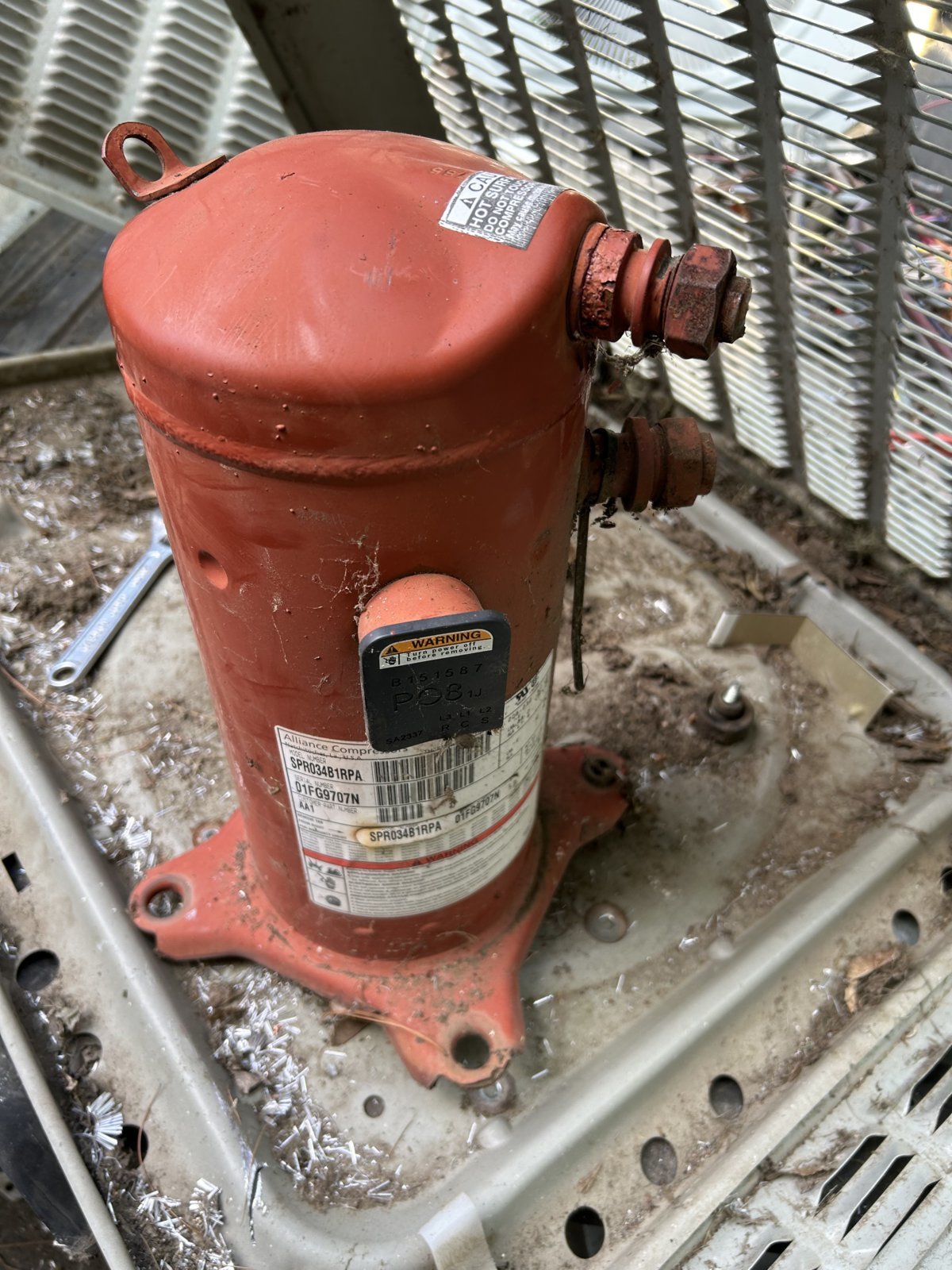

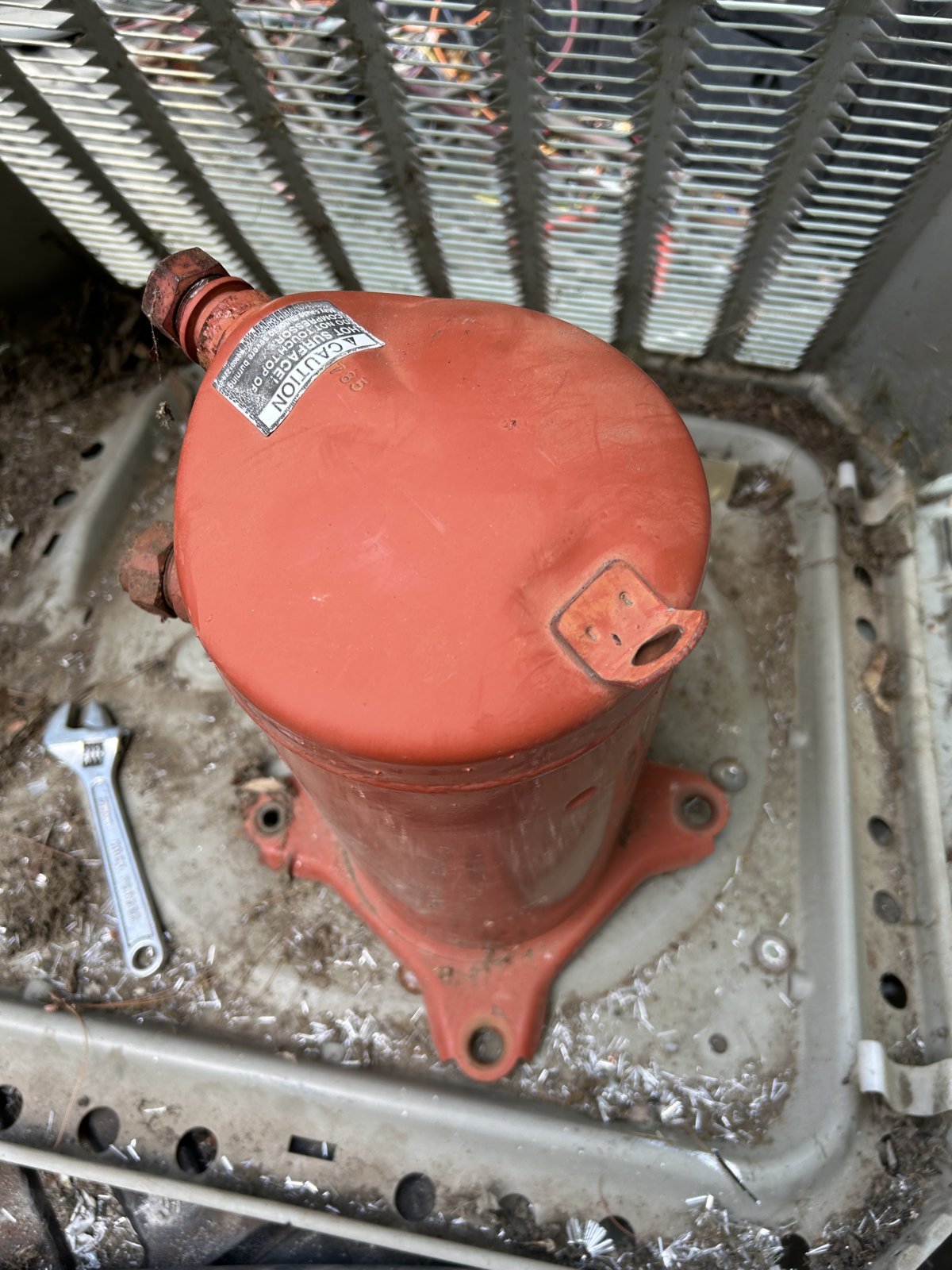

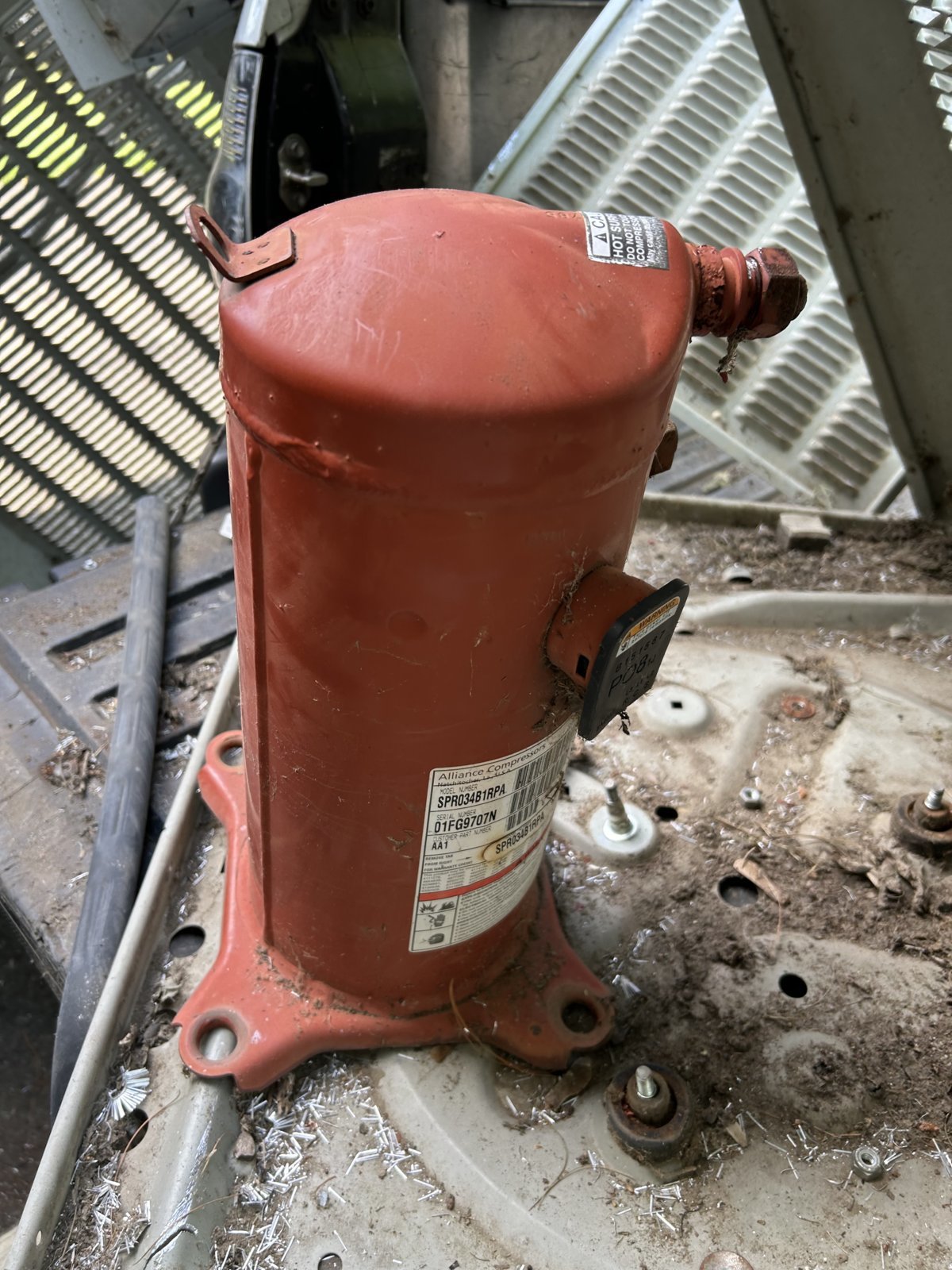

    @Lt. Dangle
    Alliance scroll compressor, in classic Trane red…
    Lt. Dangle likes this.

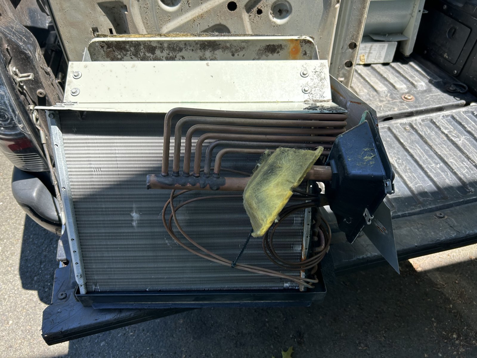

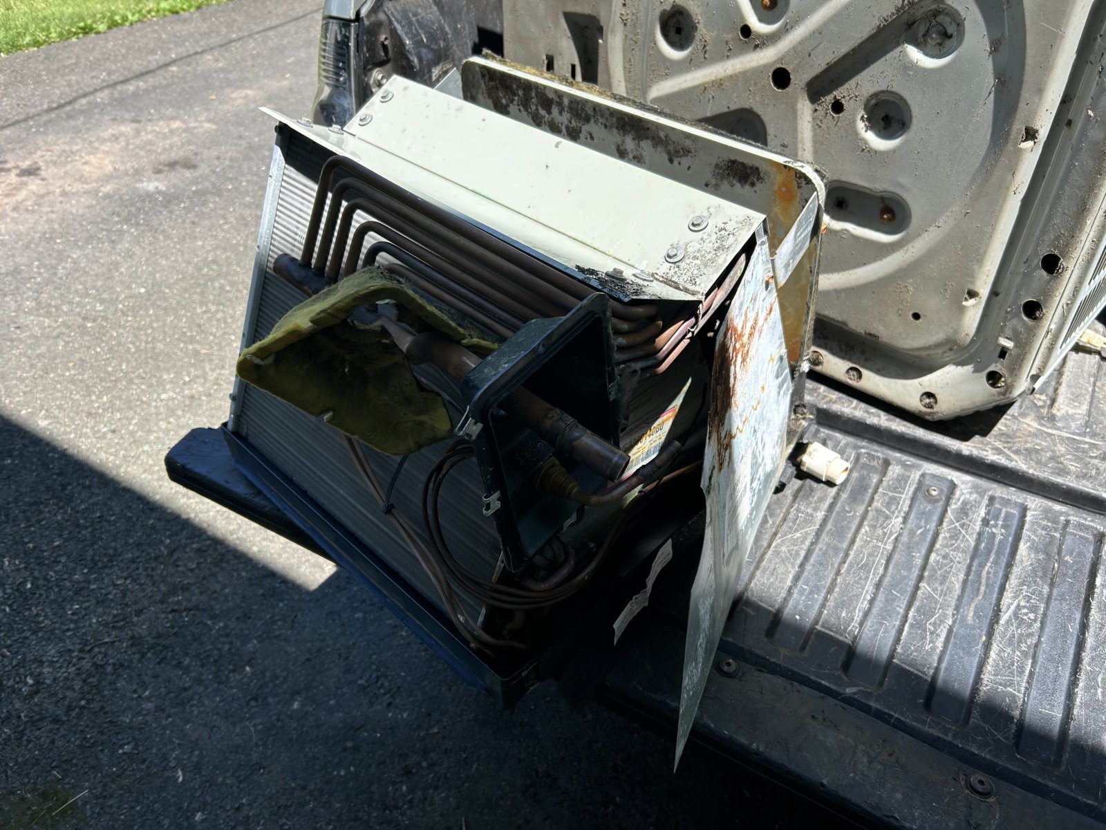

    @Lt. Dangle
    I scored what I believe to be the remains of a rooftop heat pump from an RV on my way to work the other day. The compressor seen in the pictures here is an AE compressor from a 1978 JCPenney-branded Gibson window A/C…

    @Lt. Dangle
    Obvious clue that it was a heat pump…
