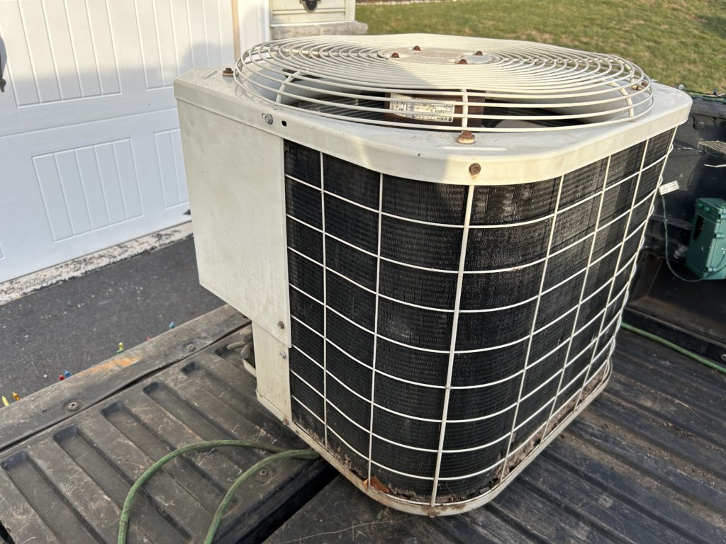

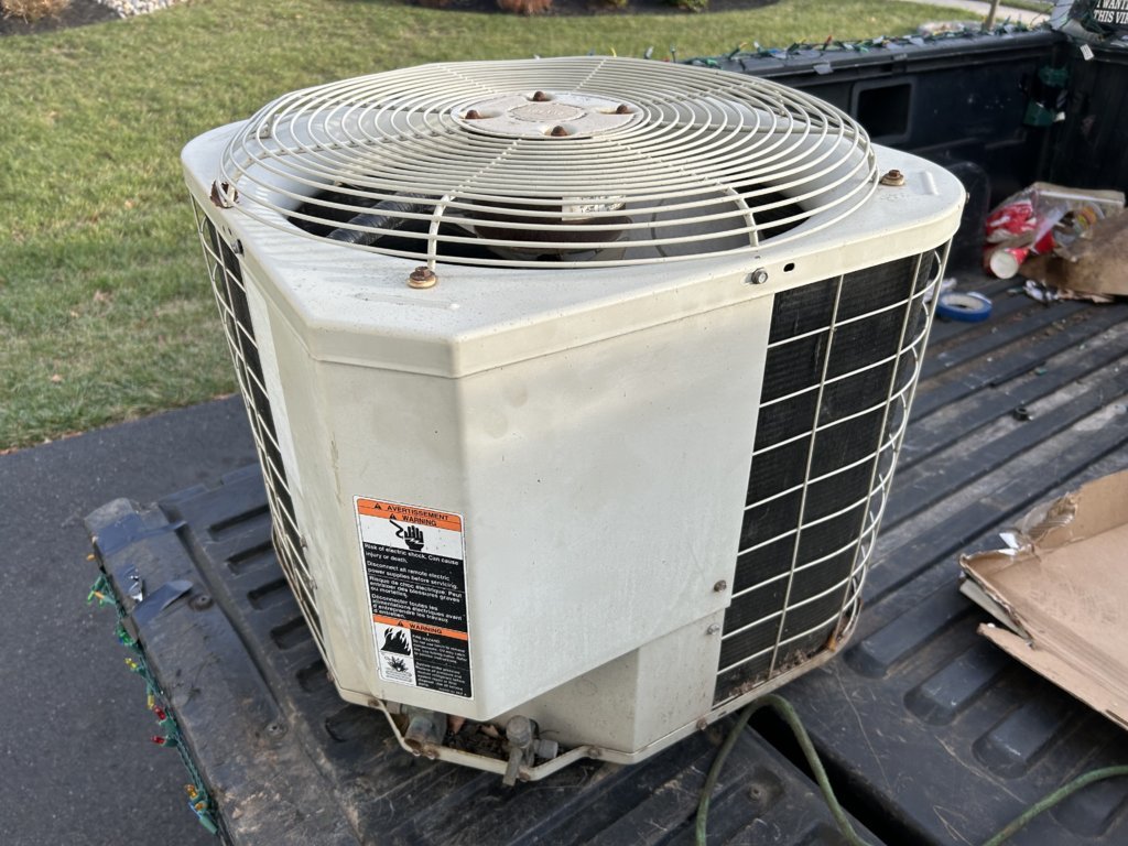

    The data sheet on the Bryant was very faded, but I was still able to get the size and manufacture date off of it; 2.5-ton unit manufactured in the 4th week of 1999!

    Almost 26 years ain’t bad for a residential unit from the late 1990s; it also had shockingly little rust for such an old unit in PA!

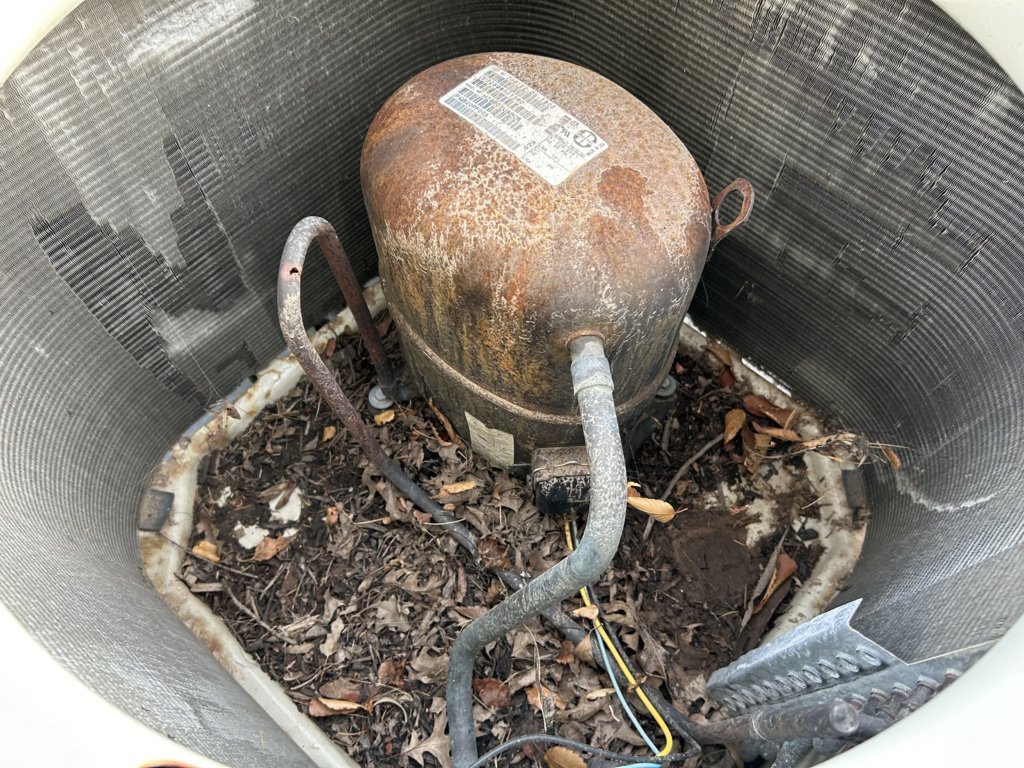

    The ‘99 Bryant had a Bristol reciprocating compressor in it, and if I had to guess, I’d say the reason they replaced this unit is because the compressor failed. The unit had no R-22 in it either, which is a clue that it was nonoperational when it was removed. The last two central air-conditioners that I scrapped were both fully operational, and had been replaced simply because the previous owner wanted something more efficient…

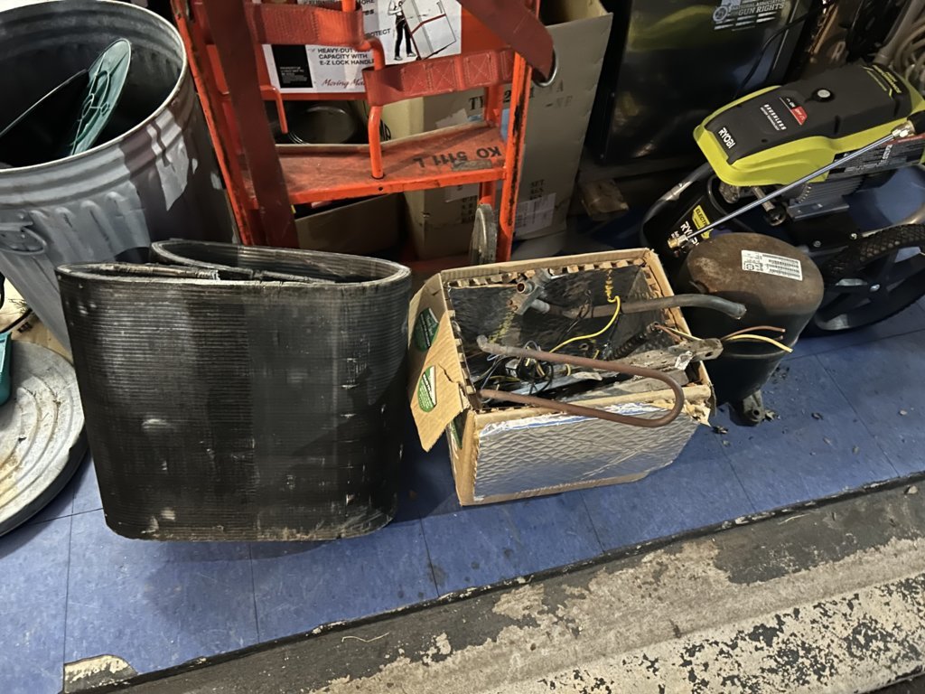

    The scrapyard is closed tomorrow, for obvious reasons, as well as Friday; I don’t want some asshole to steal all the valuable bits, so I am stashing them in the garage until I can scrap them. Yes, @Lt. Dangle , I folded the condenser down again like you recommended!

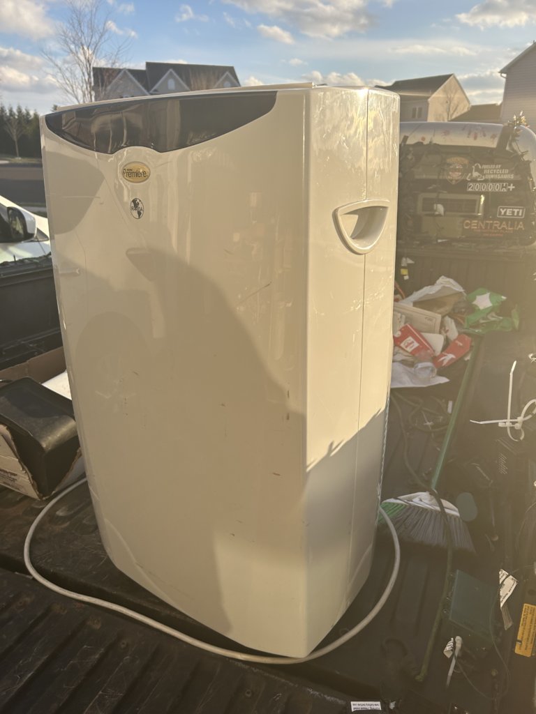

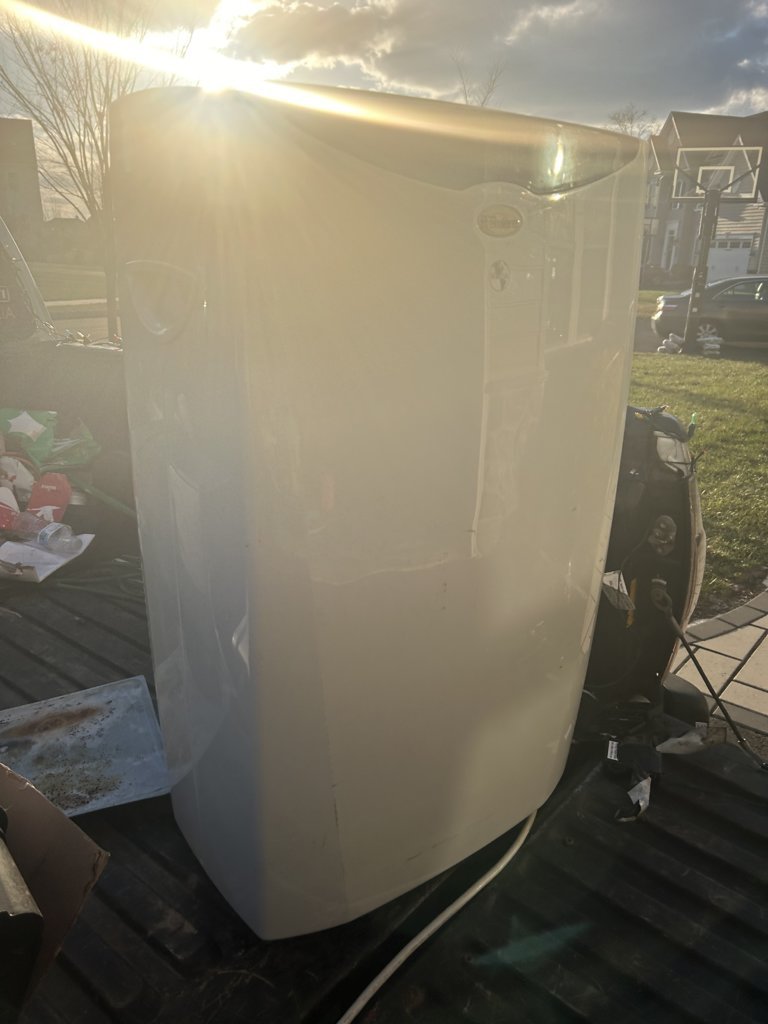

    I scored a Danby portable A/C with bad blower motors for free on Facebook marketplace yesterday…

    And I reduced it to a pile of valuable scrap in record time!

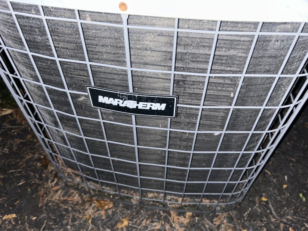

    Remember the old Maratherm heat pump and Bryant air handler at Emily’s apartment that still worked but had to be replaced due to a black mold infestation? Well, this is the replacement…

    The data sheet was worn off the Maratherm, but whoever did the install got a serial number form elsewhere and determined that the unit was about 24 years old. The Bryant air handler was an about two years newer, indicating that different components failed at different times. The shiny new Carrier heat pump is a 1.5-ton (18,000 BTU), which in this area is appropriately sized for a 2-bedroom/1-bathroom condo of less than a thousand square feet.

    Take a look at the 1999 Bryant 2.5-ton A/C that I scrapped last week; the Bryant was a straight-cool unit and the Carrier is a heat pump, and I have no idea if being a heat pump means a larger coil by default, but look how much smaller the Bryant is than the Carrier despite being a full nominal ton larger than the Carrier in cooling capacity! Also, the Carrier is probably about a 15 SEER while the Bryant is likely a 10 SEER, and I’ve noticed that higher efficiency units have larger condenser coils; I don’t seem to have noticed a huge difference in size between straight-cool units and heat pumps of the same basic model (if any at all).

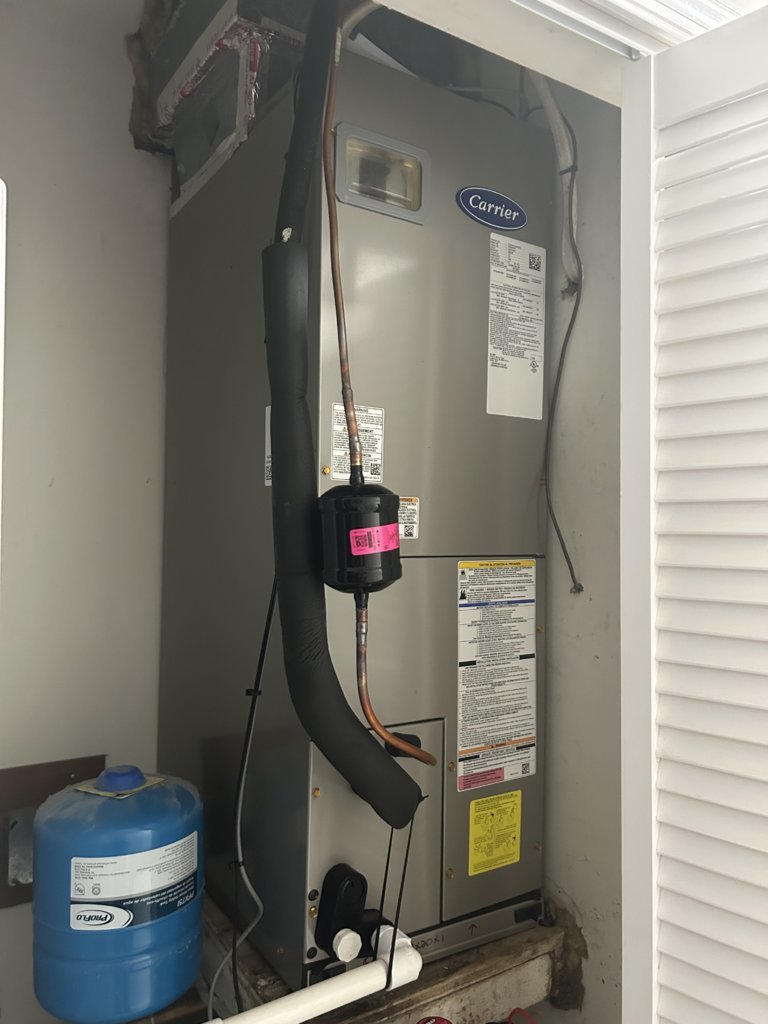

    Emily had to wait a few extra days for the new air handler, because “apartment size” air handlers are not very common anymore and harder to come by…
