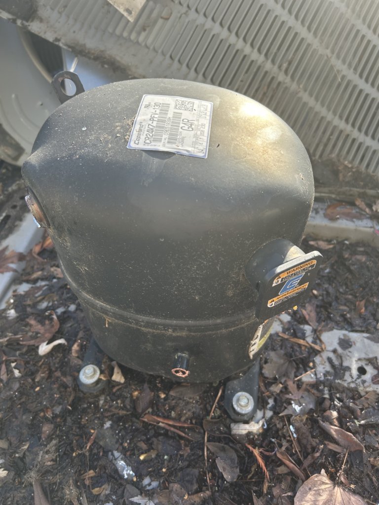

    Like the Goodman I tore apart a couple months ago, the Ducane had a Copeland reciprocating compressor…

    I have no idea why this unit would be replaced, but a dead compressor is a definite possibility…

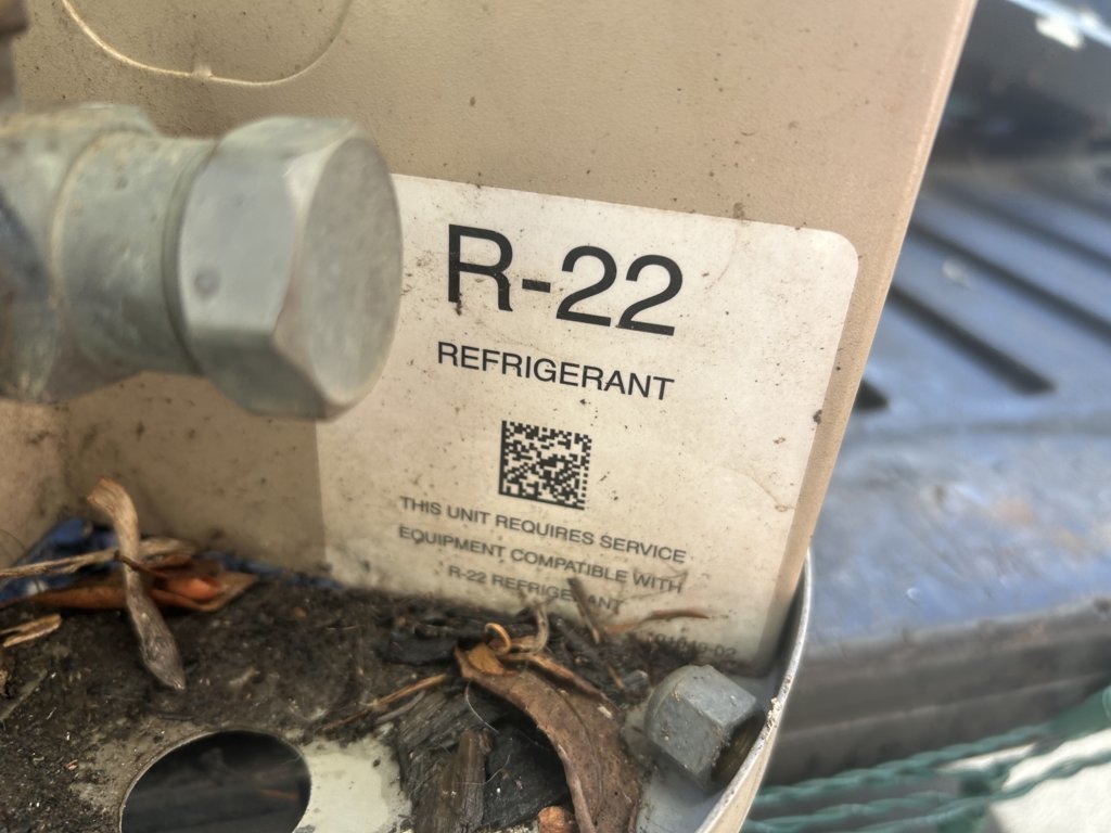

    2009 was the finally year before the government basically outlawed R-22…

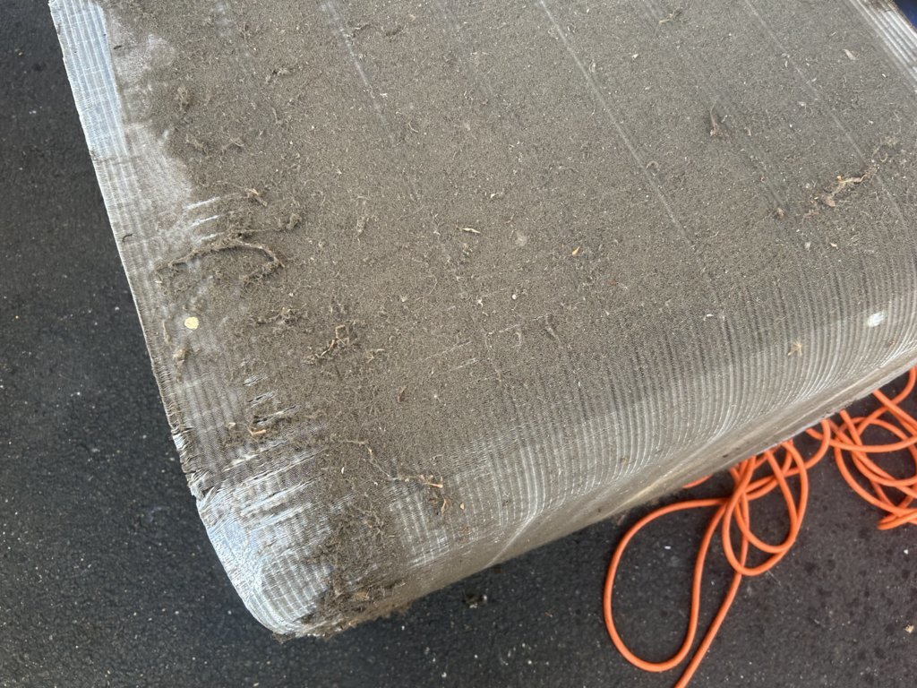

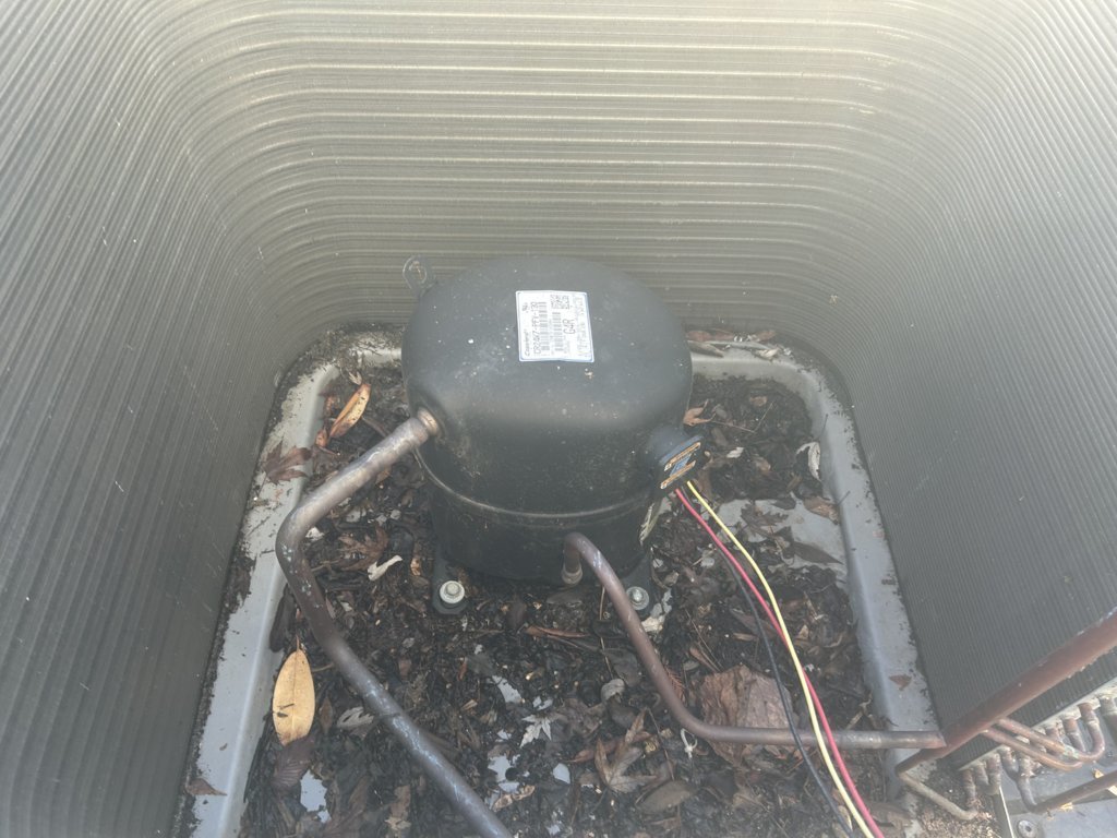

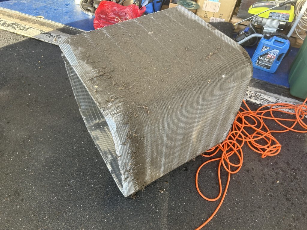

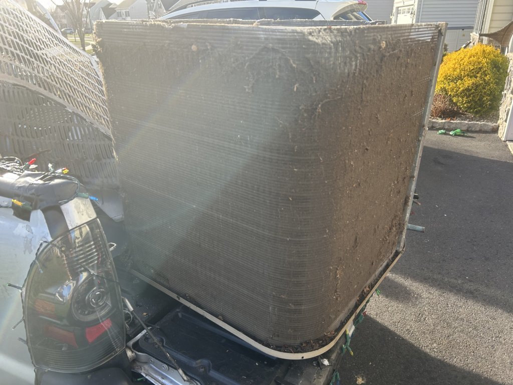

    Another definite possibility was a drop in cooling performance masquerading as a dying unit, but actually caused by reduced airflow as a result of a dirty condenser; I NEVER let my condenser coils get this dirty!

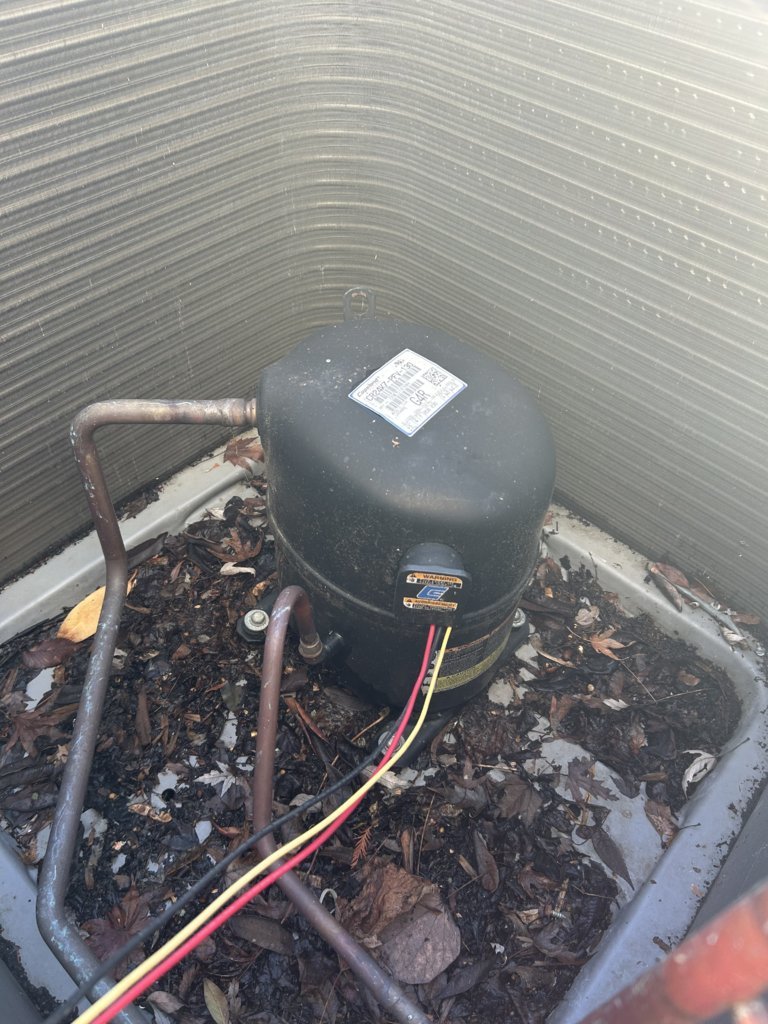

    :puke:

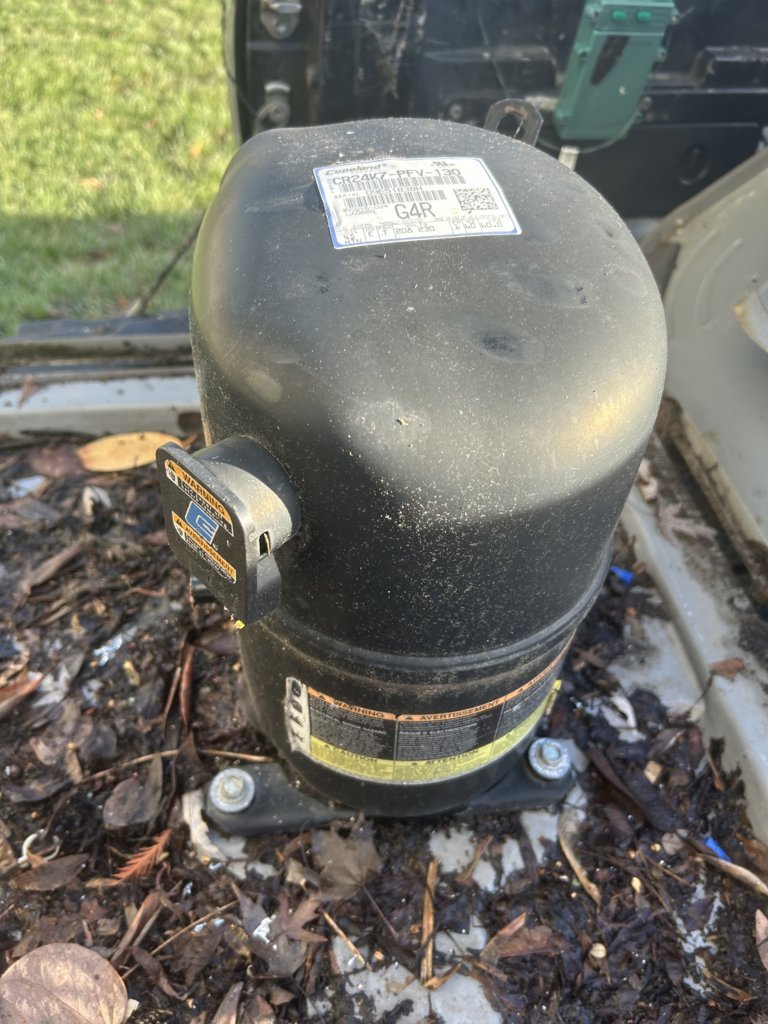

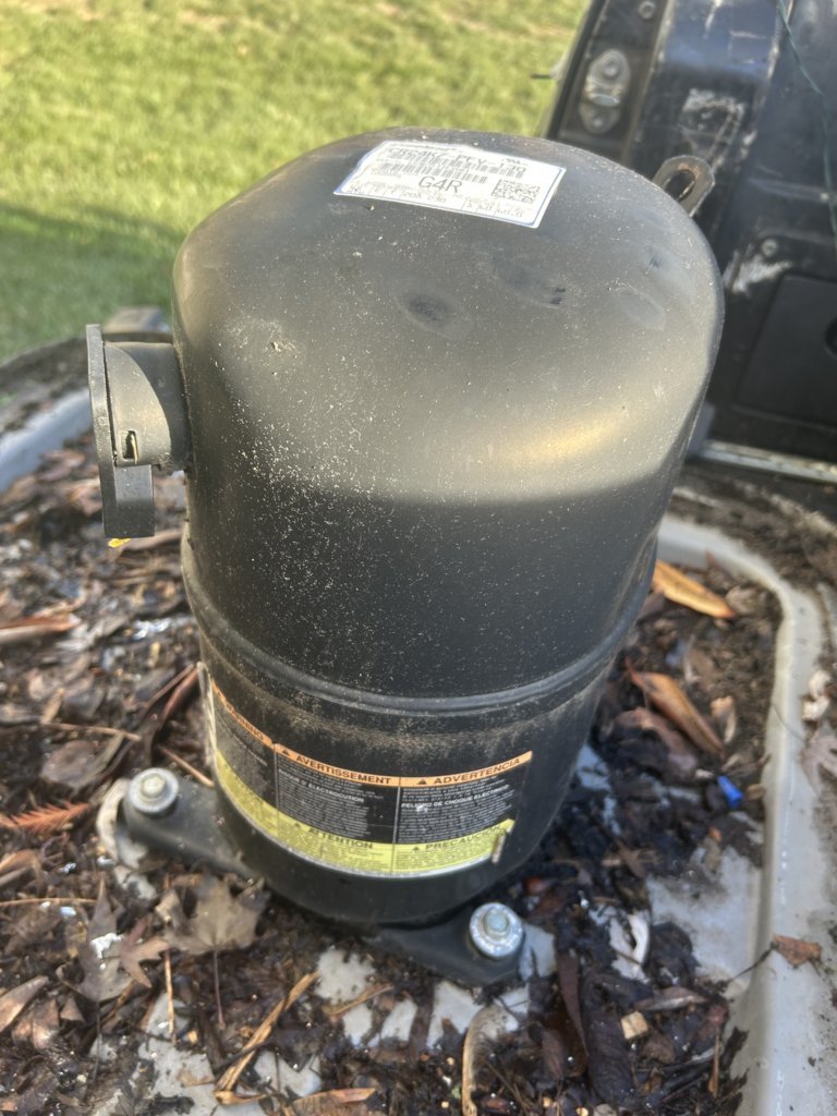

    I cannot think of any company besides Trane/American Standard that still uses recips…

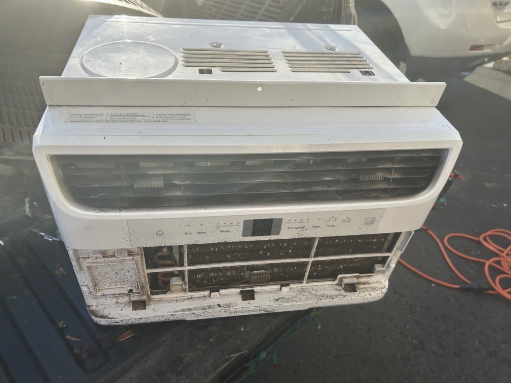

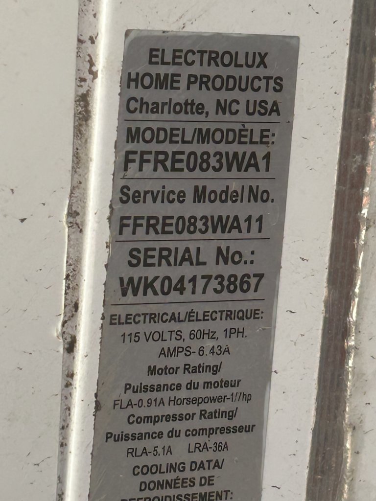

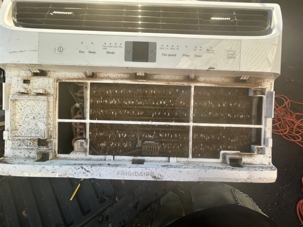

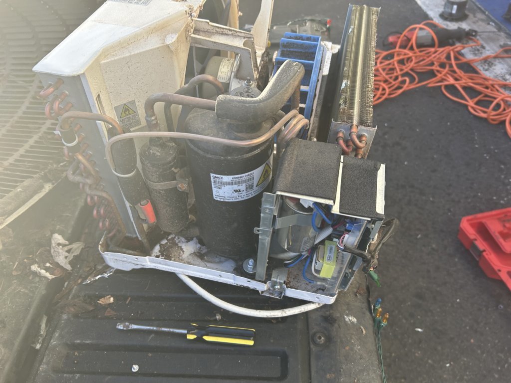

    The Frigidaire window unit was barely over four years old, but I could tell almost immediately why it was at the curb; I suspect it was being stored in a basement that flooded, and once I saw the inside, I have no regrets about disemboweling it and chopping it up….

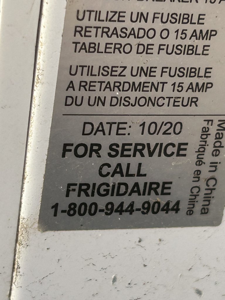

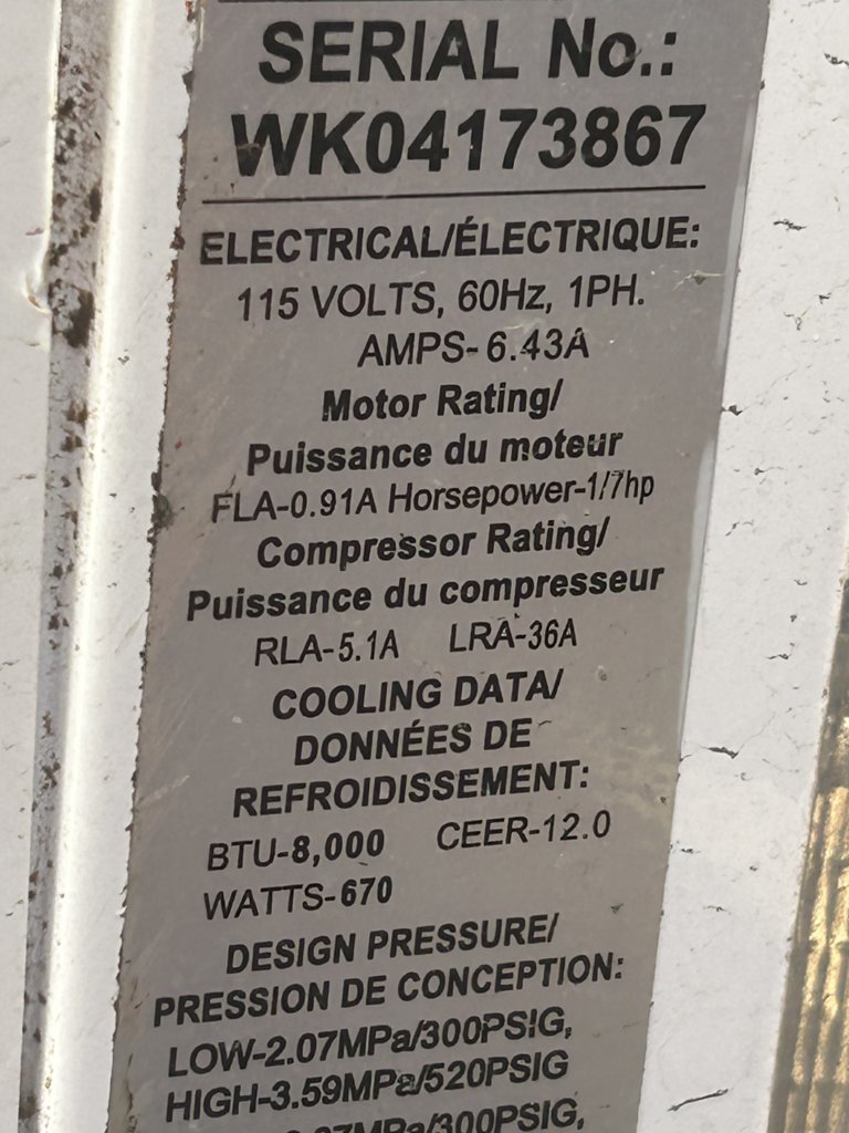

    Manufactured in October 2020…

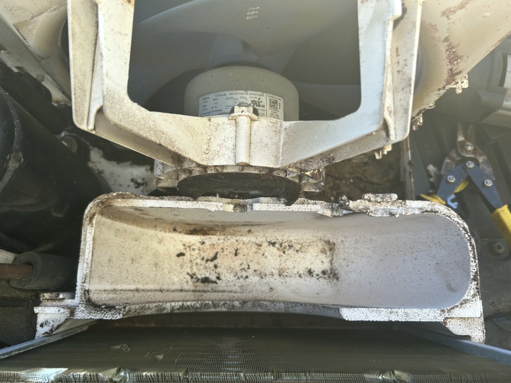

    99% sure that is mold in the indoor coil…

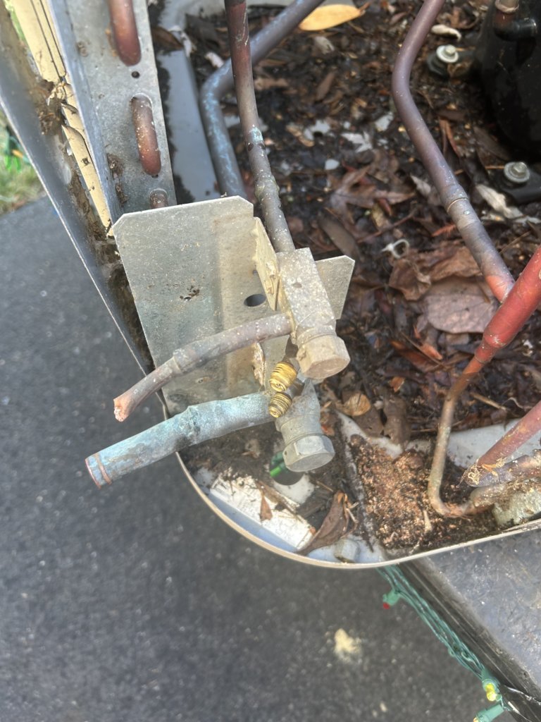

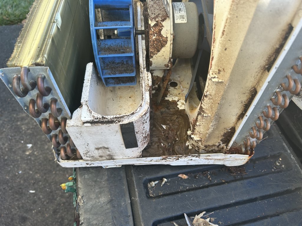

    This is what led me to believe that it was underwater; I didn’t even bother to plug in the unit to see if it powered on, and it’s probably just as well…
